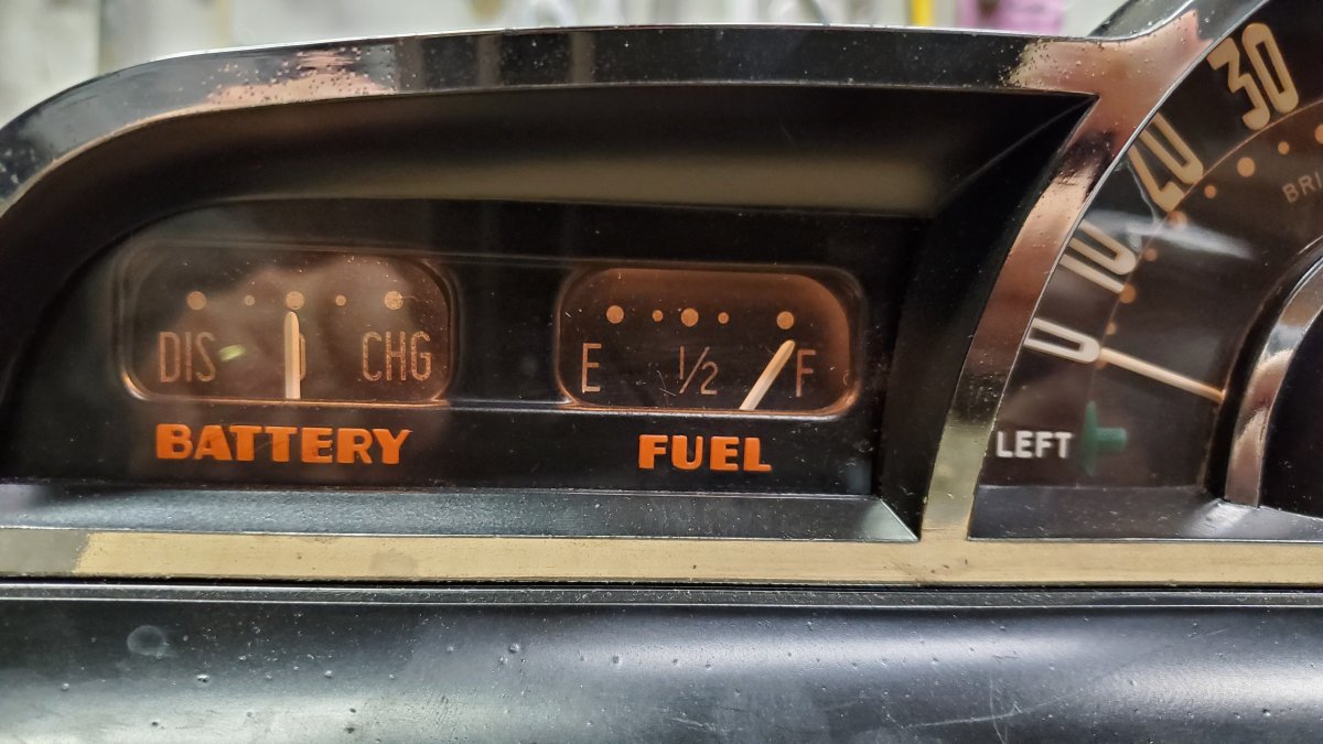

    Not much this week, but the replacement 6v converter arrived so it got wired in.
    Powered it up and instead of clouds of stinky smoke, I was rewarded with a gauge moving to full (normal behavior).
    Touched the gauge wire to ground and it dropped to E so it's all good. Going to put it all back in tomorrow hopefully.

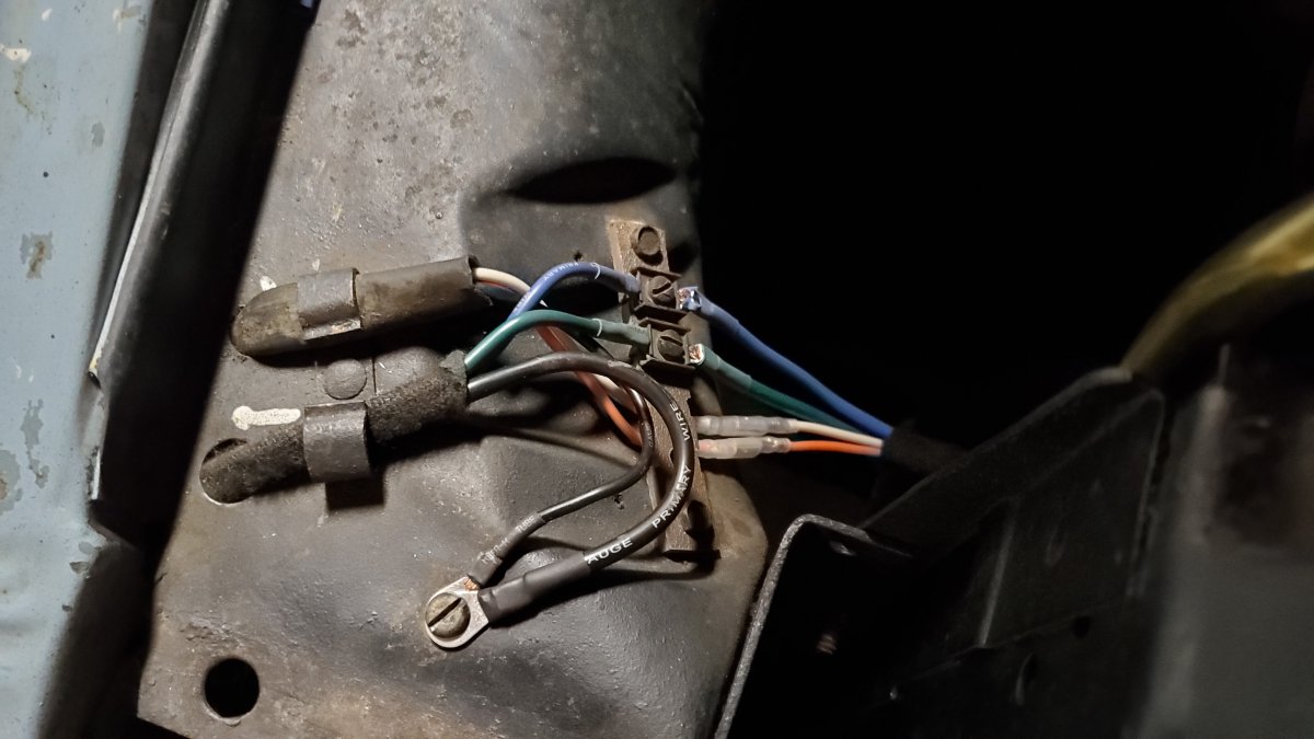

    Started on a little wiring, now have 2 parking lights and turn signals.
    Headlight wiring needs running, need to loom that up and then rewire the headlight connector.

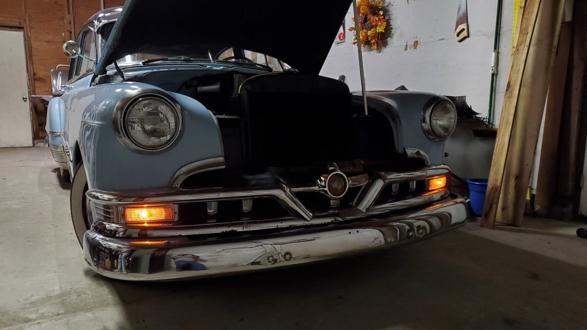

    Let there be light.
    Phil

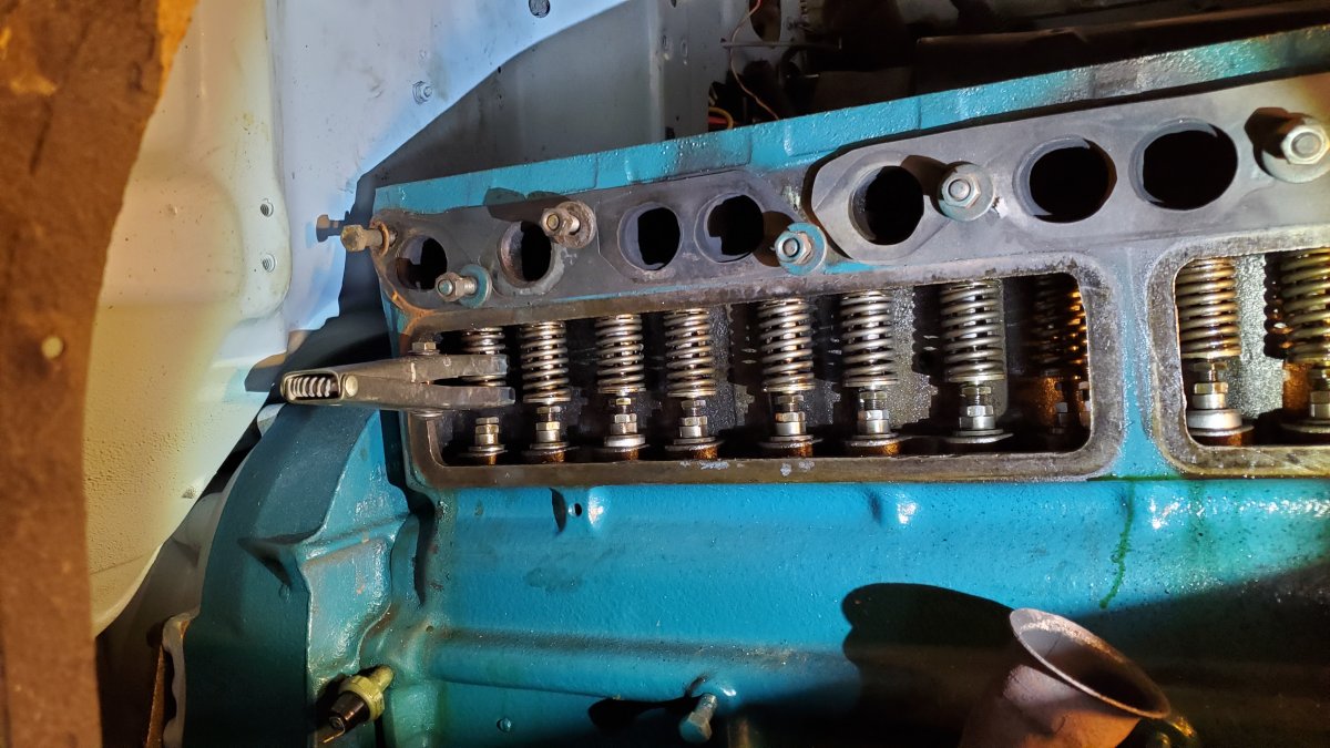

    Valve spring compressor is on its way doc, said it will be to you Thursday

    Thank you sir. I have a list of things to do on the car. Right now it's been 5 minutes here and there.
    All loomed up nice and tidy. Yup, that's 10ga wire for the headlights. I'm a firm believer in as few ohms between the battery and the bulb as possible.
    It makes the old Fed-spec bulbs actually passable- even better when the generator is putting out.
    High beam works on both at the same time too, which is better than one on high and one on dim as it was when I got the car. Also, before the rewire and switch cleaning the light output was positively orange. Now it's bright yellow-white as it should be.
    Phil

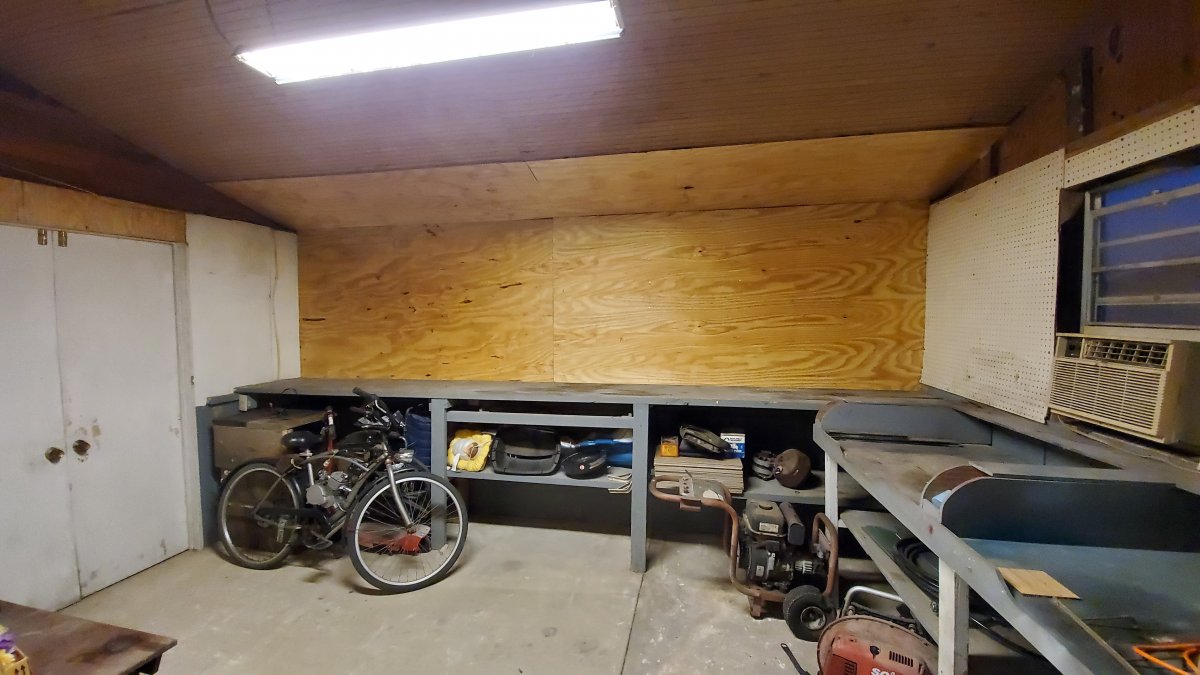

    1. Hydro Tech
    Been busy. Have sorted this space out now to be enclosed. Makes a nice little workshop now.
    Progress soon on the car, I promise.
    Phil

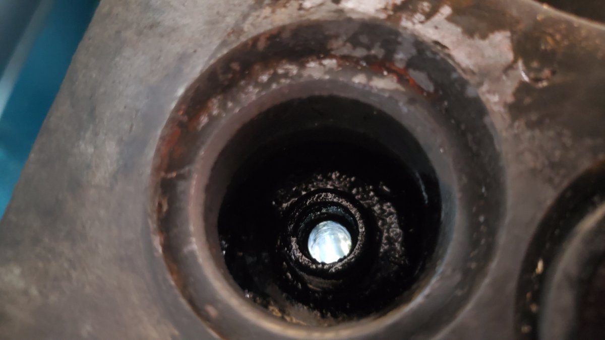

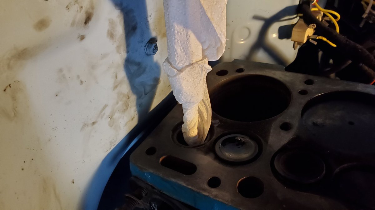

    1. Hydro Tech
    Had to modify the tool slightly but it holds nicely now.
    Damn valve took 40 minutes to coerce out of the guide.
    Checked and the valve is straight.
    Cleaned the guide
    All grubby but yuk. Valve now falls down happily under its own weight. Going to lap the seat in now.
    Phil

    Looking good brother, take a long bolt that'll reach through the guide loosely and cut a slice in the end of it so you can put a small piece of 320 or so sandpaper in it and turn it by hand.

    Didn't even need that! Just a bit of carb cleaner on a twisted up piece of cloth.

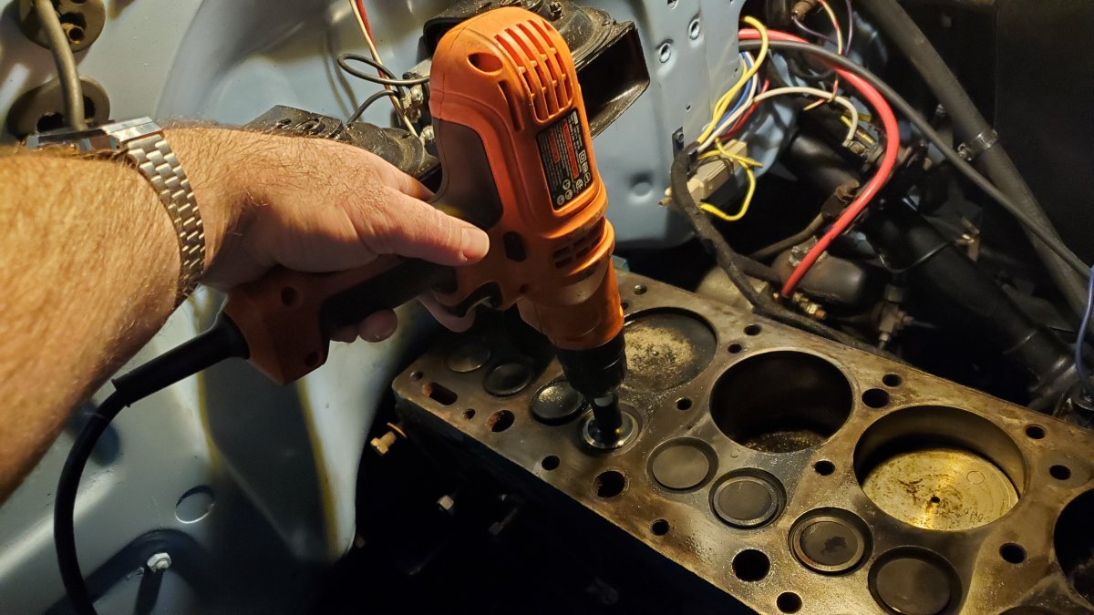

    The weather changed for the cooler- yesterday I ran out of time after work, today is probably going to be the same but I bought another suction-cup valve tool.
    Nowhere locally sells the little suction cups that fit to a twist drill- a few of the valves don't seal well at all and require a fairly heavy lap. They're not bent, they just aren't very even.
    I felt like I was dying of old age doing it by hand so I'm going to cheat to get the baseline grind done with my drill on the worst ones and finish up by hand. So, I think I'm going to modify this tool to fit my drill. Yes, I know it's not the proper way of doing it but I've done enough that I know not to go all gung-ho...

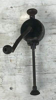

    Dad taught us how to use this a long time ago, saves the old feeling! Are they even made today? s-l400.jpeg

    I have no idea but that's what I'm going for, just using my electric drill. It is fully speed adjustable on the trigger so I can go as slow as I need to, back and forth.

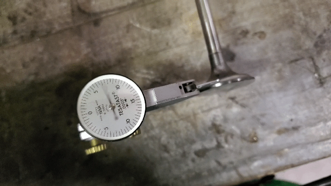

    So, I bought a new valve sucker cup stick tool.
    Stripped it down and adapted it to my drill.
    Spun it round a bit and didn't really see an improvement in the way it was sealing.
    Saw the lip it was creating in the valve. Nah, that ain't right.

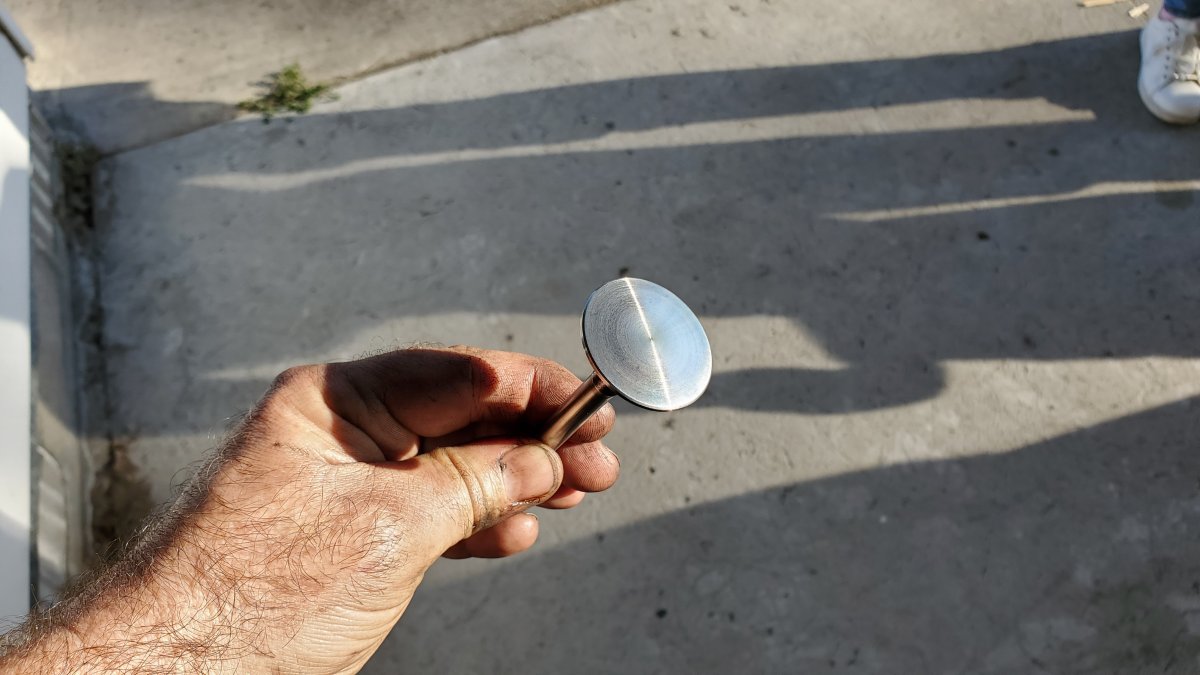

    Nope.. Sure as hell ain't right. The stem is straight but the head of the valve is bent. You can see it visibly in that animation, even without the dial gauge. Granted, the stem has about 0.08 runout because the chuck doesn't hold it 100% central, but eesh.
    New valve time. I'm going to pull the rest out and check them and order replacements as necessary.
    Phil

    If I was there to help, I'd take those 16 valves down to the machine shop along with the springs. I'd reface the valves & test the spring pressure on the old Rimac tester, throw a straight edge on top of the springs to see if they're close to being equal in height, and buy enough V.S.I. shims to bring them up to the required pressure. Pressure can be tested at home using bathroom scales - will someone please help pull up the procedure for us ?
