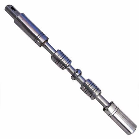

    Took it for a run. Result? Much improved; light throttle and acceleration it still hangs up a little.
    I think the chamfer needs to be made a little softer, polished. At light throttle it seems as though there's only ounces of force available.
    Put my foot down a little heavier and it shifts just fine. Happy with that overall.
    Phil

    1. Hydro Tech
    I hope so. Never would have thought it was a valve getting stuck halfway.

    1. Hydro Tech
    It would, but that also defeats the object of having the main line pressure reduction in the first place. Taking the edge off that piston so it moves correctly is a better solution in my opinion because it retains the low pressure at light acceleration and thus prevents the shifts from being harsh.

    1. Hydro Tech
    Rolled over 115000 miles today. Did a couple moderate distance, high speed runs and although it did hang up a couple times now, every time snapping the throttle shut causes a 1-2 shift so it's just getting stuck on the edge again but now will free up easily.
    I'll pull the valve block at some point and machine it more.
    It's made it a lot easier to drive, without having to worry about it not shifting before the engine throws a rod.
    Phil
  11. Pontmerc
    Joined: Jul 13, 2013
    Posts: 437
    Pontmerc
    from Finland
    You got spare valve body right?
    Take that valve spool out and cut grooves all the way about 3mm space between.
    That will center the spool as oil is not force it to one side. upload_2023-12-7_11-15-26.png upload_2023-12-7_11-15-26.png

    1. Hydro Tech
    I do, but I'm not sure that'll work because it's not a very long piece. I do have a spare though.
    It's not the hydraulic pressure making it go to the side though, it's the spring.

    1. Hydro Tech
    Jumped at a rare opportunity, NOS valve block. Gives me a chance to see if machining a sleeve for the old ones is viable.
    Phil

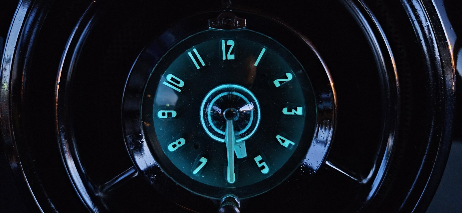

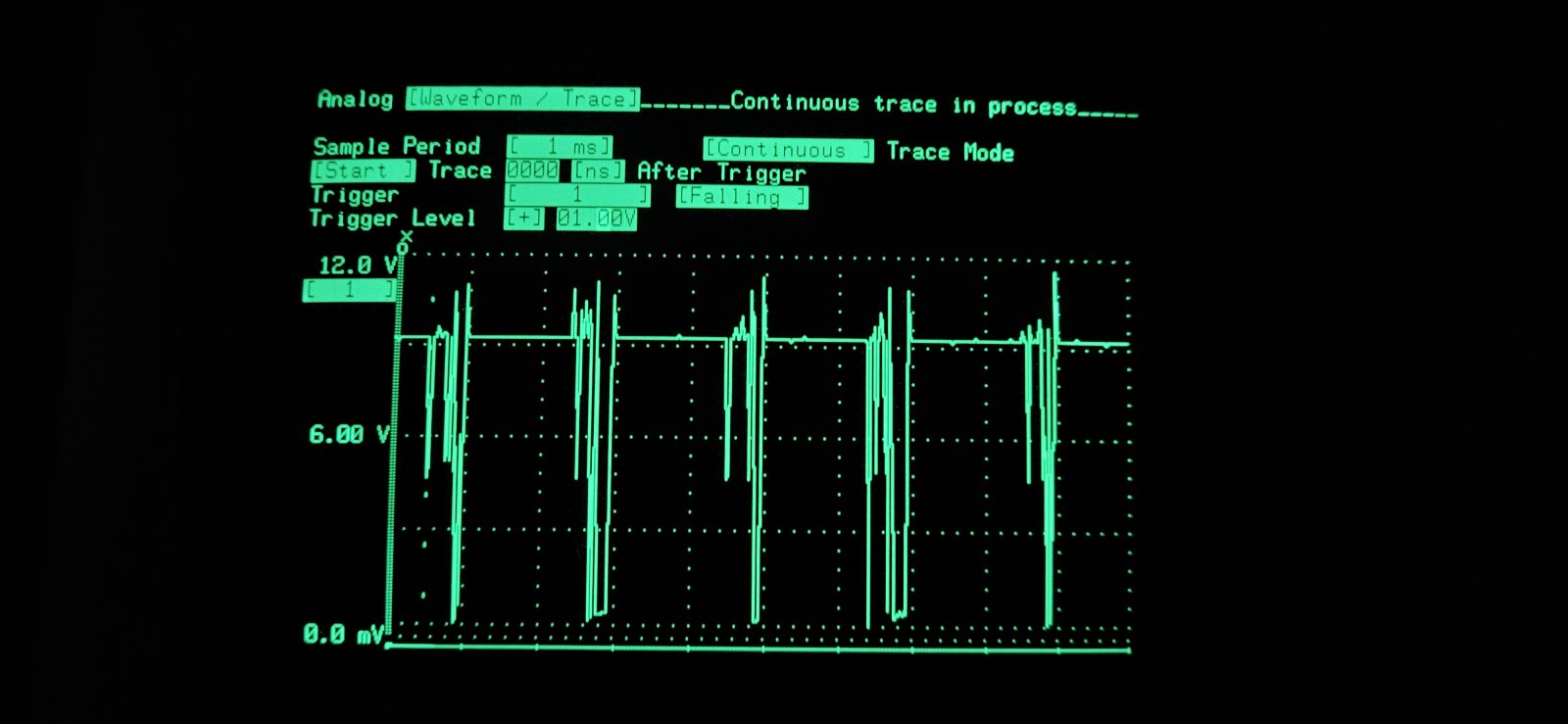

    1. Hydro Tech
    Took the clock out because it had been losing time. It's been a few years since it was serviced last.
    Stuck it on my bench and pulled it apart. Oiled the pinions and set about adjusting the hairspring balance.
    Yup, I set my clock up with an oscilloscope. Nice even pulses there so that's good.
    Ticking over smoothly again.
    All back together, tested and ready to go back into the car.
    Phil

  25. PhilA
    Joined: Sep 6, 2018
    Posts: 2,104
    PhilA
    1. Hydro Tech
    Been sitting listening to it back in the car.
    Doesn't seem to be catching the escapement any more (audible click) so that should be back keeping time properly again now.
    Phil

  28. PhilA
    Joined: Sep 6, 2018
    Posts: 2,104
    PhilA
    1. Hydro Tech
    It gained about two minutes overnight so that's a good sign.
    Need to go bring a small screwdriver out and dial it a touch towards S.
    Phil

  29. Oneball
    Joined: Jul 30, 2023
    Posts: 1,492
    Oneball
    I can’t remember, did you have to repair your clock in the first place or did it just need cleaning?
  30. PhilA
    Joined: Sep 6, 2018
    Posts: 2,104
    PhilA
    1. Hydro Tech
    It needed a thorough clean, adjustment and conversion to 12V.
    Phil
