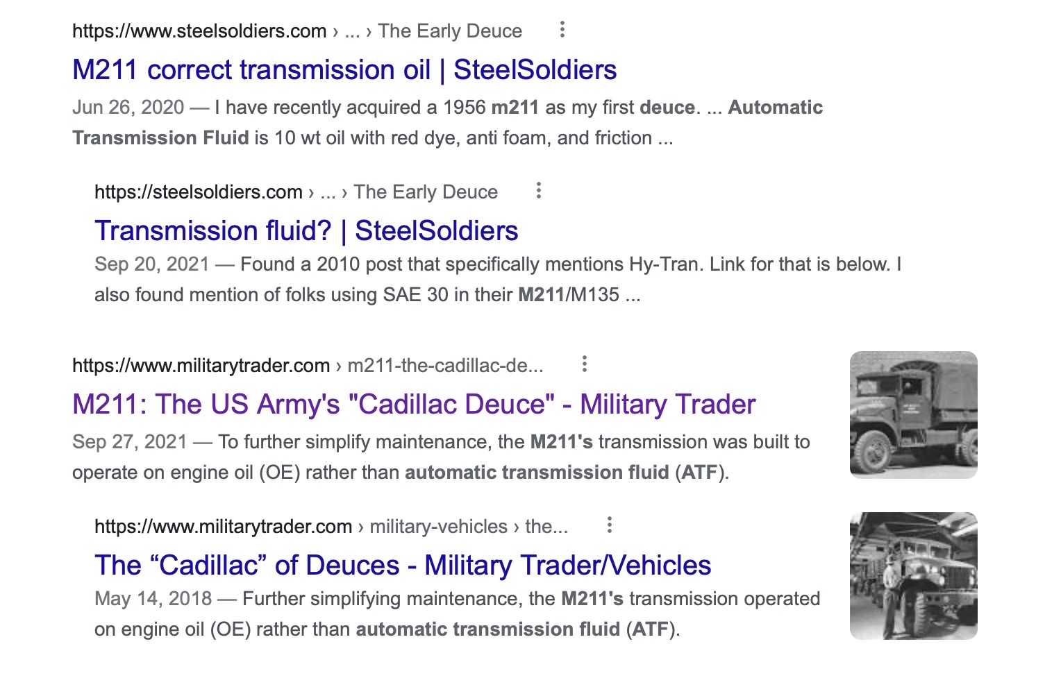

  27. 1-SHOT
    Joined: Sep 23, 2014
    Posts: 2,702
    1-SHOT
    from Denton
    Image 1-22-23 at 7.21 PM.jpeg In the Military M-211 GMC 2&1/2 trucks with Hydromatic they used 30 weight non-detergent motor oil you may want to google it and see for your self.
    chryslerfan55 and PhilA like this.
  28. PhilA
    Joined: Sep 6, 2018
    Posts: 2,066
    PhilA
    1. Hydro Tech
    I was going by the manual I have; it quotes that if you run low, top up with high quality 20W engine oil and then flush and refill with the correct type once you've reached destination.
    I could see 30W engine oil working though.
    chryslerfan55 and bchctybob like this.
