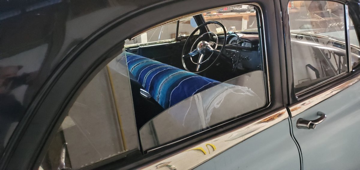

    In lieu of anything else, I gave the side glasses a deep clean. They come up respectably. If you can't fix it, clean it, right?

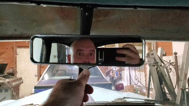

    Subject: Front driver's side windshield. Arguably the most important pane of glass on the car, and one of the least clean.
    After a deep cleaning, significantly better.
    From inside the car, the difference is clear to see.
    Next up, the rear view mirror. It was stuck in the night-time position. Pulling it forward would result in it snapping back again as soon as you let go. Loosened the thing off and undid it from the pillar.
    Screwdriver to gently prise it open.
    Mirror glass cleaned, finger tab cleaned (yuk) and adjusted because over time the little arms that hold it snug to the glass had become very slack, and it was able to move in relation to the mirror, so the spring would never fall over-center and lock in place.
    Attempted to clean the case, gave up and threw it in the dishwasher because it needs to be nice and hot to clean up, hotter than I fancied getting my hands under the faucet. That'll be ready tomorrow. I'll give it a coat of wax because the chrome is beginning to get all pitted, which should slow that degradation down. It'll also look nicer in through the windshield, clean...

    Went to Tractor Supply. Big jug of 30 weight diesel oil, antifreeze and some brake fluid and brake cleaner purchased.
    Today was "it's easier to ask forgiveness than permission".
    I did however finish cleaning the glass this afternoon. The haze around the bottom edge is where the glass is beginning to delaminate.
