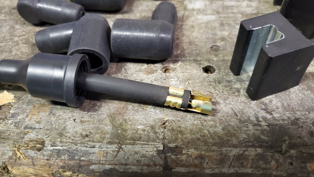

    Hm. The picture had the wires as plain black, but these ones have words all over them. They also said USA Made by MSD, the box is printed Made In Mexico.
    I can't win.
    I know they're rubberized, but if I were to put old style Bakelite or phenolic resin connectors the moisture in the air here (you ain't had humid until you've had down the bayou humid) cause the spark to track over wherever it can and make the engine throughly unreliable. I'll concede to this because it helps.

    Can you use a mild solvent to remove the printed lettering?

    Probably, it looks like it should come off.
    Phil
    Edit:. Pencil eraser works nicely.

    white spirit in a soft cloth removed the writing from my msd leads.love the build bud

    I think I may take this option. I was wanting to avoid putting any solvents or chemicals onto the wires but it's taking forever.

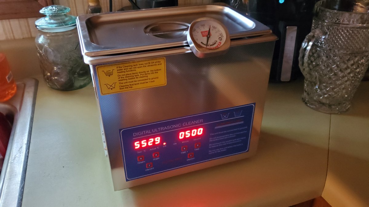

    Bought my birthday gift. I shall say that one of these should be in everybody's toolbox. An incredibly useful tool, ultrasonic cleaning bath.

    1. Hydro Tech
    This one is very Made In China but it's screwed together okay and works well. $67 delivered so if it breaks, it's not horrible.
    The next size up about 90-120 bucks.
    This one is about your fingers-length deep, two by one handspans. Big enough to put basic, broken down stuff into. Noisy though, this one is going to live in the garage.
    Phil

  16. KandN Kustoms
    Joined: Dec 15, 2008
    Posts: 461
    KandN Kustoms
    Hey thanks !
    Was thinking about one to clean carbs.
    Probably have to be a little bigger than what you have though.
    Sent from my SM-G960U using The H.A.M.B. mobile app

    I just saw a good idea on the use of these, which I'm going to use. To save cleaning it each time, fill it up with water but put the item you want to clean in whatever solvent you want to use inside a plastic container and sit it in the water in the bath. Works well to transfer the energy (water being very good at that) and keeps the pan clean. Also means if you use gasoline etc it's all sealed while it's in use.

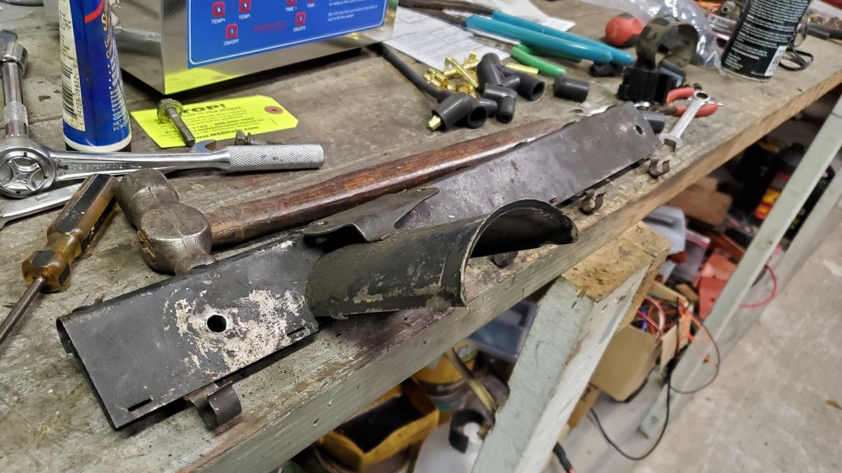

    Crimped up the king lead.
    Found a suitable solvent to remove the lettering.
    Removed the wire carrier and pulled all the wires out of it. The engine had fallen over in the care of the previous keeper when they were doing the engine work. It dented all the sheet metal up on this side of the engine. You can see the dents there to the right of the lead-out.
    I beat on it with hammers. Not perfect, but better. Unclipped the back of it. I need to make up the lower section of the lead-out, it's missing.
    That was therapeutic.
    Next up it needs a thorough clean.

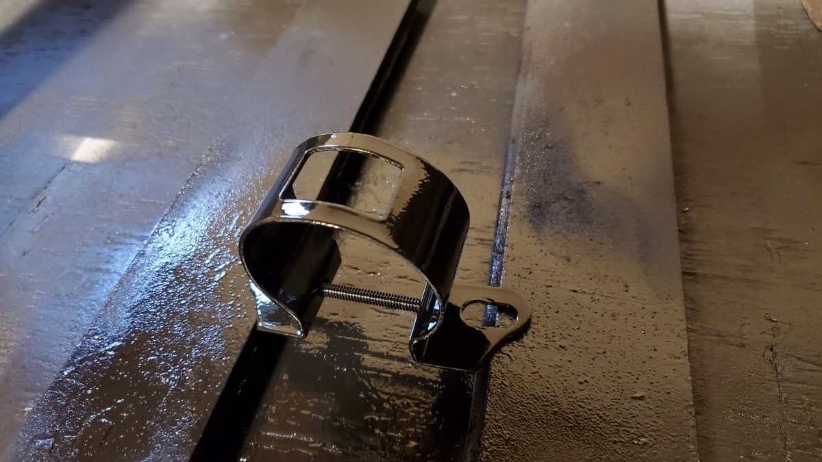

    Cleaned the coil clamp, found a screw that fit, painted.
    The rest is cleaning right now.

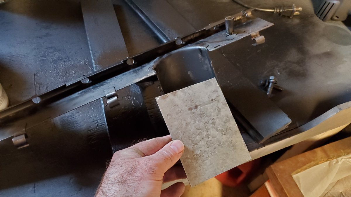

    Instead of that, I set about doing some metal work. Marked a sheet of steel out to size.
    Cut it out to size and de-burred the edges.
    Bend bend bend bash bash bash
    Tweak, shrink, fettle
    Squirt of black paint. That'll do.
    Phil
