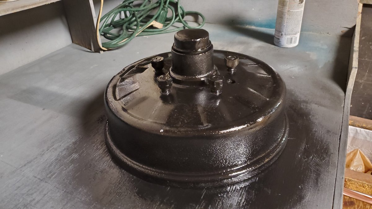

  8. manyolcars
    Joined: Mar 30, 2001
    Posts: 9,560
    manyolcars
    Its always tempting to make rusty brake drums look better by painting but paint is an insulator and rusty cast iron is very good at dissipating heat.

  10. PhilA
    Joined: Sep 6, 2018
    Posts: 2,104
    PhilA
    1. Hydro Tech
    It's not heat resistant. It'll burn off and go rusty soon enough. It's just made it a little nicer to handle in the interim.
