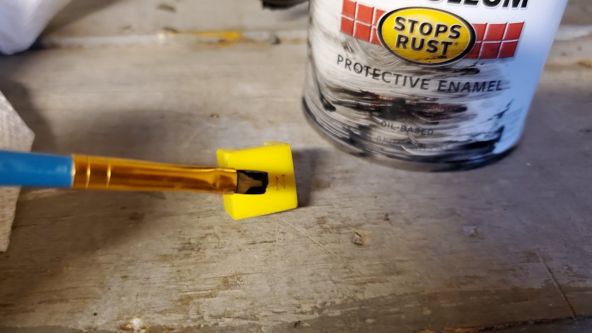

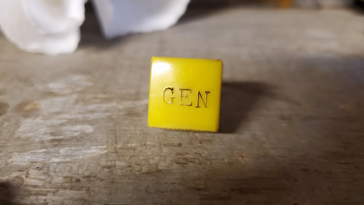

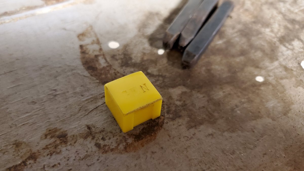

    Borrowed some letter punches to see if I could impress a legend to define what the light is for.
    Put some paint on the front- being polypropylene the paint wiped off but stuck in the punched letters.
    Uh, well. It's not easy to get the letters lined up. (Edit: Or even the right way up, just seen the N is upside-down!)
    Illuminated (with the camera shutter adjusted so the image wouldn't bleach out) the legend is legible but it looks a little too homebrew for me. I'm just going to do different colors and call it quits.

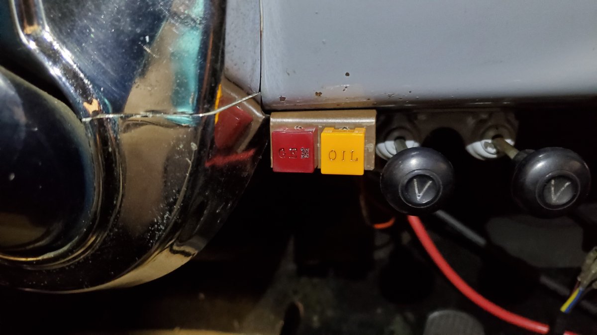

    1. Hydro Tech
    Maybe I'll keep the words. Maybe not. I'll see how it grows on me. At least they're really easy to change.
    Off, they're fairly inconspicuous.
    On, they're brought enough to be noticed. I've since swapped them round, red for generator (left) and orange for oil pressure (right) because the orange is more visible and that's the warning light I care more about.
    Phil

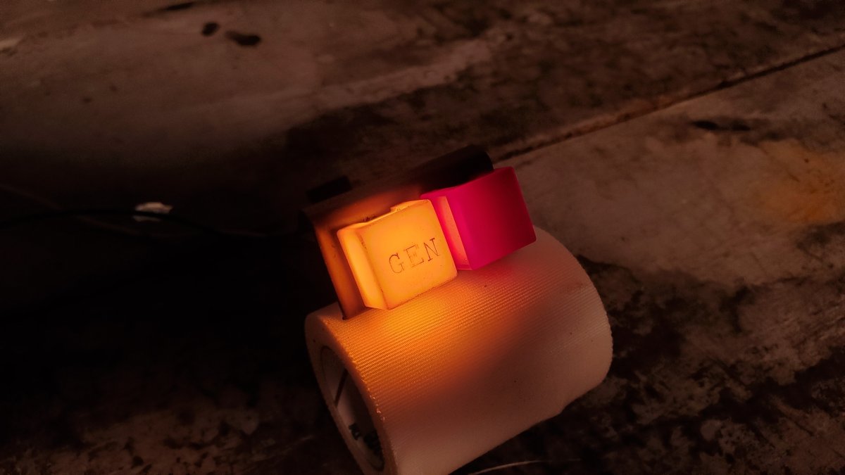

    1. Hydro Tech
    Off
    On. In reality they are red and orange not pink, my camera doesn't like the red very much and makes the color go all funny.
    Phil

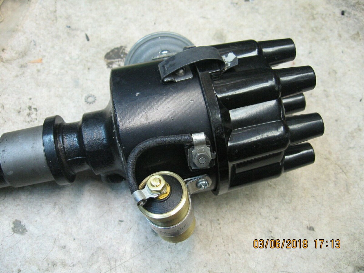

    A brand new box of goodies arrived today.
    Hotrod parts! Now it'll run like a Corvette because that's Corvette type points! (I wish).
    Going to get that all set up to replace the mangled plate in my distributor, hopefully it'll improve the misfire.
    Phil
  14. tubman
    Joined: May 16, 2007
    Posts: 7,965
    tubman
    Usually, when you put one of those conversion breaker plates in, there's no longer room for the condenser inside the distributor housing and you have to go to an external condenser. You can hang a regular automotive condenser out there, but it really looks kinda wimpy. You need one of these. This is a '49 Olds distributor with the same conversion done.
  15. PhilA
    Joined: Sep 6, 2018
    Posts: 2,104
    PhilA
    1. Hydro Tech
    Absolutely right- this one comes with a nice little mounting bracket to fit the condenser on the outside- you can see it there on the right hand side. The screw that holds the cap clamp is used to hold it in place, and the standard flying lead on the condenser reaches the screw terminal that goes to the coil.
    I'm just going to fit the standard wimpy one for now, but I'll keep that in mind! What's that one from?
    --Phil
  16. v8flat44
    Joined: Nov 13, 2017
    Posts: 1,211
    v8flat44
    You better get traction bars.....dual points & a tubman condencer....she's gonna fly.
    Tubman makes those condencers....he's a sharp guy.
    8 cylinders all in a row, dual points man she'll get up & go....
    Really neat Phil !!!!
    loudbang and PhilA like this.
  17. PhilA
    Joined: Sep 6, 2018
    Posts: 2,104
    PhilA
    1. Hydro Tech
    Ooh, really smart! But yeah, I was thinking maybe a set of wheelie bars and a parachute
    It should cut down the timing wobble at about 700RPM that's visible on my timing light- the tach needle jumps about a lot at that point too. The old plate is junk.
    If I have time I'll fit it tonight. Can't go drive because the wheel's off and the brakes are in bits but starting it up will give a bit of an idea if it's better or not.
    --Phil
  18. tubman
    Posts: 7,965
    tubman
    I make 'em. This comes under the heading : "I you can't go fast, you should at least look good going slow".
  19. PhilA
    Joined: Sep 6, 2018
    Posts: 2,104
    PhilA
    1. Hydro Tech
    I agree. Every day's a school day, I'd never had to look for an exterior-mount condenser before.
    I've got some here that are bigger than the coil itself, nice shiny aluminum. Rather outside the required spec (1.3F @100V) for the coil and points though. DC power bus smoothing kit. Gutting one of those and sticking it in place would be rather overkill, I think.
    --Phil

  21. tubman
    Posts: 7,965
    tubman
    Just so you know, the condenser (internal or external) should be rated in the .2-.3 micro-farad range. Also if you have a generator, anything rated at less than 400 volts may be problematic.
    If you used one though, you could probably get away with it by calling it a "Flux Capacitor".:eek:
    chryslerfan55, loudbang and PhilA like this.
  22. PhilA
    Joined: Sep 6, 2018
    Posts: 2,104
    PhilA
    1. Hydro Tech
    Don't think I'd ever make it to 88mph!
    Lifted the distributor out of the engine after work today.
    Stripped it down enough to be able to put the new points plate in.
    Had a "what the hell" moment and decided to strip all the rust off and tidy it up.
    It's currently sitting on the bench drying. Bit of an improvement. I'll finish tidying it up later, gotta bring the boy to scouts right now.
    Phil
    slv63, ClarkH, chryslerfan55 and 5 others like this.
  23. PhilA
    Joined: Sep 6, 2018
    Posts: 2,104
    PhilA
    1. Hydro Tech
    Yeah, it's got a .33uF condenser that I'm going to mount externally. It's got a ballasted coil that puts out well; car is running a Delco 10SI alternator so odd transients are minimal, just RF noise which is limited by the bypass cap in the alternator housing.
    Phil
  24. PhilA
    Joined: Sep 6, 2018
    Posts: 2,104
    PhilA
    1. Hydro Tech
    Bon. Set up as per the specs. Car runs really well now.
    Phil
    FirstNation, Woogeroo, ClarkH and 7 others like this.
