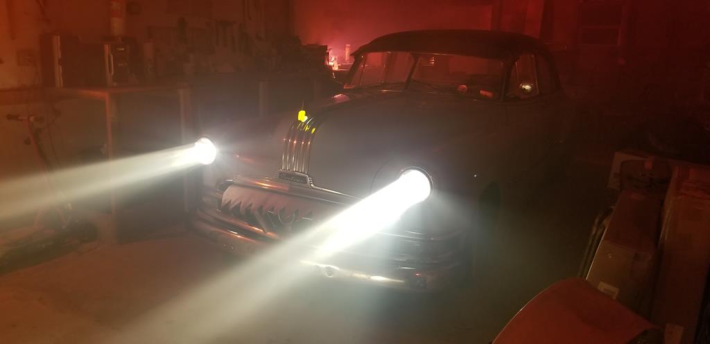

    1. Hydro Tech
    I'm good, I rewired the headlights. Ain't no rou-ga-rou gonna come find me, mais non cher.
    (There's the picture I was looking for!)
