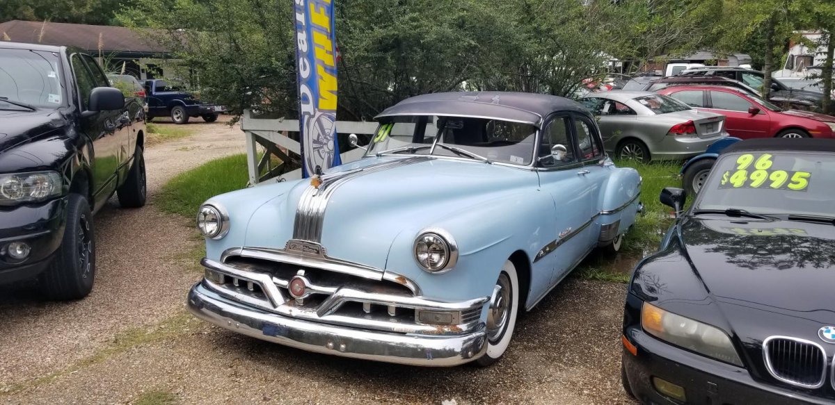

    A few pictures from the classified ad.

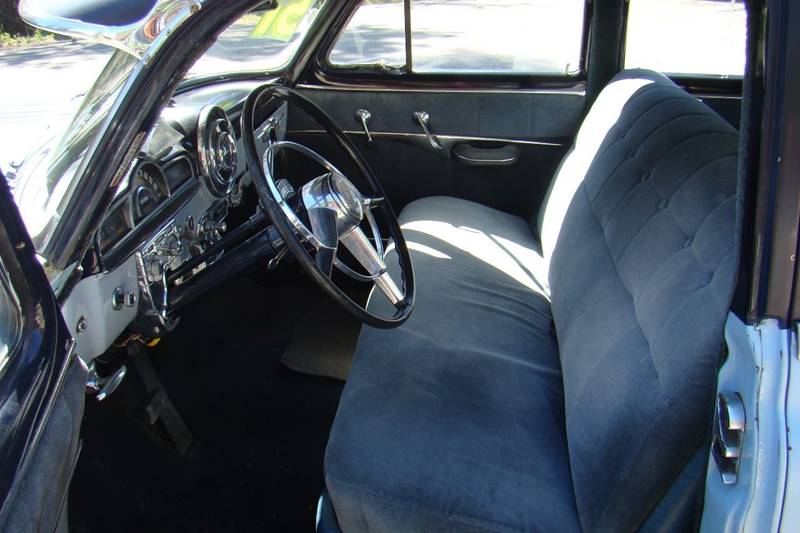

    Interior-wise it's fairly smart. The driver's side door card is the worst, having suffered from a leaky window.
    Back is still quite nice. The seats are comfy, the original pattern of stitching was echoed from the original seat cloth.
    Headliner is in pretty good shape, also although now with the humidity down here it's gone a bit wrinkly.
    Stock '51-'52 dash, in modest shape.

    So, I set out and got some miles under my belt. Bonus point if you know whereabouts that is.
    Collection day- just after Labor Day 2018. Apparently with it sat up on the lot, sold, the seller said he had more interest in the car and higher offers than I had paid; however, I had paid and paperwork was signed. It was mine.
    Cue a 5 hour journey home on surface streets. I did not want to take I-55 back as it is 23 miles of bumpy elevated busy Interstate. I'm glad I didn't because even on a twin axle trailer the Pontiac is really very nose-heavy and was adding a little more tongue weight than I was happy with.
    Finally got it home, fought in the rain to jump-start it off my car and parked it up on the driveway then took off again to go bring the trailer back to U-Haul in town. It was a long day, 330 miles towing a trailer.

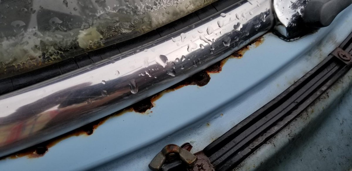

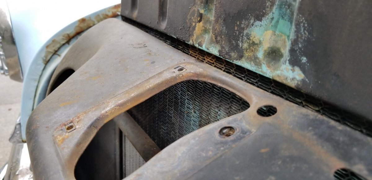

    Outside, there are some bits of rust. Most of it is localized, but in the case of the scuttle where the trim clips have taken the paint off, the metal has gone through. Not too bad but I know, I just know the screen frame is going to be nought but bran flakes under the rubber. Undeterred, I continued.
    Yeah, another typical rot-spot is a bit crispy-crunchy. Again localized to the corner where the mud has collected inside the wheel well and up under the trim plate. The rockers are a bit on the thin side in places. So, the bottom of the car is rusty in places. Not really a big surprise.

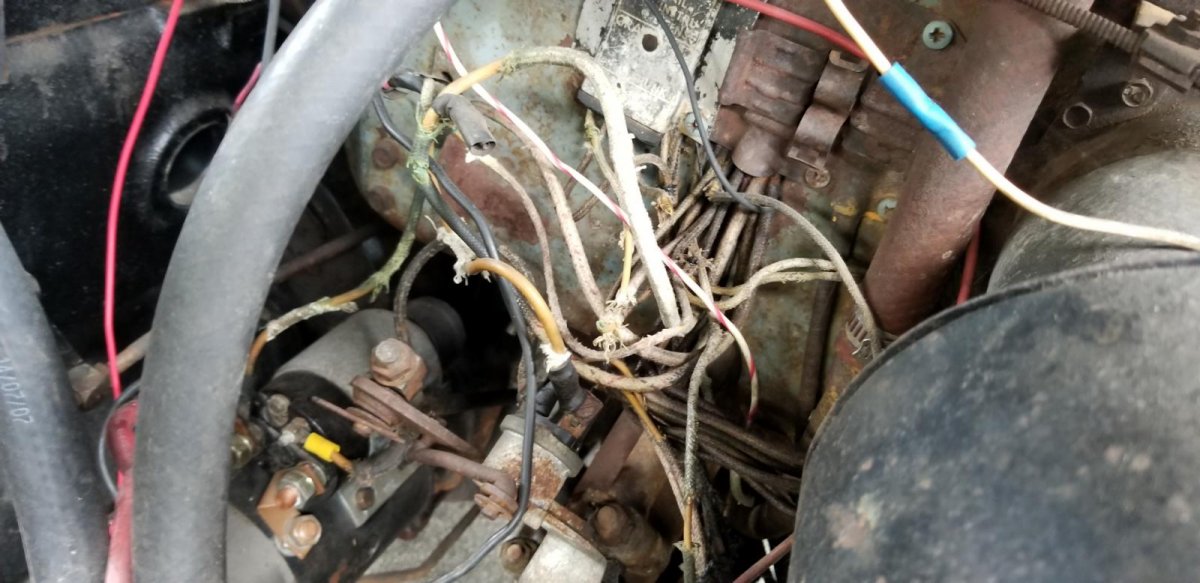

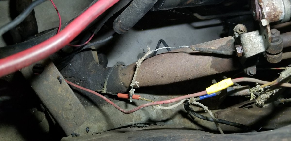

    This was just plain bad. Most of that was still live and in use running various lights and stuff up front.
    Finally, check the angle of the dangle on the alternator. The belt was slack, with no more adjustment present and it was sitting at a horrible angle and was squealing like a stuck pig.

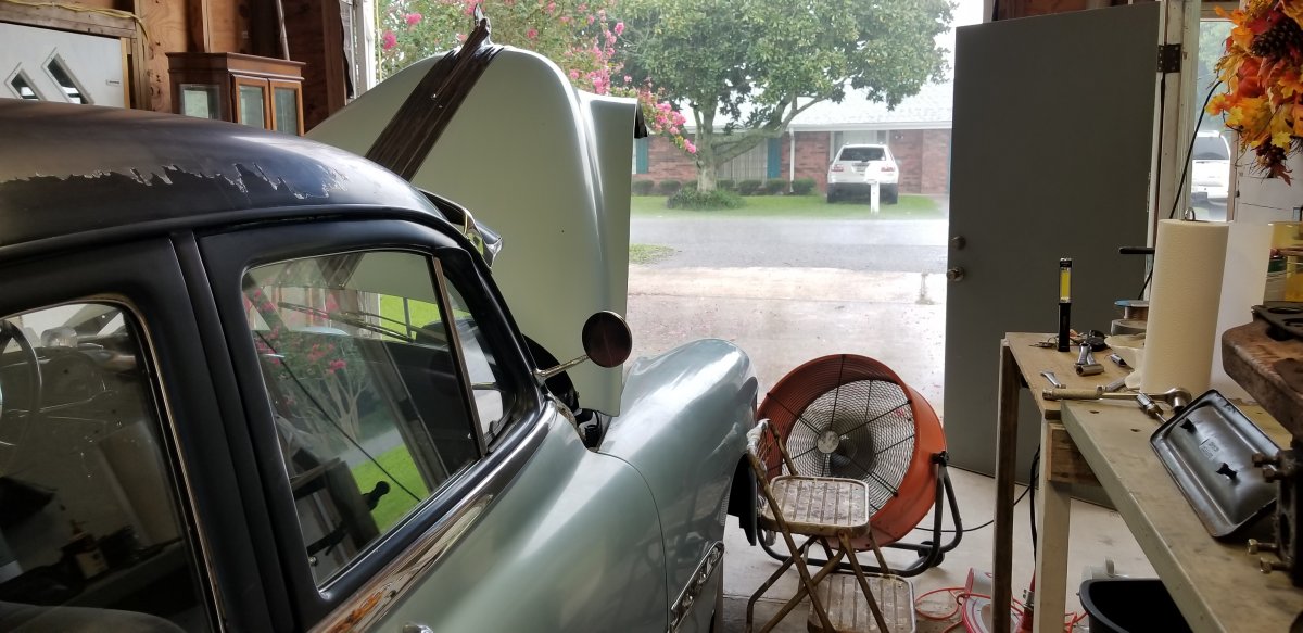

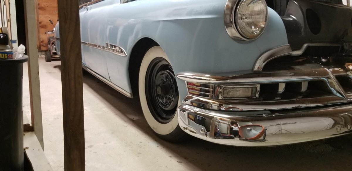

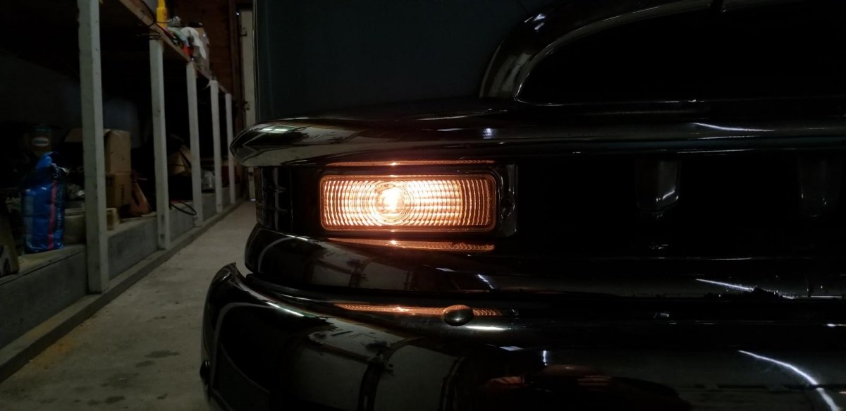

    I dried the car off and backed it up into the garage. The eagle-eyed amongst you will see the little trail of Hansel-and-Gretel style drips that showed where the car had been (and the kitty-litter under it too...).

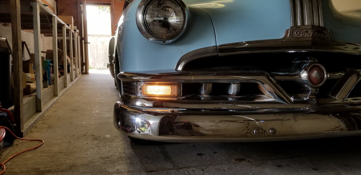

    I started by replacing some bulbs as not many of the original ones actually worked. The brake lights did not function and occasionally selecting the left turn signal would cause a few clicks to emanate from the flasher relay.
    I had a bit of a poke and got the Chief lit back up. I also had a bit of a go at the chrome with some polish. Not the best, not the worst. I'm leaning on calling the rust "patina" and living with it for now. You will also notice the driver's side light is quite bright- reason for that is someone had wired the lights up wrong. One bright, one dim. Clicking the dimmer switch gave a police-car-chase style wigwag of the headlights. Not ideal.

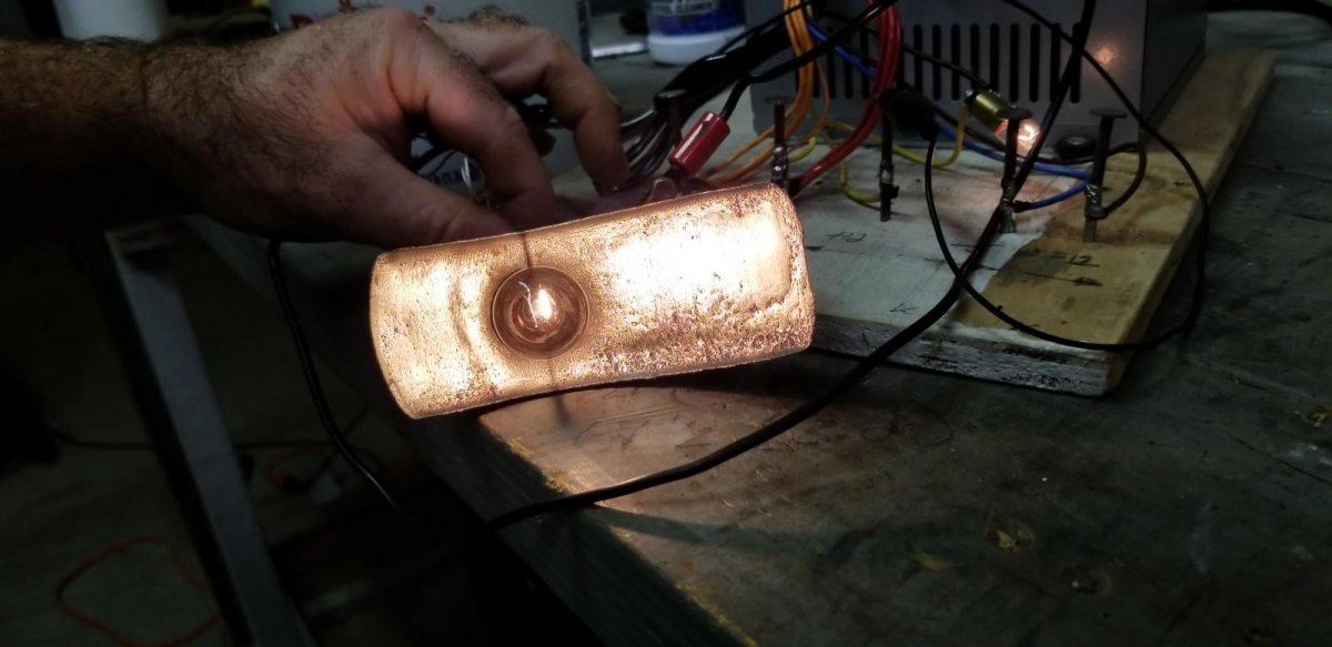

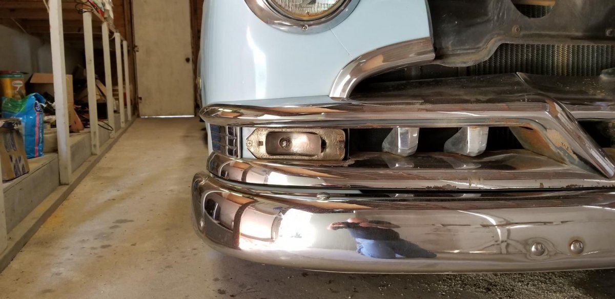

    I took the parking light lenses off the car, which haven't seen any type of seals for years. With the grime removed.. the light output was not much better.
    Ah, that might be why. Someone decided the reflectors were rusty so painted them black. Naturally the best color choice for reflectors. This side had also seen a new light bulb holder welded in.

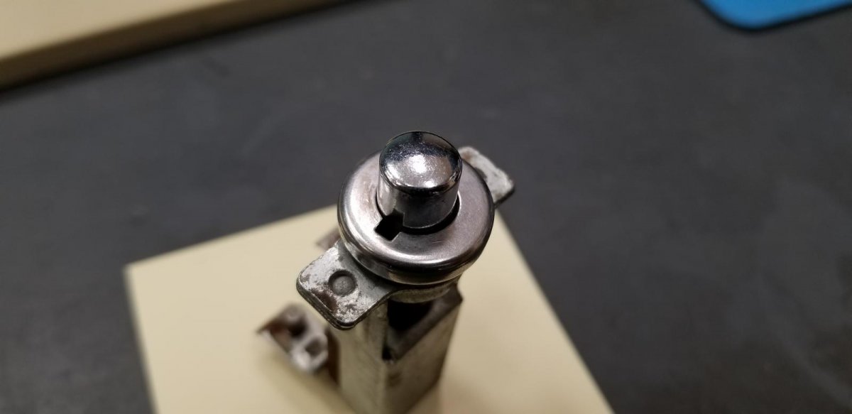

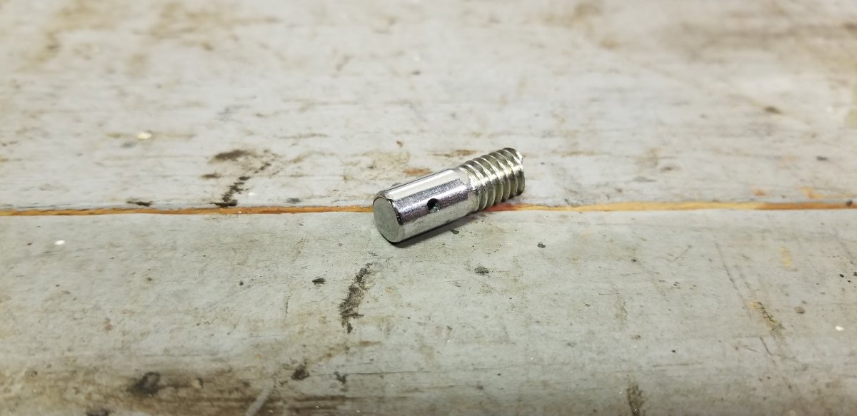

    The assembly comes apart into component pieces (despite not being meant to), and the little green discs that serve to diffuse and dim the light of the bulb were not all present.
    Closer inspection showed one to have fallen down and become engaged in the turn signal/gearshift bracketry.
    Careful excavation with a pair of tweezers saw it all reassembled correctly.
    The small tubular piece attaches to a bracket which has a small crank that is fixed to the gearshift lever. It moves with the lever arm and the little window illuminates the appropriate gear position circle. During the day there's a metal arrow that points at the circle, above. The wire for the lamp had become detached from the metal pad that serves as a terminal for the wire that runs down the steering column to power it. That was rewired and reconnected with a bit of flux and a finely controlled flame to get it warm enough.
    A little bit of polish later and it was looking a lot better.

    Lashing rain and 100F. Welcome to the south of the South. Having finished the valve lash, I stood back and looked critically at the front lights. Recall the rusty, black-painted reflectors? Well, they hadn't fixed themselves since I looked at them last so I decided to try something.

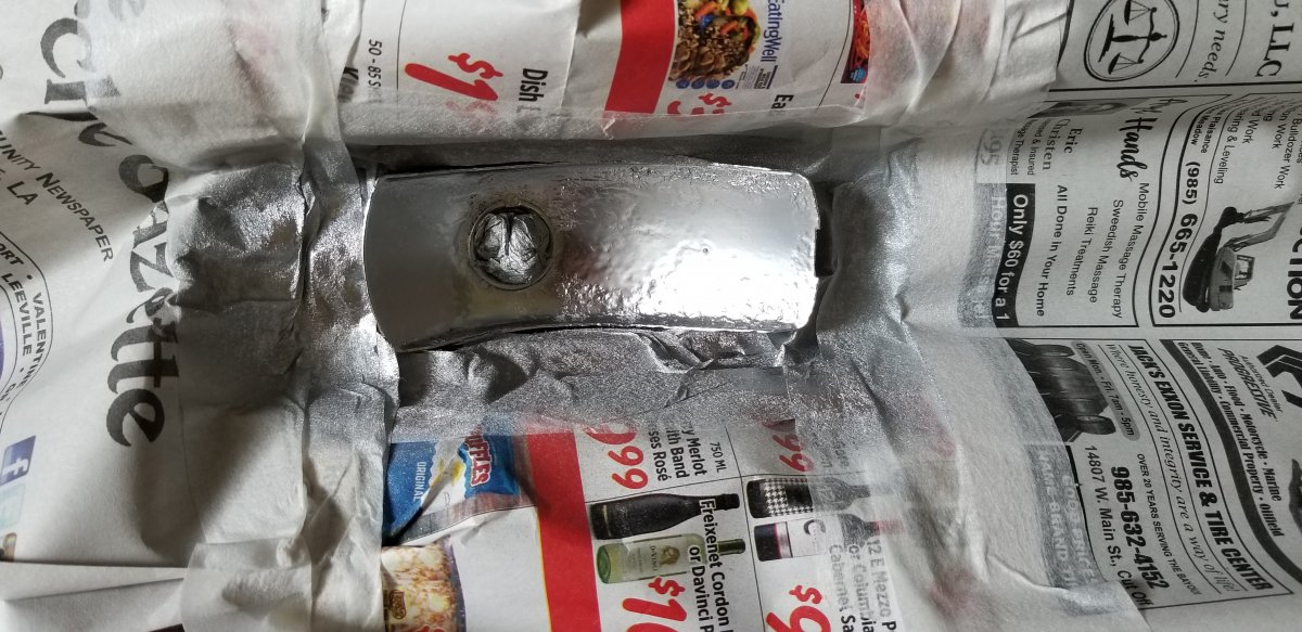

    I rubbed the reflector down and painted it in "Shiny aluminum" paint. Granted, that was significantly better than what was on it before, I was not totally happy with the result.
    Still it paved the way for what was to come. That is an acceptable turn signal.

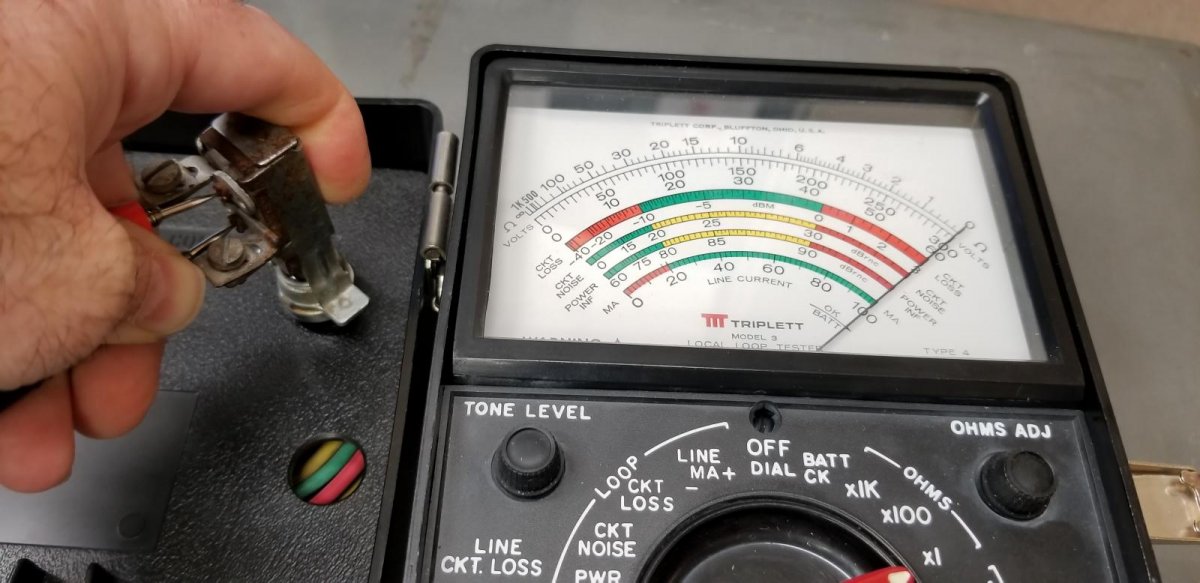

    Buoyed by that small success I turned my attention to more electrical things. Note that the car was originally 6 volt negative ground. Some clever soul had "converted" the car to 12 Volts with the addition of a 12V starter, a Delco 10SI alternator (mid 60's Chevy style) and a 12 v battery and had replaced (some of) the exterior bulbs. They hadn't touched anything else...

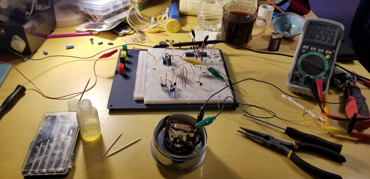

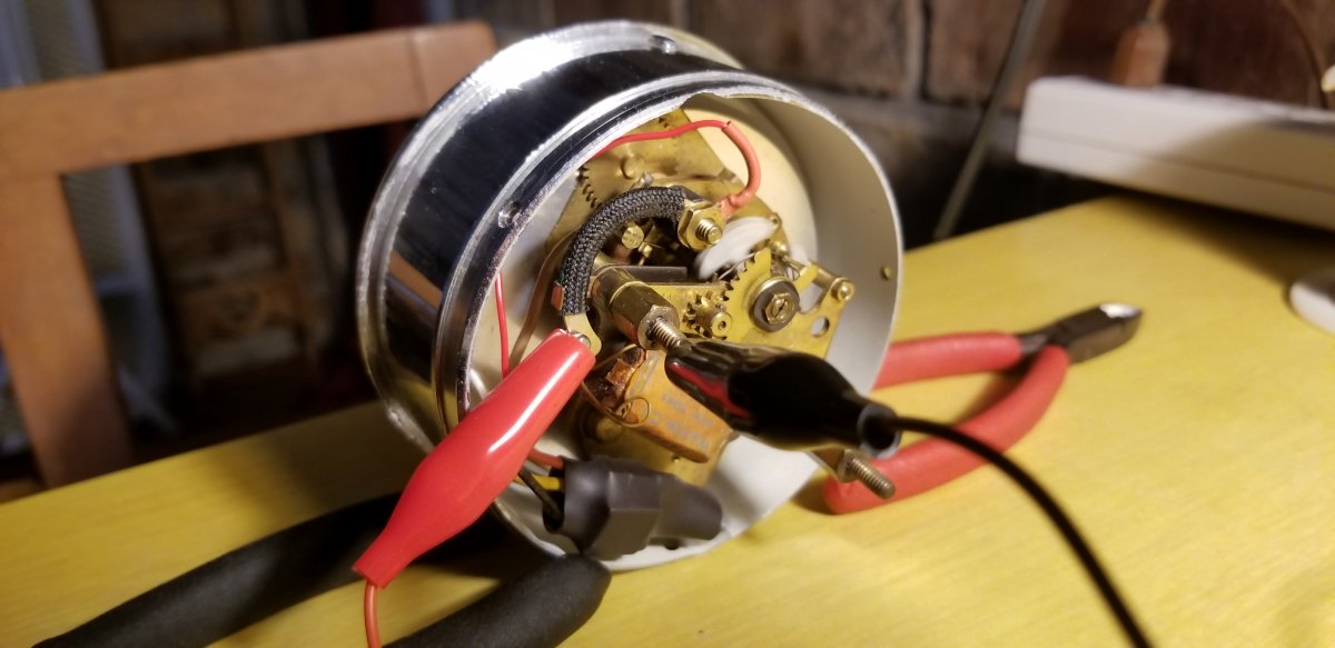

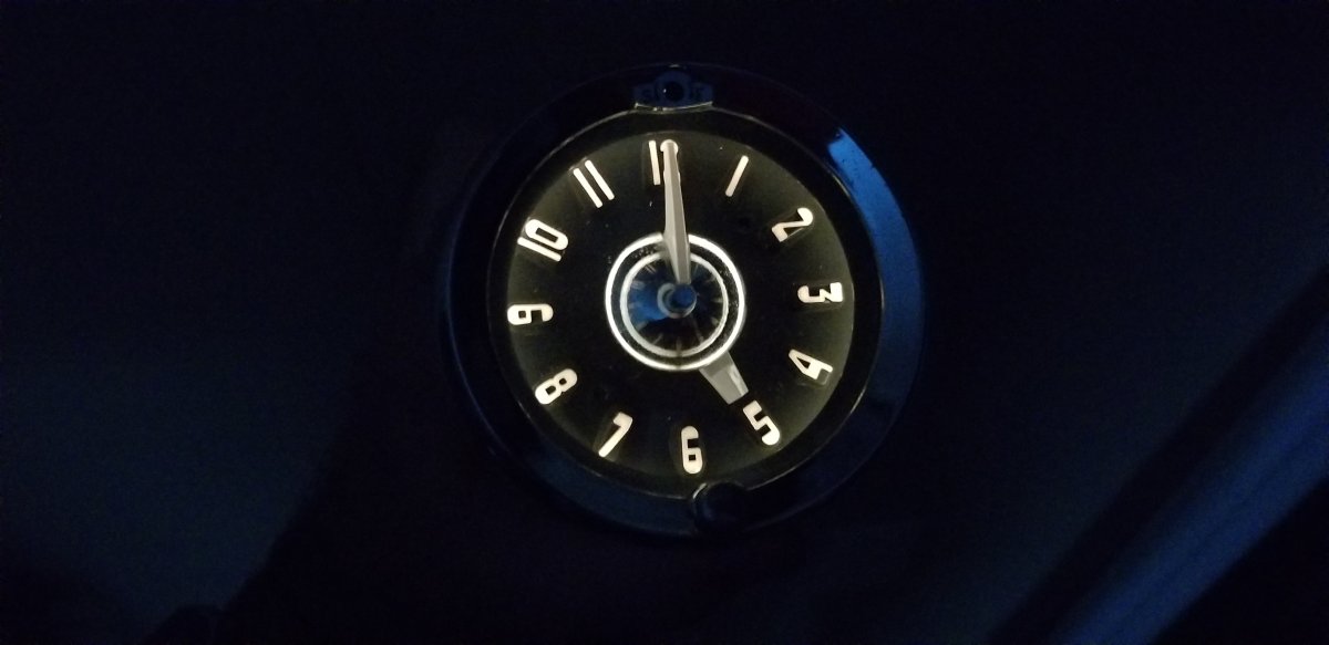

    I took the clock to pieces. It's the original Jaeger one and the coil is marked "6 VOLT". Unsurprising. I built myself a little 12V to 6V converter circuit, cleaned the clock up, lubricated and tested it. Input 14.4V, output 5.9V. Result? Clock ticking away merrily. It's mostly a clockwork clock, simply with an electrical coil in place of the coilspring- a set of contacts on the balance wheel energize the coil and drag it round towards the magnetic field, which then breaks the contact and it drops back due to the hairspring. Repeat ad infinitum. tik-tak-tik-tak-tik-tak.
    I built the voltage regulator into the little black plastic shrink-wrapped section and tested it for a couple days on my bench power supply. It keeps really quite good time.
    That's good, as it is really quite a nice clock to look at. Set up in the car ready and waiting to 5pm, because hey, it's 5pm somewhere, right?

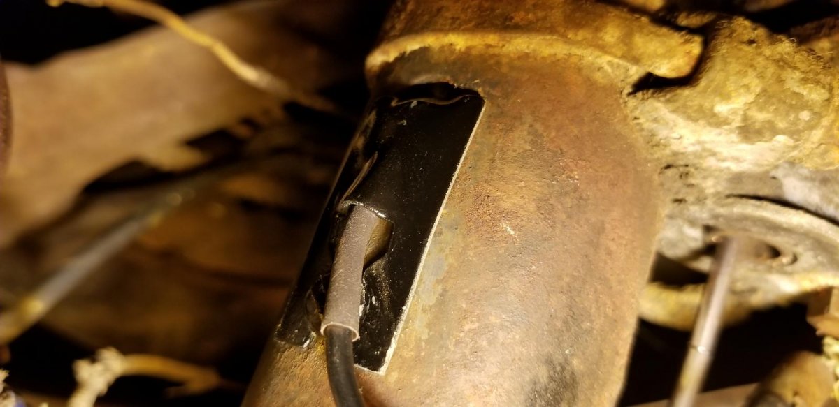

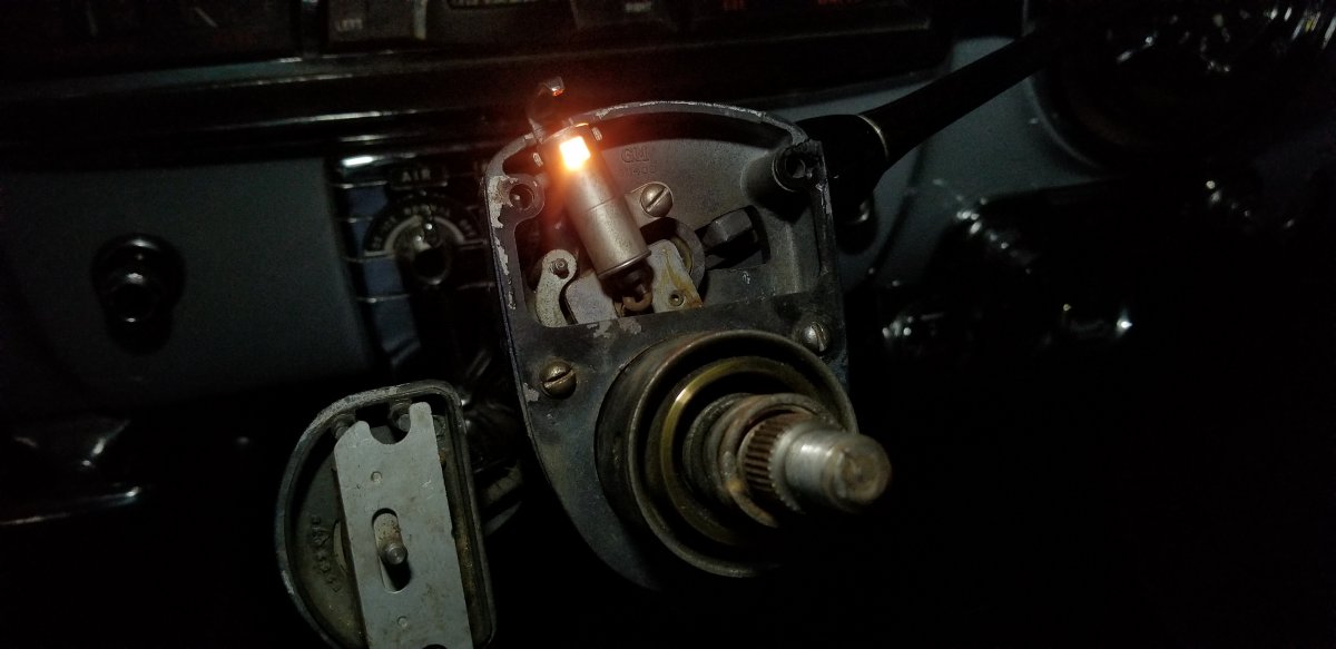

    More scary wiring! The length of bare conductor there is the wire for the gear shift indicator light. It runs all the way up the center of the gear shift tube to power the bulb, but in this instance it was a fire hazard. I liberated the old wire, pulling a new one through with it.
    Rewired, the lamp functioned correctly when connected to a battery.
    Pretty smart. It made me smile. Things that make me smile, in terms of design, stay.

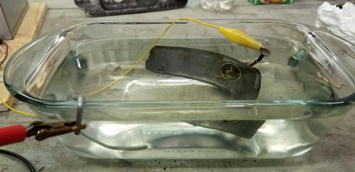

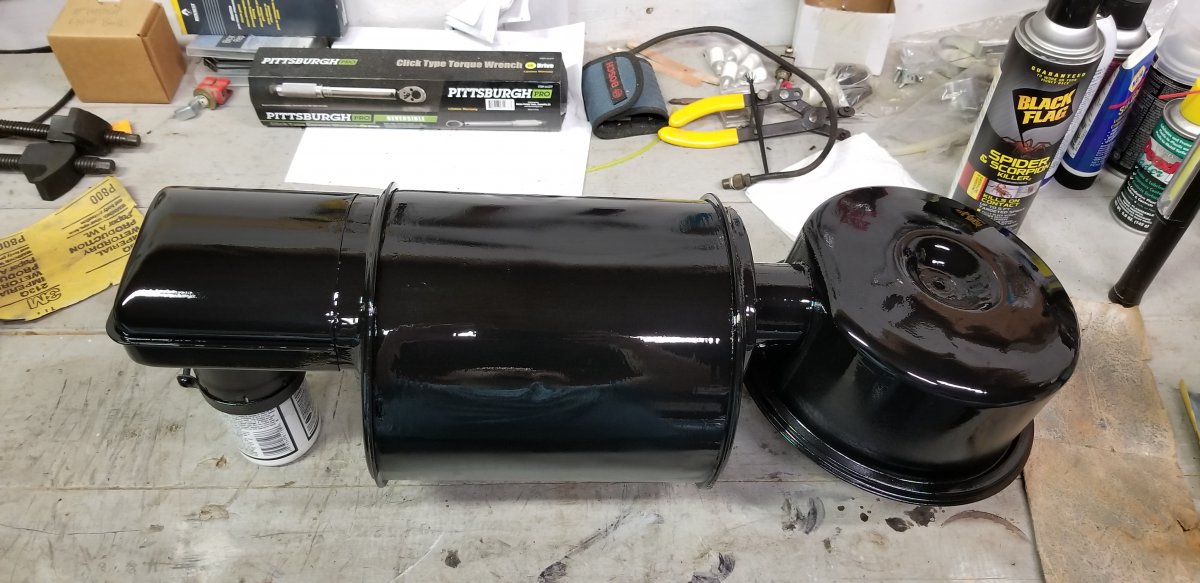

    Recall the eBay purchase? I did a bit more research because somebody had pilfered the original air cleaner assembly. The original was a top-hat style one that sat directly atop the carburetor. An option was this one above, the same cleaner but attached to the carburetor via a large muffler can.
    That all scrubbed up nicely with a couple coats of gloss black enamel. I made a bracket to support it from one of the head studs (which has a thread sticking out of the cap to attach a steadying bar to on the stock filter.

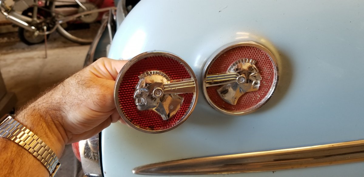

    A little more cosmetic work- I bought some red lacquer as a number of the red emblems on the car were very sun-bleached.
    Masked off and repainted the wheel trim badges. I preferred this look over a solid red.
    Goes nicely and looks a bit more sharp in the sunshine.
    The (badly pitted and rather quite funky) rear flank emblems also had the very pink paint stripped off and red lacquer applied. Left new red, the one on the car as-was.
    At the same time I repainted the rear badge, which is still very tired, all the chrome having been polished off all the way down to the nickel underneath. My excuse, patina.

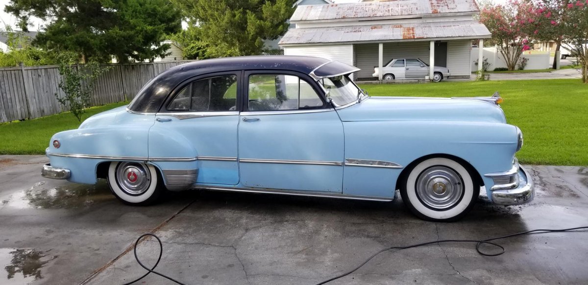

    After painting up the wheel trim emblems, I stood back and tried to decide if I should run without them. The wheels are real nice looking, even in gloss black.
    Pulled the car outside to give it a wash- looks quite different with the rear spats removed. Again, trying to decide what look I preferred.
    That aside, just washing the engine compartment down liberated quite a remarkable amount of grime. Looking at it, I would wager a good 20 years of dirt and oil all congealed with sand and dirt, stuck on every available surface.
    Back inside, I went back to electrical items. Took the neutral inhibitor/reverse light combo switch apart and cleaned the contacts. I was greeted by illumination in Reverse. Simple but satisfying.
    I bought an ignition switch. Turned out to be the wrong one (Pontiacs use Chevy truck switch barrels with the two little arms to grab onto a plate and hold it level). I removed the inner frame and did it up to the dash- works well enough, looks correct. Only thing lost is the cigar lighter illumination which is only useful when the lighter is pulled out anyway.
    The starter button was also half missing so eBay again. There are new ones available but they aren't machined as nicely and also look far too new.
    This one has all the dimples and pits and marks of having been pressed each time someone got into the car and matches the rest of the dash nicely.
    It tested well so no need to pull it apart. That was quite surprising. Made a change from the rest of the electrical parts I had so far touched.
    I rewired the horn push. This little plate is held in with a small-ish sheet metal screw that is up in a fairly exposed area at the base of the steering column. I don't think it had been undone since it was put in. It took about 40lb-fy to undo, and came off with a loud crack. Removed all the rust from the plate and screw, painted and reinstalled.
    Cleaned up the bearing and electrical contacts on the other end of the column, as the horn push grounds through the bearing to the column. Initially it was not working because the wire had broken off.. secondarily the bearing was dry and oxidized. That saw it able to pass current again. A new 12V horn relay was fitted up and the push operates it very well now.
    At this time a bunch of new parts came in. I found why the brake lights were not working. Three reasons. First, the switch was bad. Second, the switch was disconnected. Third, the turn signal switch contacts were bad. Everything was bad!
    As a side note, I have no idea what a "Lunar Crimp Frame" is, I've always just referred to those as connector crimpers.
    The windscreen washer jets were also missing. I cleared the age-old crystallized gunge out of the pipes, took a couple of screws with the correct thread, turned them down in my drill with a file and drilled a hole up the center and another one sideways at the end to meet it.
    They work really very well. Much easier than actually trying to find the correct nozzles...

    Recall the turn/park signal reflector that I had painted silver? Well, yeah, I wasn't happy with it so decided to strip the assembly down, removed the paint and dropped the steel into an ascorbic acid solution. After a couple of hours it's beginning to make an improvement in the picture above.
    Overnight, the chemical reaction turns the solution from a pale orange to inky black.
    Wiped down, the improvement is significant. However, that's still not clean enough, particularly if left on the bench overnight unprotected.
    Steel flash rusts quickly!
    Scrubbed that down with my wire wheel and put it into an acid bath and applied a current, to pull the ions and metal off the surface of the steel.
    Galvanically cleaned, I then attempted to polish the surface down a little- it's a bit thin in places.
    Polished, it is nice and shiny but won't last, as proven by leaving it on the bench. Some sorface treatment is required. Originally I think the factory painted them white. I wanted something a bit better, so turned to a bit of alchemy.
    First, copper plating with my home-made rig. All off the shelf stuff from the local grocery store and an old desktop computer power supply. Then, followed up with nickel plating to give a silvery finish. Nickel is slightly yellow; normally the next step would be to chrome plate but the chemicals involved in that are Federally regulated, incredibly nasty and carcinogenic, so not something to be fooling about with at home.
    Certainly an acceptable repair. Shiny enough and should last that way for a good while.
    Connected up to test, it was sending a lot more light forward. That's just the parking light.
    Back on the car with the backing housing also given a light plating and the backsides painted black.
    With the lens reinstalled the light is very effective again.
    In the sunlight it's a lot more pretty to look at, too.
    That worked well enough! I think you can buy replacements, but I had wanted to keep the original parts if I could.

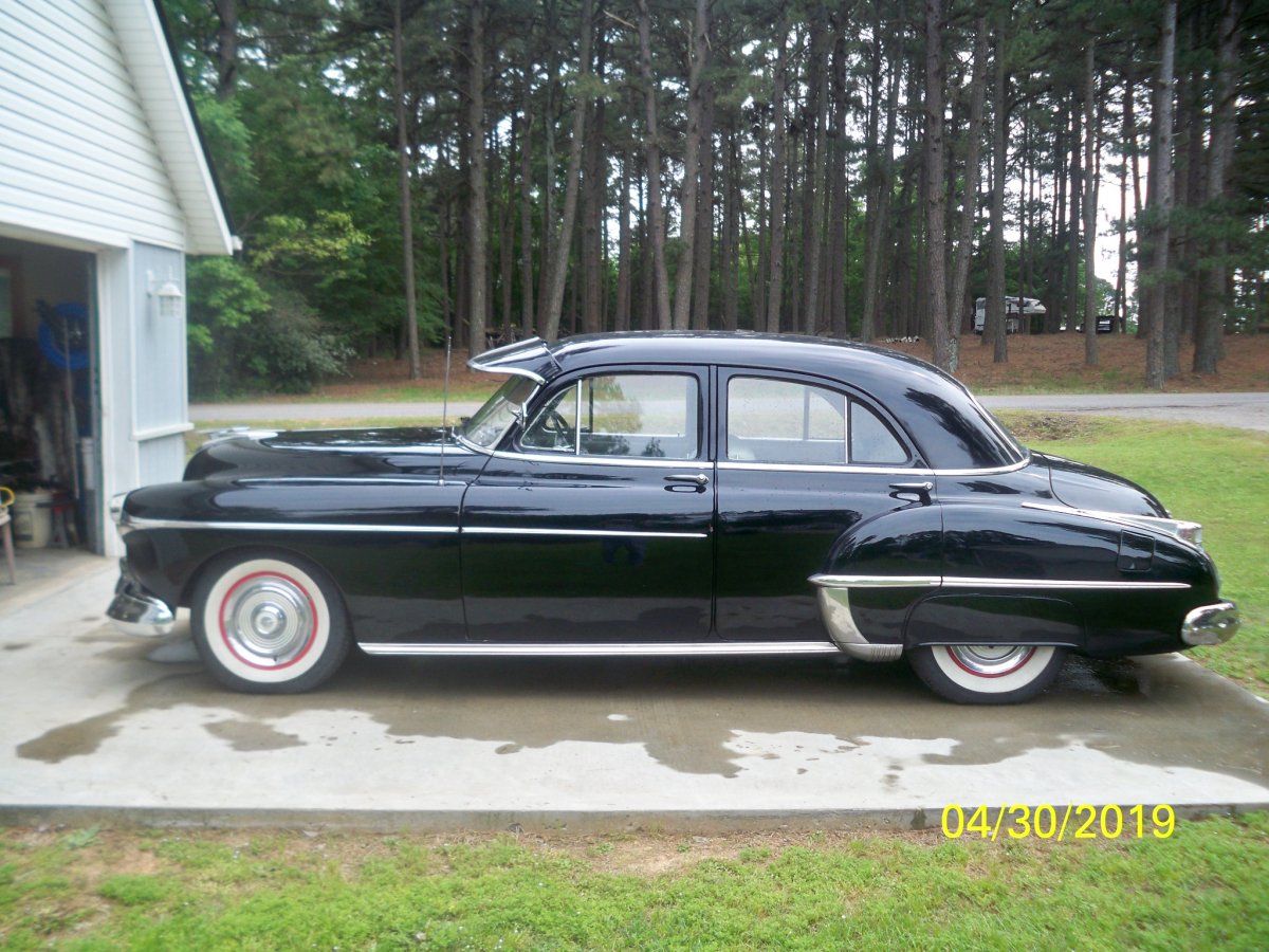

  27. Nice work Phil, looks good. Years ago I had a '50 Catalina that I wish that I had kept...
    ... like your's, it still had the straight 8 and hydra-matic.
    Picked up a '51 Oldsmobile Deluxe 88 last year, I wound up rewiring it and converting it over to 12 volts. It too has been lowered a few inches all the way around, still want to get the back end down a little more. I'm thinking about removing the skirts, I like how yours looks without them.
