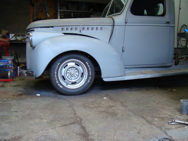

    I am getting about 7" from down to full up on MII's I have done. Here is a pic of 41 chevy with a TCI MII set up w/bags.
    So on this truck down is 2" off the ground with the frame, drive is 3.5" up or 5 1/2" of clearance and up it 8-9" of clearance.
    Kevin
    LFD Inc.
    Down, drive and up.

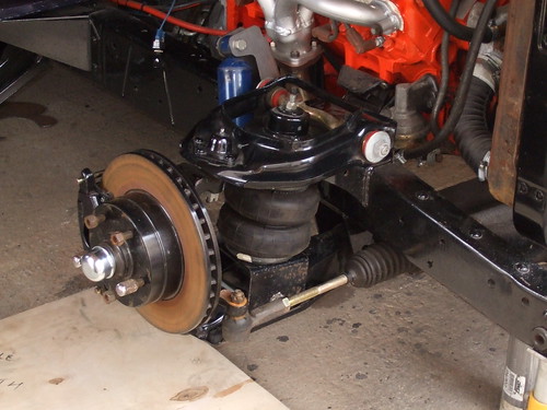

  5. My air system is one of the more basic set-ups but using this system gives me a 4" drop from ride height. It just about lays the crossmember on the deck.
    I can also raise the suspension an extra 2" above ride height to cope with the dreaded speed humps.
    At ride height this gives me 4" clearance at the front crossmember with the option of going up. This then give 6+" at the crossmember.
    I haven't driven it yet but don't anticipate too many problems! (I hope!)
