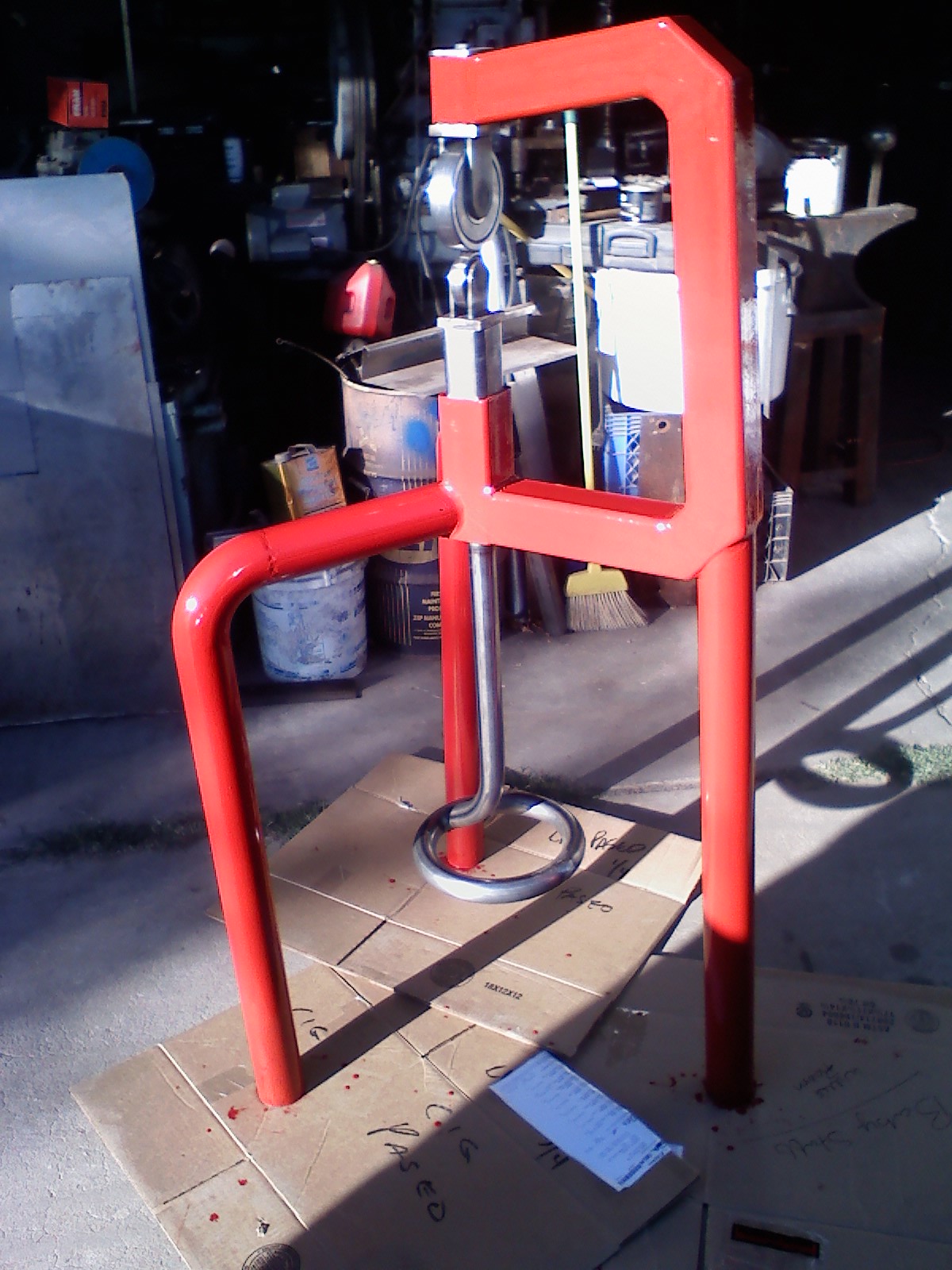

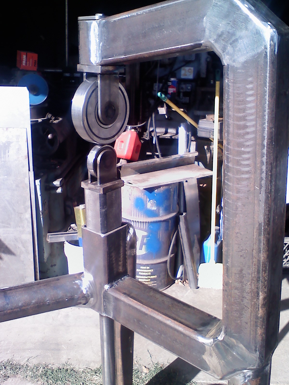

    I made my own took me about fourteen hours over the course of a week after work I used 3 x 3 x .25 for the frame and 2 and 1/2 pipe for the legs and some bearing from a surplus yard total cost about $45.:cool:

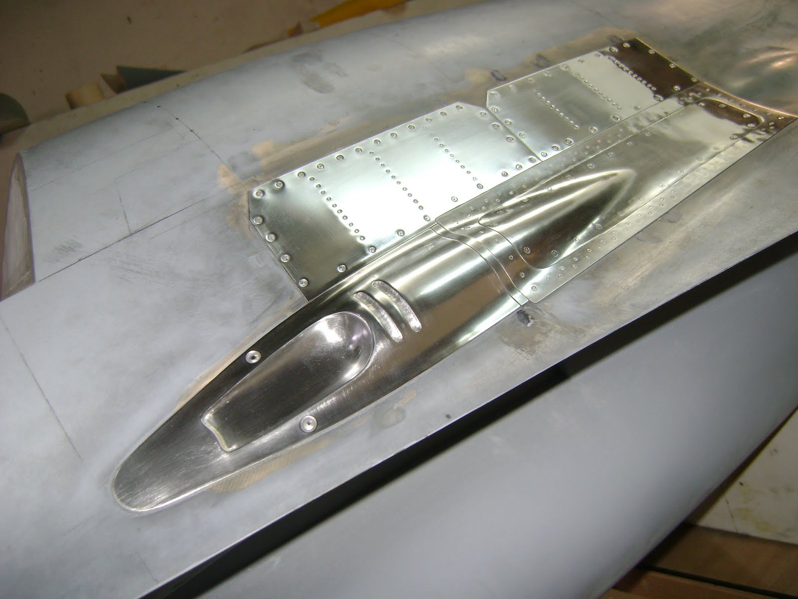

    Hi,
    I am working with aluminium sheet of 0.3mm in a project. I dont have problems with little areas to work the aluminium, my problem is with big areas about 30x30cm where i want uniform curvature in both axis.
    Can I get a concave surface on aluminium sheet of 0.3mm (lithoplate) with the english wheel? Is it necessary a strong english wheel or with a small its ok? Thanks in advance. This is my project i'm working on: http://f16model.blogspot.com/

    amazing job look great
