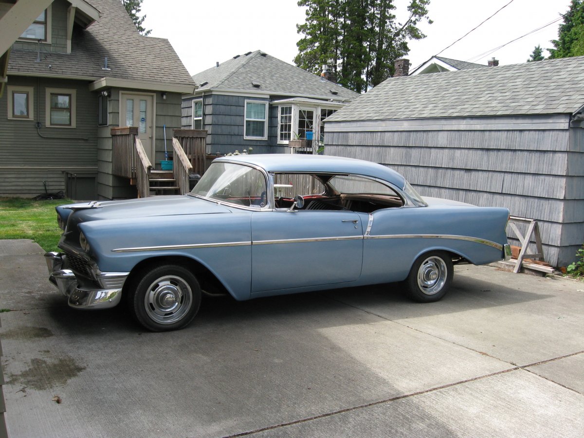

  7. Thank you for the compliments on the color. The PO told me it was a "mid 80's Buick" color. The little bit that my friend cut & buffed appears a bit darker and less silver'y. I'm going to try to get some sort of a color match so I can paint the firewall and the front splash pan the body color. The car is really a 25-30 foot'er as the paint has a variety of issues...

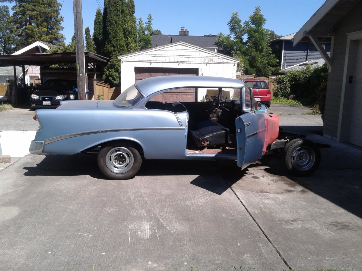

    The primer gray one is a Belair HT that I bought as you see before the 210. I bought the 210 for a few different reasons, as I wanted a car to drive while I worked on the Belair, but that didn't work out so well for me... :rolleyes: Also, when I was born, my dad had a 210 HT (see avatar photo), so when the 210 popped up, I kinda sorta had to have it...
    Anywhozit, I have all the parts for the Belair, but since it didn't currently have a front end on it, it's wearing the 210's front end as the most convenient place to keep it out of the way.

  11. Thanks quick85, here's a few notes...
    • wheels - good eye, the ralleys & tires came with the car (6" fronts, 7" Monte Carlo rears) and will get swapped out for 60's era type wheels that I'm keeping mum about for now. The front tires are small...
    • car came with a then fresh disc brake kit on the front that uses the stock spindle.
    • The back end was dragging on the ground practically when I got it, with worn out, saggy dropped 4-leaf springs. A friend had a fresh pair of 5-leafs he took off his '57 Belair HT project car, that he gave me and that brought the back end up to what you see.
    • yep, peppy cruiser is what I'm going for. I've got front & rear sway bars for it, that will likely go on after all the other work, but I want to see the ride height first after that with the new wheels & tires before I do anything more about stance.

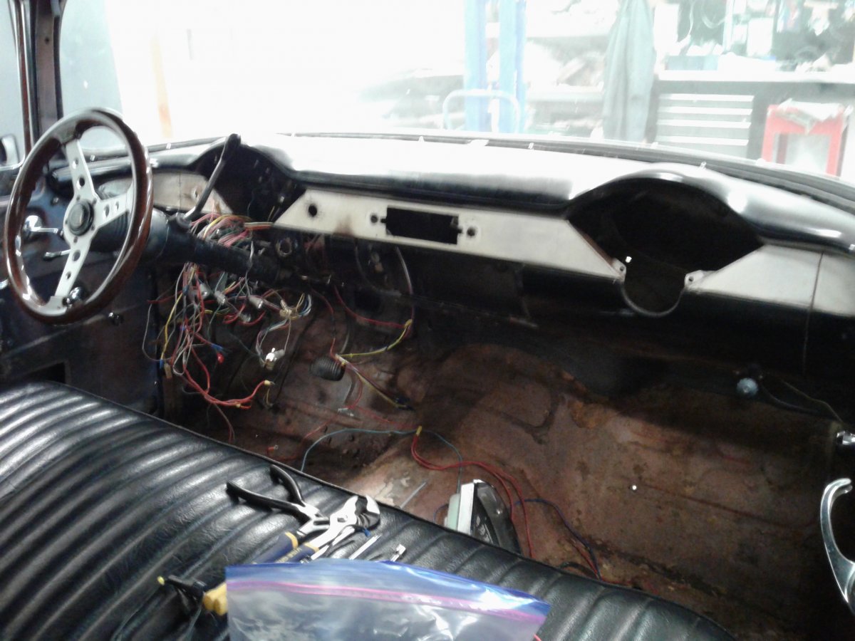

  21. Past couple days I've been gutting the dash. About all I have left is removing the stubborn harness to firewall connector. I'll save removing the steering wheel & column (needs some minor repair) for another day. I hate that Grant wheel and it's going away (none to soon). Funny thing, I've amassed a number of steering wheels that were candidates until I finally found what I really wanted - a wheel from a '64-'65 chevelle 300. Why that one? I like the diameter, and it doesn't have the four little chrome dividers for two-toning the wheel. I also have a clock delete plate to replace the clock in the passenger side bezel.

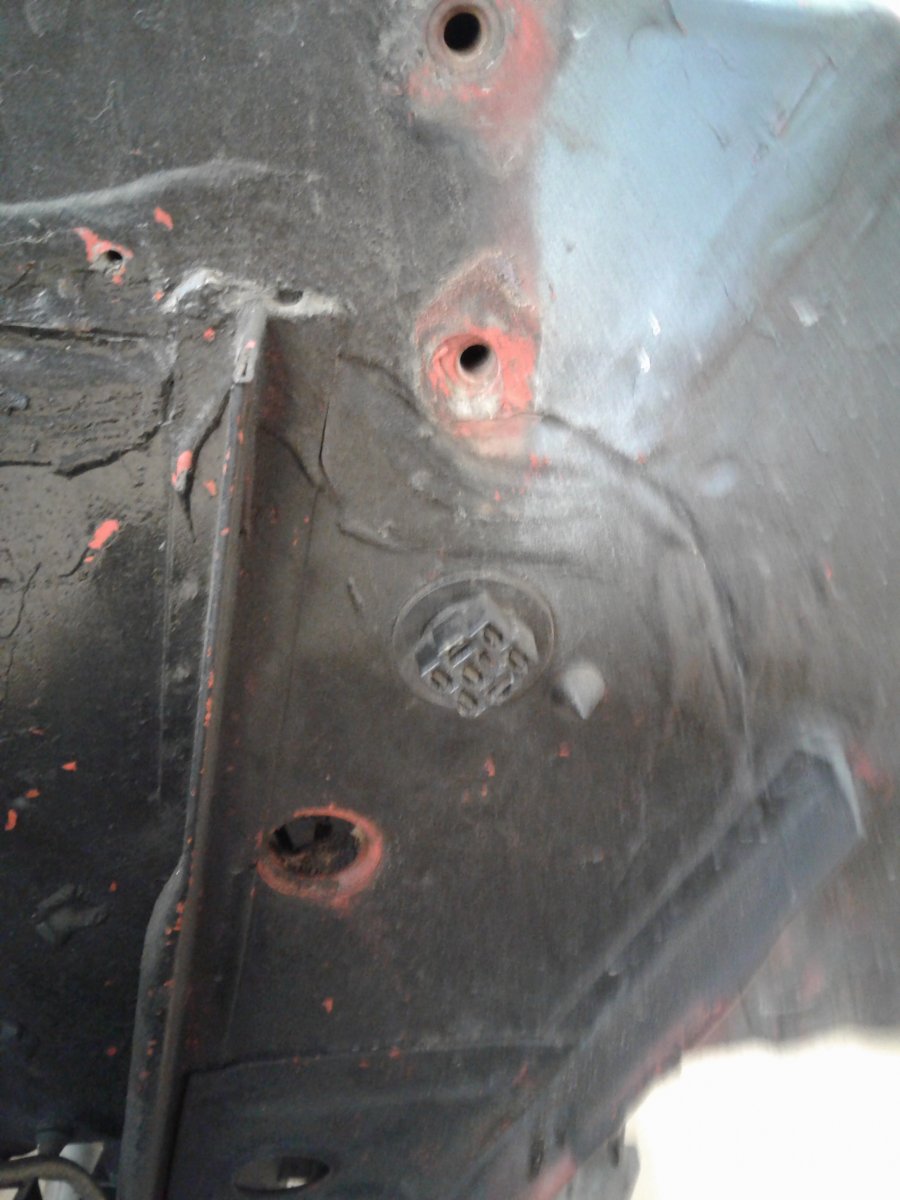

  29. 20190721_152819.jpg Hmmm... no guesses? So... when I took the raingear wiper system out, I had the initial misfortune of losing a small part down the cowl vent at the passenger side windshield wiper escutcheon. As I explored trying to get the part back, I came to figure out the cowl vent drains were plugged up - the passenger side much more so than the driver's side. I used a long screwdriver then a scrap piece of 12 gauge electrical wire to fish around in the cowl drains dumping all that dirt, sand, grit, leaves and otherwise that you see. Really surprising how much was in there. It was a full dust pan worth and actually sort of heavy. I pushed the body into the driveway and used the cowl vent access holes to spray water down the blind cowl areas. The passenger side plugged up twice more because of the amount of what I assume was mouse nesting material hidden away in there, that was eventually washed away. Left it sit in the hot sun for a few hours to dry, then sprayed alot of WD40 into those areas. Hoping all is good past that. In retrospect, temporarily losing the part had a good overall outcome...
    Gotta56forme/Scott
