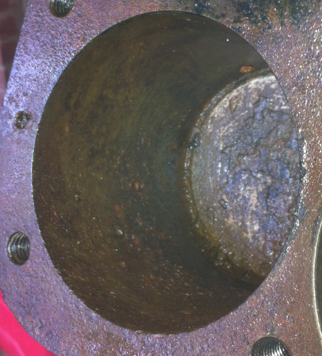

  6. Had a few hours to myself today, got the motor up on my engine stand and removed the sump,
    Found,
    1/Early diamond/bever tailed crank
    2/early timing pointer
    3/only 3 cam bearings
    4/flywheel has been lightened
    I am happy with what I found above but not happy about finding heavy pitting in one cylinder.
    One hole is about 2mm deep, don't know if this can be bored out or will require a sleeve?
    It's standard bore now.
  7. The cylinder in question
  8. Wardog
    Joined: Jan 12, 2010
    Posts: 2,438
    Wardog
    2mm is 80 thou witch would require a 160 overbore.
  9. Might try and hunt another block yet then :(
  10. You can get oversize pistons up to 125 thou easy enough so I'd not give up yet…
    You could always sleeve the offending pot if it didn't clean out at that.
