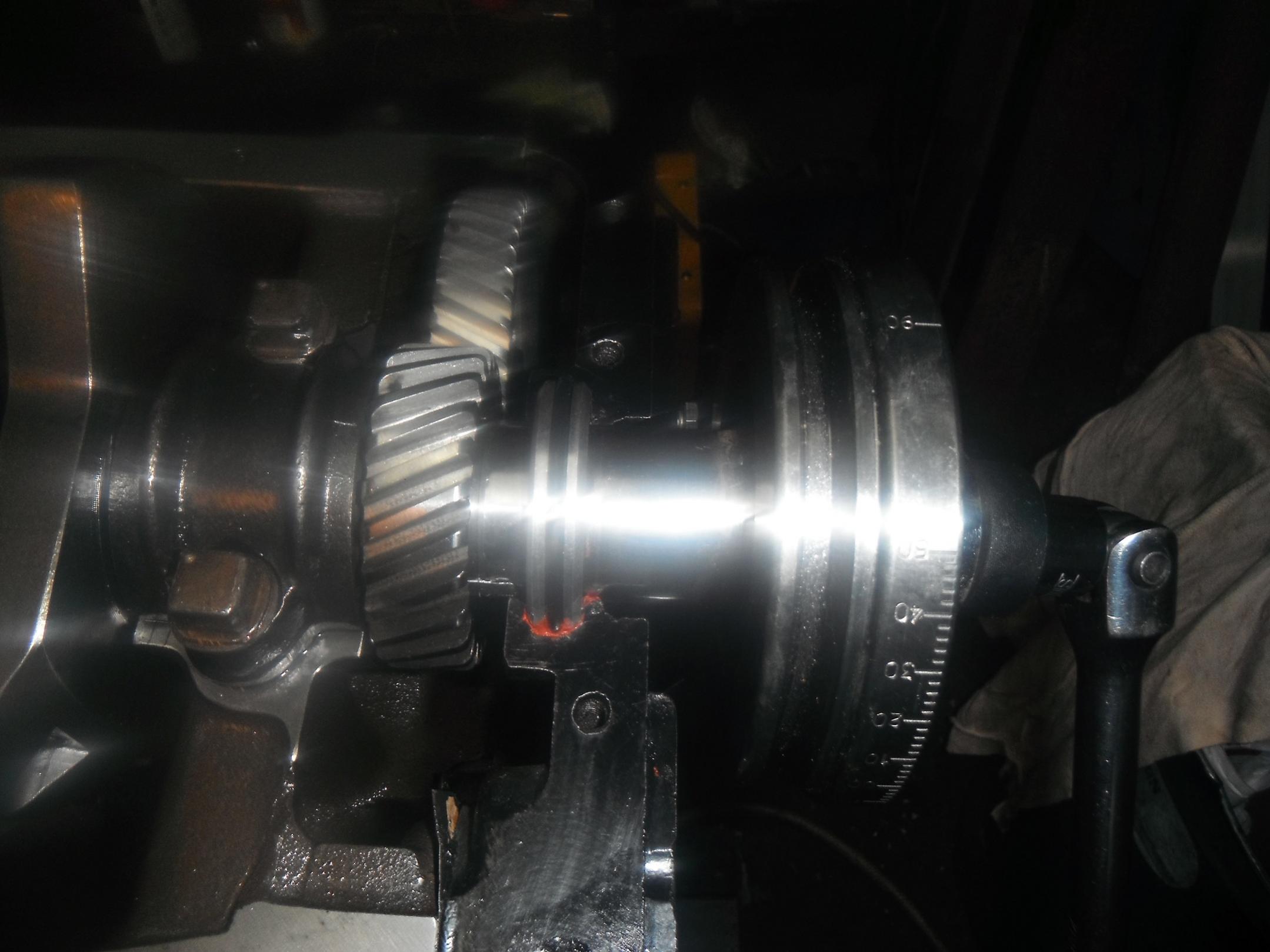

  1. the clutch looks like a standard model a to me
    the early ones have a way different flywheel than that
    tk
    Yes found it to have the more common one that I am happy about, starting to think it might be a later 28 now.
    I know for sure the crank is the 28 early style as it has the diamond shape to the throws.

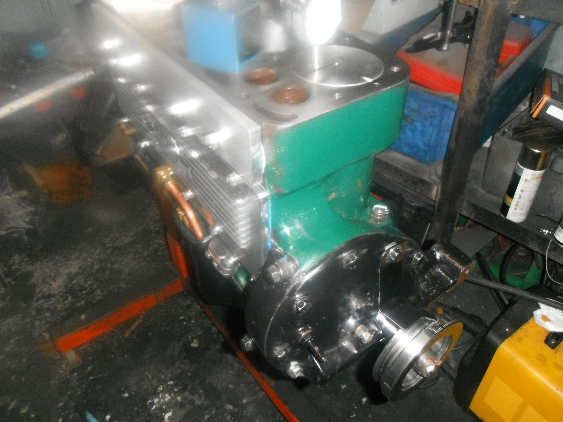

    Here is mine it is 3/16 smaller diameter than the stock A model pulley and the belt runs in the 33/34 location

    Better photo

    No it not a Winfield vibe dampener tried that could not keep together ????
    Outer Diameter is 5 inch
    bore is 15/16
