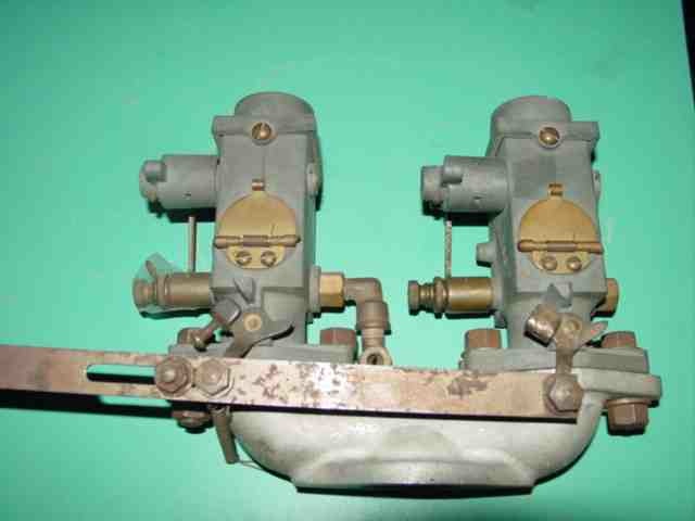

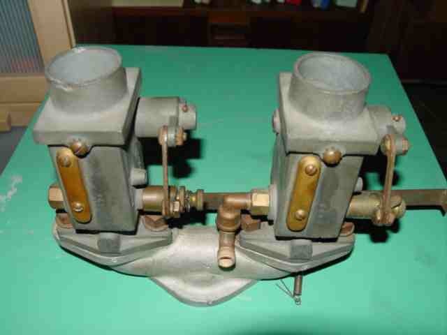

    Time to drag out the "float-less" carb photos again
    These being without floats will mount in any direction The sprung loaded door on the side is for backfire pressure relief

  10. Very cool! Stan Howe had one mounted on a Model T at one point...don't know if he ever got it running. Any idea how much they flow?
  11. Bluto
    Joined: Feb 15, 2005
    Posts: 5,114
    Bluto
    The manifold is undrilled
    I have no info. Like most things I have found these at a swap meet years ago

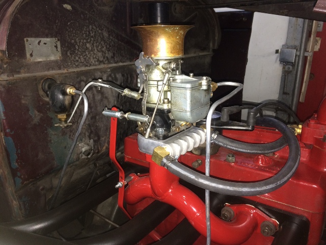

    UPDATE: Heated Carb Riser
    I threatened to report after last month's post...
    I have run the car for a couple days in 15*F - 20*F temps and can report no frost on the intake manifold and that the car does run much better in the cold, car will now run without choke when warmed up. Prior to installation, just the opposite, frost on manifold and poor running. Next step is to replace the rubber hoses with steel tubing to tidy things up.

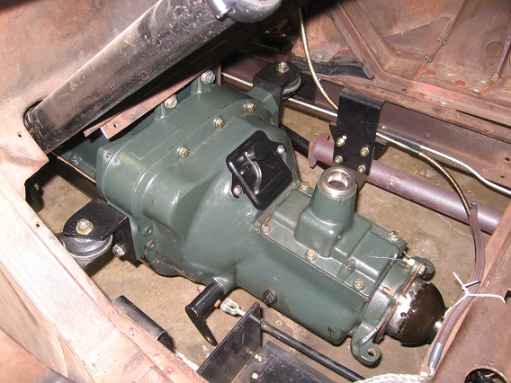

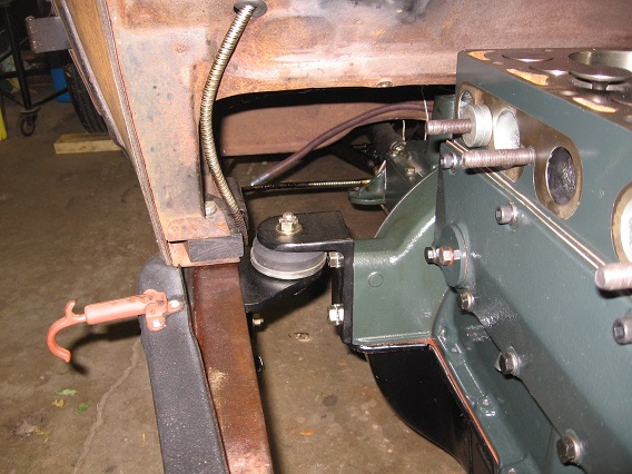

    Next project for my 29 is to install the b motor and trans I just purchased. As far as I can tell I need the kit that mounts the a pedals to the b trans. Also think I need the front b motor mount kit and float a motor rear mount kit from berts model a. Am I on right track here? If there is a simpler or mode traditional way to do it I'm listening.
    Would really like to do it with a 32 k member or f1 and do the hydraulic brake route all at one time but just want to have it up and running so I can enjoy it. That's a project for next year
  21. 5280A2
    Joined: Sep 8, 2014
    Posts: 113
    5280A2
    Two advantages of using the Model A spring-loaded yoke are that you retain the three point mounting that allows for frame twist without breaking mounting brackets or the ears on the flywheel housing, and secondly it allows for up and down adjustment to align the ratchet on the crank pulley to the crank bearing on the front cross member. That allows you to retain the use of your hand crank if you want to use it. As a long time Model A guy I prefer to use the hand crank and timing pin to find TDC for setting the timing.
    Fly'n Kolors likes this.
  22. orangeamcs
    Joined: Jun 23, 2007
    Posts: 605
    orangeamcs
    What rear mount kit are you using 5280a2?
  23. 5280A2
    Joined: Sep 8, 2014
    Posts: 113
    5280A2
    I made the rear mounts from 3-inch angle and V8 biscuits. If I was going to do it again I would change the design to mount the angle in the frame with the leg for the biscuit at the bottom of the mount instead of the top. My design caused some interference with the clutch pedal on the driver's side which I had to resolve with a shorter arm on the throwout shaft to reduce the amount the clutch pedal needed to move to release the clutch. That combined with some hacking away of the mount got me the pedal travel I needed. I also fabricated the pedal mounts to follow the ones available from Cling's and others, but I couldn't find any pictures of that. They bolt to the top of the transmission and are braced from the end of the pedal shaft back to the flywheel housing. Unless you really like making stuff, the float-a motors from Bert's for putting a B in an A are hard to beat.

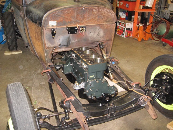

  25. [​IMG] One more piece to the puzzle! I'll have to shave a small portion of the fins as I'm running original A rods (timing)
  26. Cool! Throw a B distributor on it and don't worry about it :)
