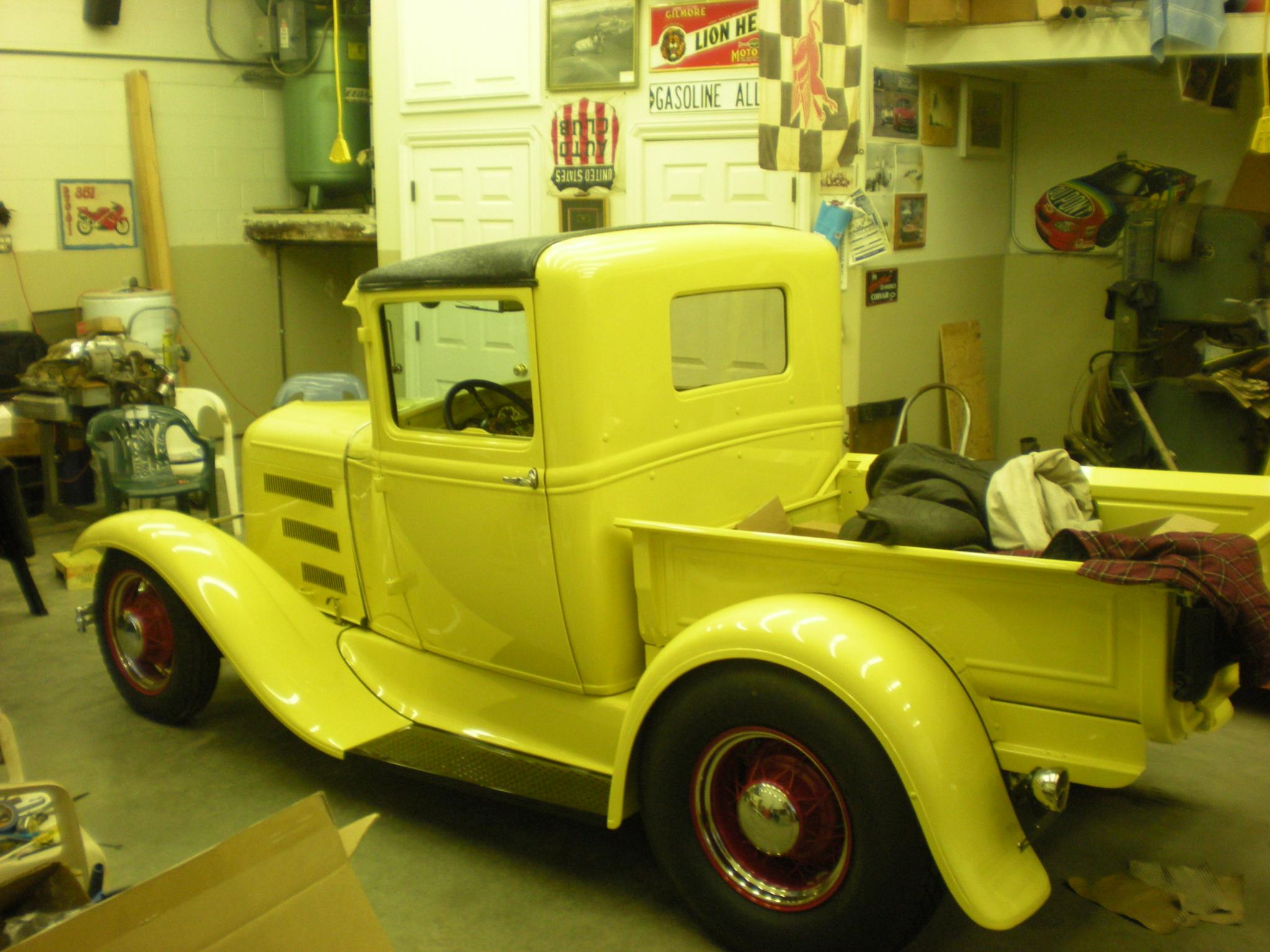

    I've been helping my dad get his truck finished in time for the Pancake breakfast at the end of this month. We got ot running today:

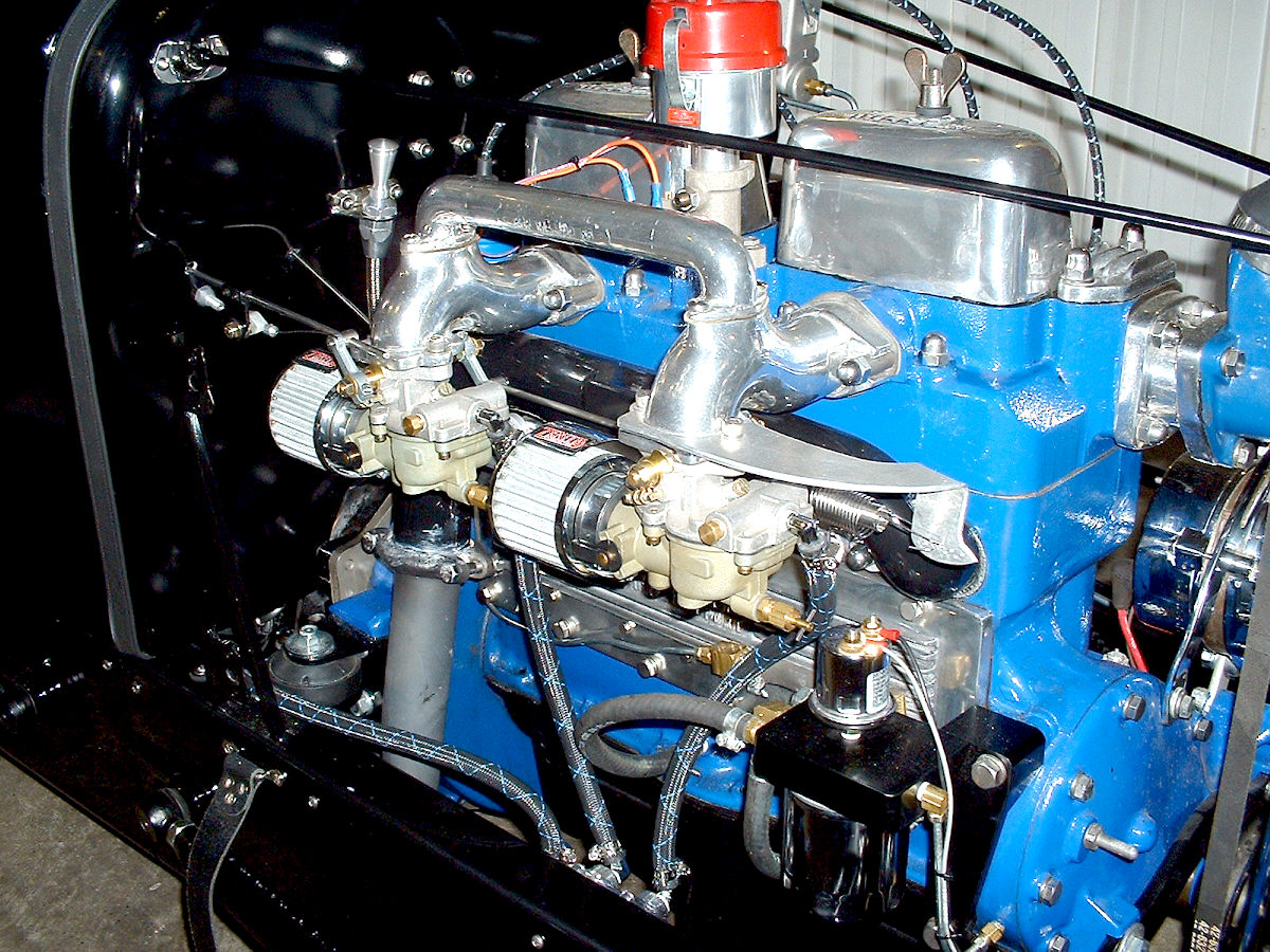

  5. DAMN!!!!!! Dan. Pretty psychotic in a good way. I like the whole set-up. Late 31 Steel top, Model B shell, (3) 97 set-up, over-head. Amazing bang-er Porn.-Weeks

    Sweet daddyo ...very sweet

    Hi crazy I really like that love the sound comming out the back really wanting to get back onto mine just have to complete earthquake cleanup first are you guys still useing the mag on the sidedrive? and I wish I had that much room for headers {our steering is on the other side] great effort nice car

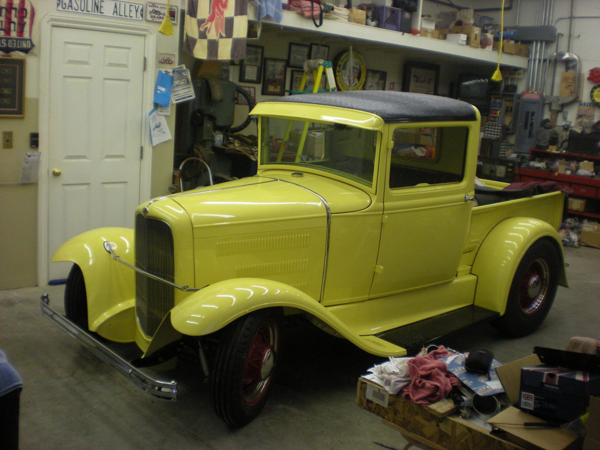

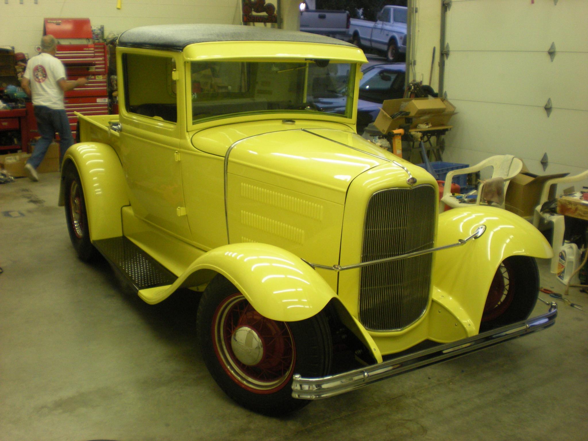

    We got the rest of the sheet metal on today.
    Head lights an license plates and it is ready for a test drive.
  9. Sounds awesome
    Thats a Crazy pickup, Crazydaddyo's daddyo has :D

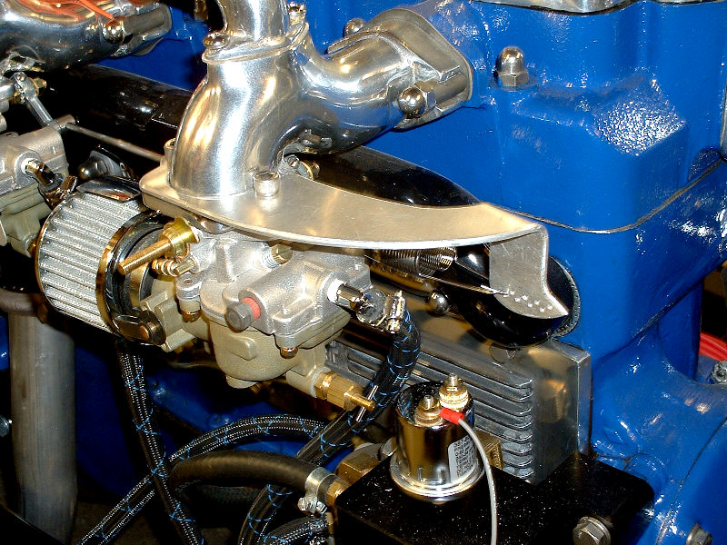

  11. New to me, nothing about something like that in Dan Iandola's book. Looks like a setup for dual updrafts.
    I will expand on my comment. There were/are a lot of innovators out there. There is a photo of a 2 port head that was modified for dual plugs and at first glance looks to be as cast but the extra spark plug holes were welded in.

    From the main board:
  13. Really neet idea, but I wouldn't want to be anywhere near it if something let loose...
