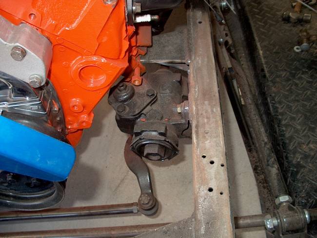

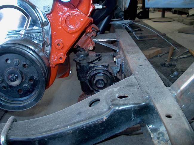

  3. Here's a couple pics of a Saginaw steering box in a 29 A.
    A little larger than a Vega, but it fits ok.
    Not sure what GM car it's out of, something along the lines of an 80's era Camaro or similar.
    Take note of the "S" curve in the pitman arm.
    Pay close attention to which way the pitman arm swings when the input shaft is turned.
    There's a very similar steering box that steers backwards from this one.
    I'm guessing the different steering boxes are for a front steer or rear steer car.
    Since it comes out of a car that' a few hundred pounds heavier than a Shoebox it should be usable.
    Along those same lines it looks like it would have more clearance than a Shoebox steering box.
    And I'm taking it your Shoebox is a Ford.
