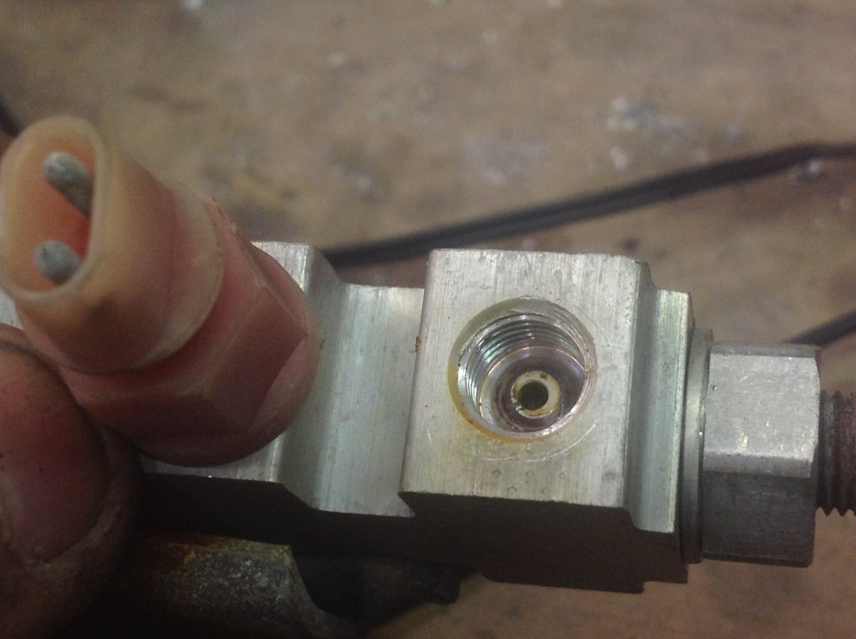

    I dont think Alu. is the right material, why do factorys use BRA$$ when aluminum is so much cheaper???
  9. Vicky with a hemi has a good idea.
    tell you what I'd do, I would get a store bought union to join the two brake lines and then drill out the aluminum block and press in the union after I cut the outside of the union round.
  10. There are aluminum master cylinders, calipers, and aluminum ABS units and who knows what else I haven't seen

  11. Seems to me that some of the early Ford dual master cylinders had pressed in buttons like the one pictured above. I'm pretty sure they are brass. Drill, tap, press in little round thingy, done.

    And those usually are coated/anodized for hardness and wear and the aluminum Masters are somtimes sleeved with SS. Unless you are friends with the anodizer theres a $75 minimum

  13. what is stronger, aluminum or brass threads? dreracecar got me thinking, if the threads are coated, will just plain aluminum strong enough? We all know brass fittings hold up.

    Haven’t read the whole thread but have you considered installing a STEEL insert with the needed thread design?
