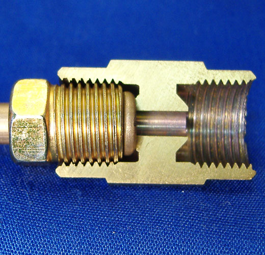

    Im getting some answers and a few maybes...here is a cross-cut for all interested in the 3/8-24 inverted flare hole im tring to reproduce.

  3. Just tap to the bottom of the hole. Remember the inverted flare is in the bottom of the hole, so the threads aren't either.
    Or see above.

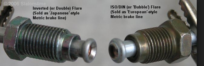

  9. Why does she have to be inverted flair ?
    Can you use an iso bubble flair? Easy to machine and easy to flair and they dont leak,
    The fitting is a little different but once it's installed you can't tell.
    Iso bubble is used in metric applications.
    Very easy to do, my little sister could do them in a drill press

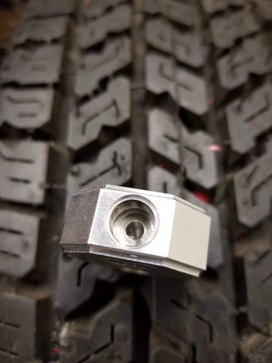

    No the part is not for looks although it would clean up the area very nice...I called TriStarEng.com and that is the price i was quoted...Around 400.00 for the tool...I did not think it would be that big of a deal to make this...Yes there are other ways i could plumb the car...At this time I
    am still looking into making this block...There are tons of aluminum blocks online most are milled over-seas...The layout will not work for what im doing...Someone in The States has to have a J512 type tool to do this...As i did not know MilHouse...He posted in 2010 he was looking for the same tool....I know many have asked what will the block look like...I will post a pictue later.
