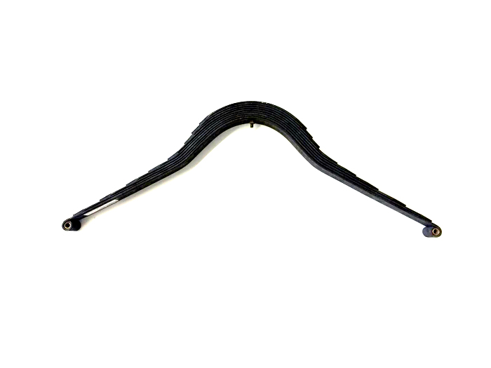

    Hi Ron,
    When you used the T spring in the rear was it the bottom 5 T leaves and the top A leaf or every second T spring? I'm looking to do this to my coupe next week after having the eyes reversed.
    Thanks
    Josh
  6. Ron Brown
    Joined: Jul 6, 2015
    Posts: 1,717
    Ron Brown
    On the rear the only A spring is the small one at the top of the stack...all the rest are T springs. The A spring is .25" wider so I used the top leaf to help center the springs in the spring pocket...you will also see this one leaf is tapered slightly from side to side to fit the contour of the spring pocket.

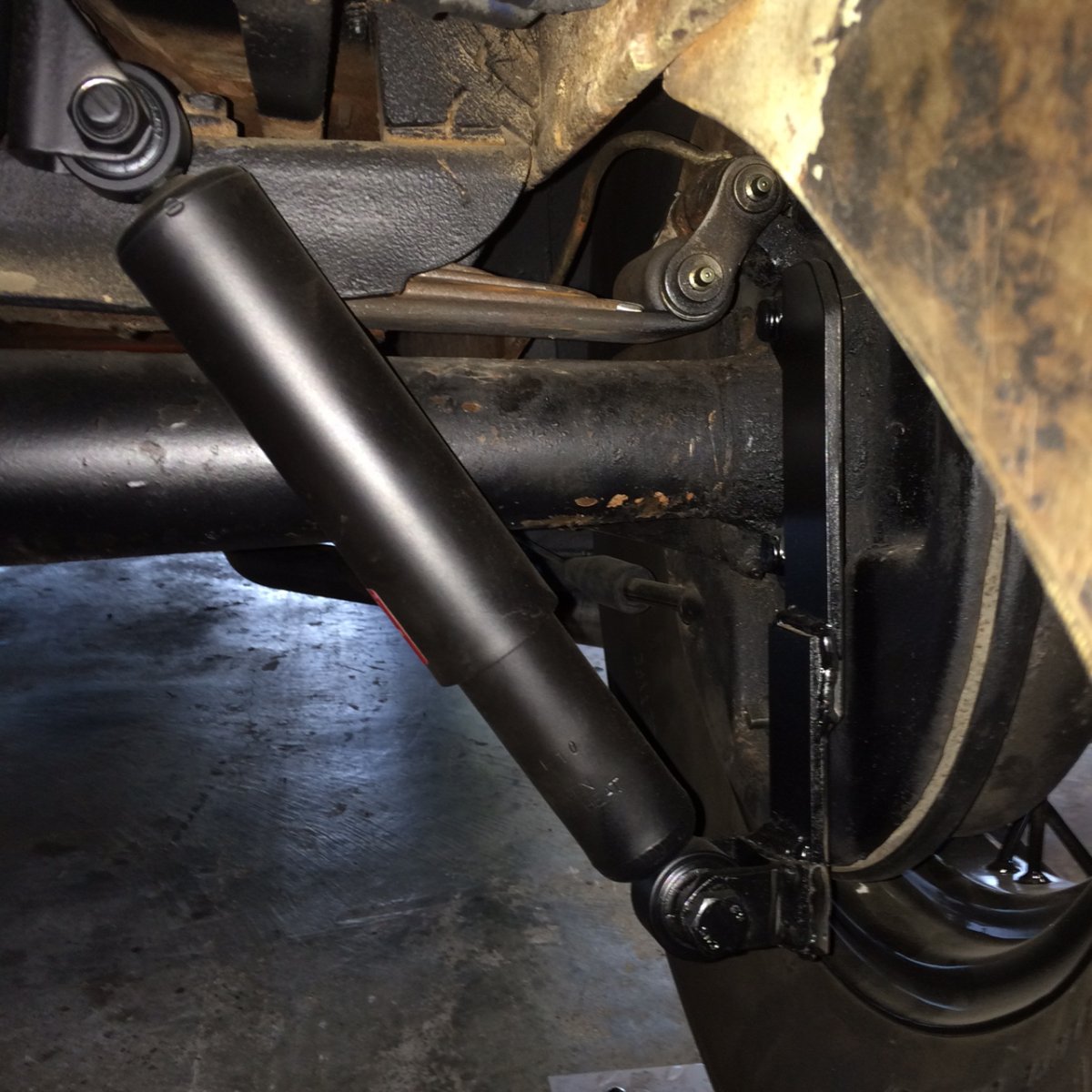

    I think maybe he was seeing the photos/notes about the lower rear shock mounts.

  21. Ron Brown
    Joined: Jul 6, 2015
    Posts: 1,717
    Ron Brown
    Actually I took the leaves I didn't use, cut them off about 3" on each side of the center bolt hole and reinstalled them UNDER the main leaf. So the leaf pack is the same thickness as original at the ubolts. So I have one A leaf (first and shortest leaf), four or five T leafs (forgot how many for sure, go back to start of thread) and a T main leaf with reversed eye, and three cut off leafs ( about 6" long) below the main leaf. All bolted together with the center bolt. This worked both front and rear.

    So not to be dense but How many leaves, total, do you mean when you say 5. You've said five plus the small one on top and you've said you only removed three leaves... which with the stock spring packs I've had would leave you with seven leaves total.
    I took that to be what you meant originally, main leaf + 5 + very top spring. But I did that with my sedan and even though it's probably 700 pounds of interior lighter than yours. As it's still just kinda mocked up, it's quite a bit taller than I expected.
    If you had five leaves total I would need to pull two more which would obviously drop is some more. Just looking for some clarity.
