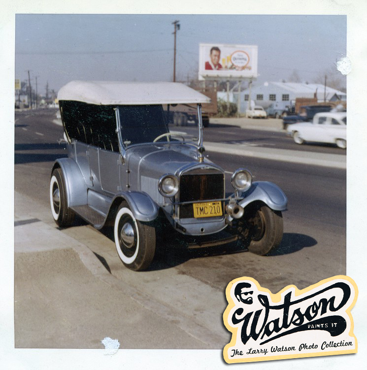

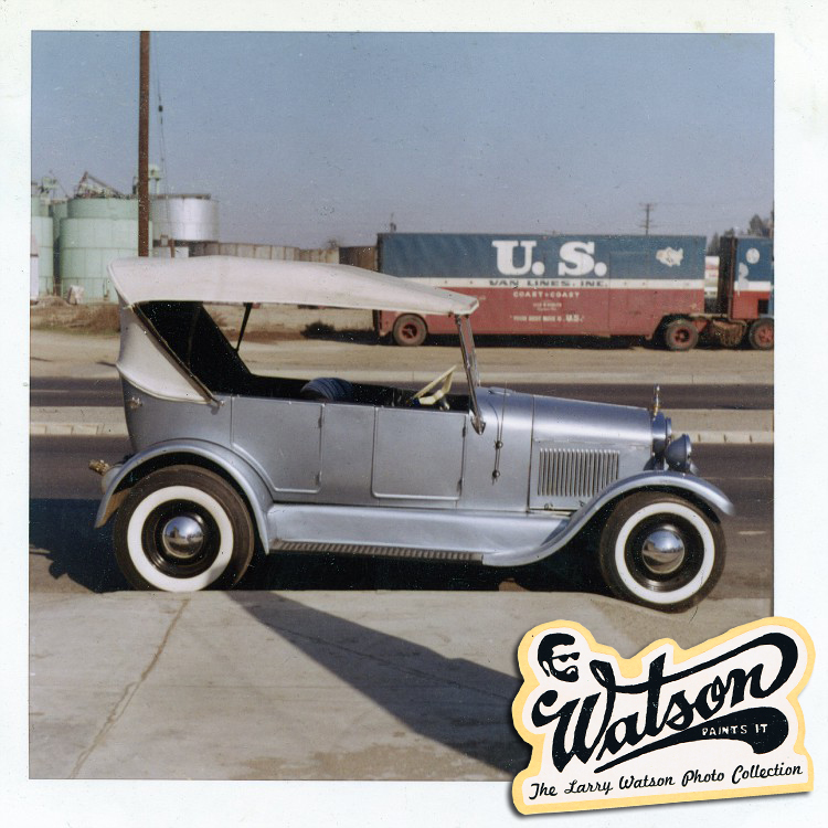

    I have a beautiful '26-27 touring body stashed away and access to nice fenders. I have the hood, grill windshield, even a decent stock interior. Would like to build something like this:
    Who out there builds a new boxed frame that would be a suitable foundation? Not interested in playing with a stock T frame and most of what I have found is T-bucket stuff. Would probably use a small OHV 4 cylinder, maybe a Chevy II or MGB?
