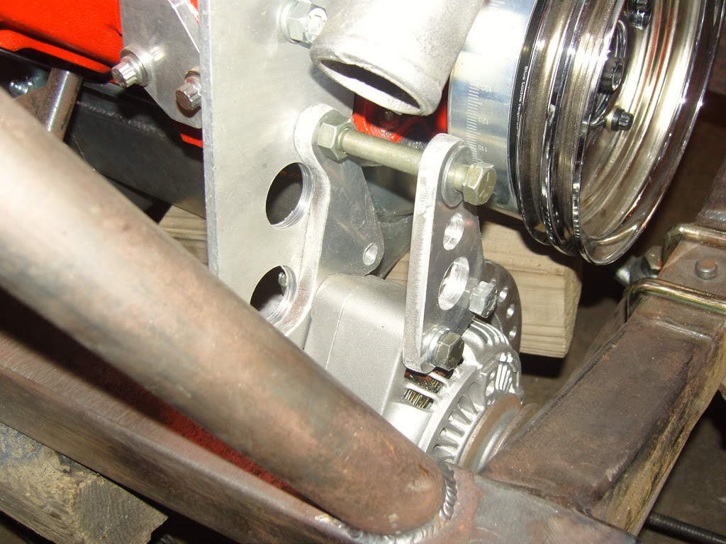

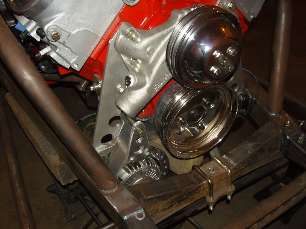

    This is a Denso 50 amp with a short water pump. Homemade brackets are just a long 3/8 stud with spacer in the head. The stud has a support to a pump bolt and also a turnbuckle adjuster to the pump. It was around $85 on EBAY. Easy install with a one wire system.

    thats perfect....

    I bought this alternator, looks great. Now to build that bracket. Thanks for the suggestions.
