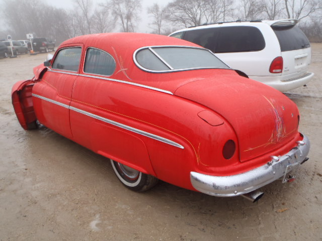

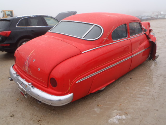

    Just looking for opinions...
  2. Need better pics of the upper cowl and the right side where damage ends and good begins. Obviously front clip (both frame and sheetmetal) is gone, but how bad is the main body/frame past just that clip?

    More photos

    The passenger door opens and closes, we can tell that from the pics. Frame is fucked and will need a whole front clip, but otherwise looks like a pretty nice coupe body. Interior looks fair. Glass looks intact. Drivetrain is a total unknown, very possibly some mounts broken off, rendering engine and trans useless.
    You'll want a 4 door donor to give up a good frame and front clip and you'll have to put a drivetrain in it. Still, it's a nice coupe body, I think anything under $5K would be reasonable.
    If it's full of mud or something we can't see from the pics, that would make a huge difference.

    looks like roof buckled, door over lapping body....parts only..... If you cant get it for a few hundred then walk away....its parts.

    Doubt it'll sell for only a few hundred, but don't have any idea what it's worth. Shame it got hit that hard. I'd crawl all over it, and especially under it. I don't see roof damage with my bad eyes, but I'm wondering about the cracked filler. Maybe that's just from the hard hit, without any additional movement of the roof. Hell, the doors still fit better than on any Merc I've ever had.

    If you're any kind of bodyman, it can be fixed, but if you gotta pay to play, big bucks. BUT, this seems to be a pretty nice car, looks like a decent build to begin with, the crack in the filler above the door is a concern, how much filler is in the roof? The fact that both doors open is a bonus.

  11. The cracked bondo on the roof doesn't bother me too much; a car will flex in a lot of places under impact then spring right back. I had one car that if you jacked up the rear with the factory bumper jack, the quarter panel opposite the jack would get big waves in it. Let the car down, they would disappear...
    I'd look at the door fit closely; if the door hinge posts/firewall/cowl has been pushed back on either/both sides, that will be tough to pull back, but not impossible. The fact that the passenger door opens is a good thing. The frame is probably toast. Engine, worse case you have to short-block it and replace the front dress/exhaust; make sure you check for crankshaft damage. Trans, if the case isn't cracked/broken at the bell or rear mount, it's probably ok.
    This is better than a parts car if the body shell isn't a bondoed-over rusty mess and the cowl doesn't need pulling out, but still a project. Seeing that rusted out POS Mercs are selling for pretty good money, if the main shell is good it's worth $5K IMO, but I'd sure look it over close. If you're looking to do a flip, I'd walk away.
  12. That second set of pics has me walking away. Can it be fixed? Sure, anything can, but that body is in a lot worse shape than I think a few of these guys are seeing.

    The crack in the roof would'nt be my biggest fear.

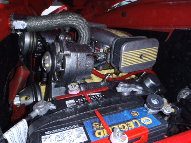

    If i was to buy a car like this, my focus would be on shape of frame, shape of cowl and how does the gearbox/transmission look.
    Is that a auto with a floor shifter for a manual look or a 4 on the floor.
    Steering wheel and coloum pulls the price down ;-)

    The car appears to have been hit hard...but the good thing is it was more from the side than head on. Likely less body distortion and cowl damage from that angle. Still, as others have pointed out, there are many unknowns. Also, I expect you will end up with a Branded Title (aka "Rebuilt" or "Salvage"). That is not as big a detriment on this as a late model automobile, but still less than ideal. And in Illinois where I live, the cost of returning a salvage vehicle to titled status is expensive and time consuming and detailed receipts are required. Also, only a licensed "Rebuilder" can process the paperwork. It is worth checking your State's regulations on those issues before you dive into a project like this.

    The filled drip rails (on a non-choped car) would scare me more than the wreck. Why would they do that? Probably because they rusted too badly. Probably a lot of other rust "fixes" as well. And you always need to be wary of other guys rust fixes.
    Crawl all over the car to look for patches. If none, then the whole car can be put on a rack and pulled reasonably straight for a few grand. Then get a fordor for a chassis swap and new clip. All together you'd have a straight car needing engine and paint for under $10,000.
