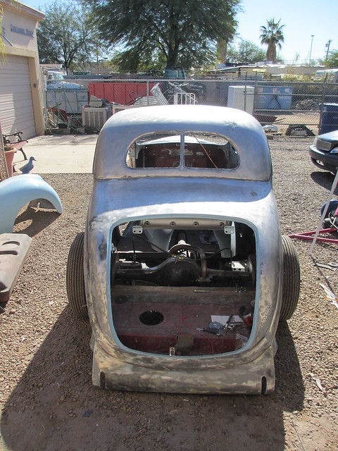

    I am starting a new build thread for my 37 Ford. I think most people remember the last build thread and perhaps were wondering why it suddenly stopped being updated. To keep it simple I was incredibly frustrated with the shop and work being done, not to mention the constant misinformation and sluggish build pace. I borrowed a trailer and went and pulled my car from the shop. I eventually dropped it off at another shop who is now in the process of cutting off everything done before and redoing it so it functions correctly. After more than a year of the car being not running I am looking to address the faulty suspension first and then move onto getting the car in a running an driving state after which point I will address all of the paint problems the car has.
    Here is how you last saw the car sitting at the other shop and me in the background starring at it wondering if it would ever drive again at this pace.

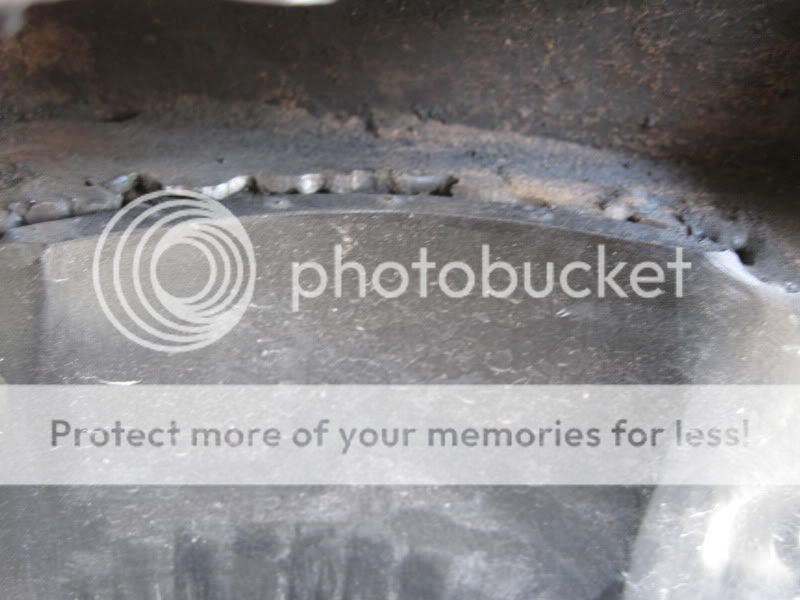

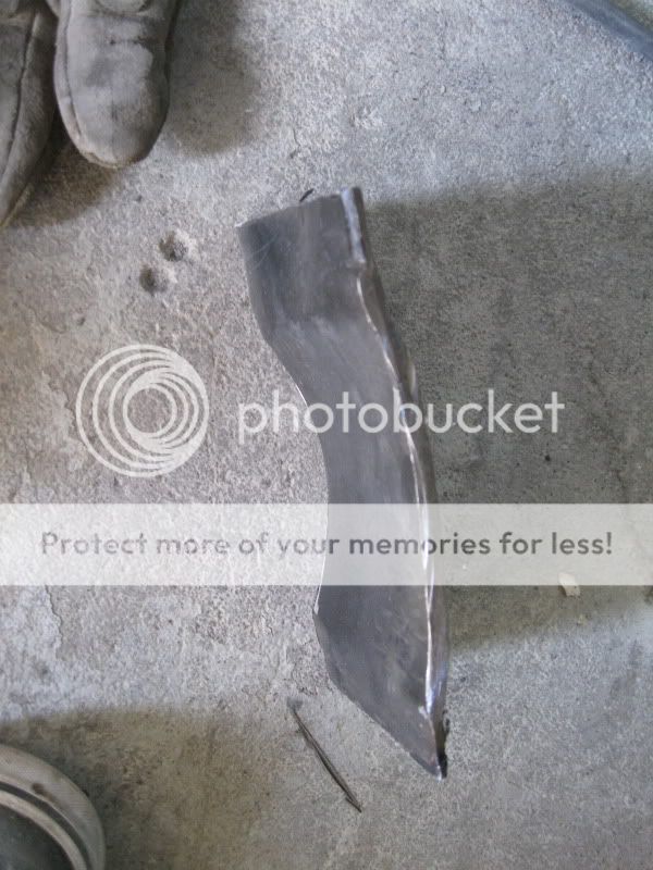

    First to go under the knife was the rear suspension. I took the car over to my friends at BSG Customs where they cut out all of the rear bag setup and started all over again. Here is a picture of everything cut out and the start of the new rear end. A full drive shaft hoop was added to start things off.
    while cutting the old setup away the new builder showed me somethign interesting. As you can see the entire old bridge set up was built out of .120 wall HREW, not .250 DOM as previously stated.

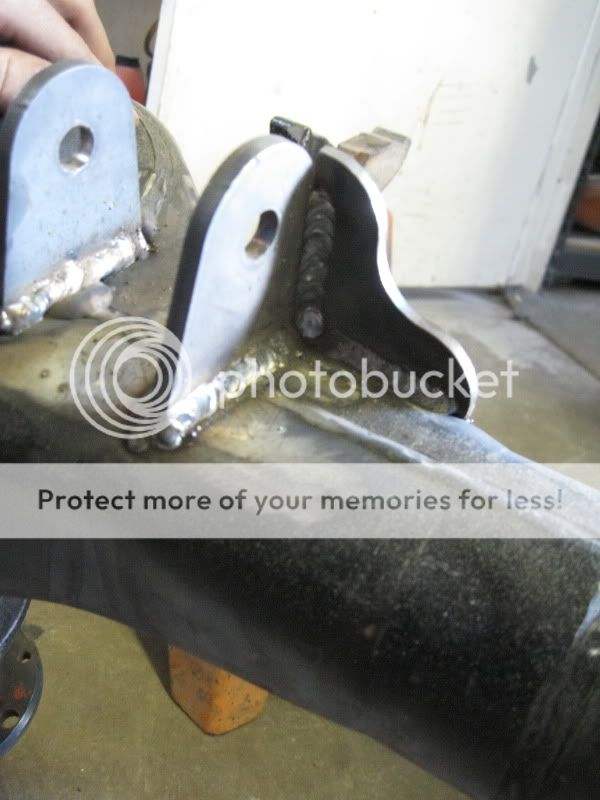

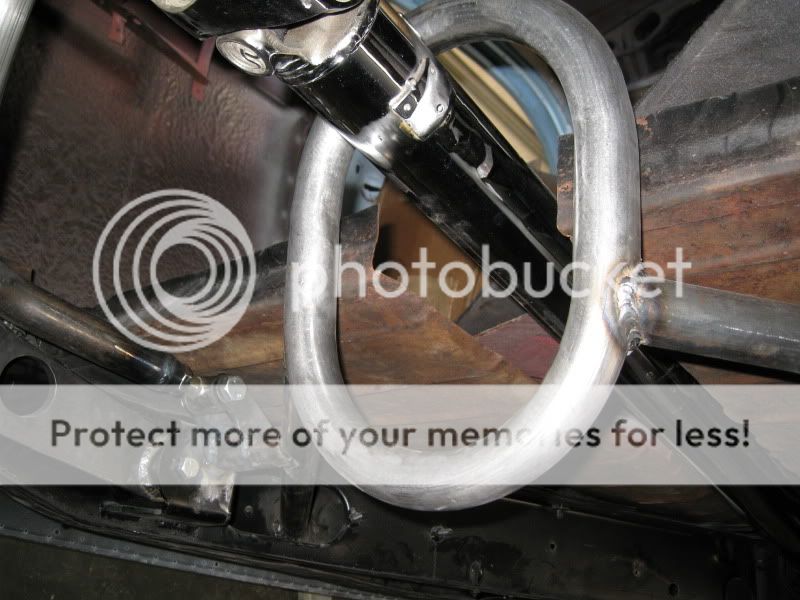

    Here is the current state of the rear end. Lower arms made from 1/2" steel with "real" .250 wall DOM tigged in for the bag bolt access. These arms measure 27" eye to eye, an inch shorter than the previous bars which pushed the rear end too far back, both visually where the tires were in the wheel well and also where the drive shaft met the output shaft.
    In order to get the "geometry" correct this time around Pat designed a sick looking, and functional over under wish bone. New bag plates were also added to the frame.

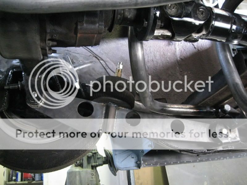

    What you see here is all mock up, there are a number of custom gussets for the wishbone that will be going on this week and the new shock mounts will be on the lower arms. Unlike last time the suspension functions quite nicely this time, a giant relief to me personally. There will be videos of a full cycle soon!

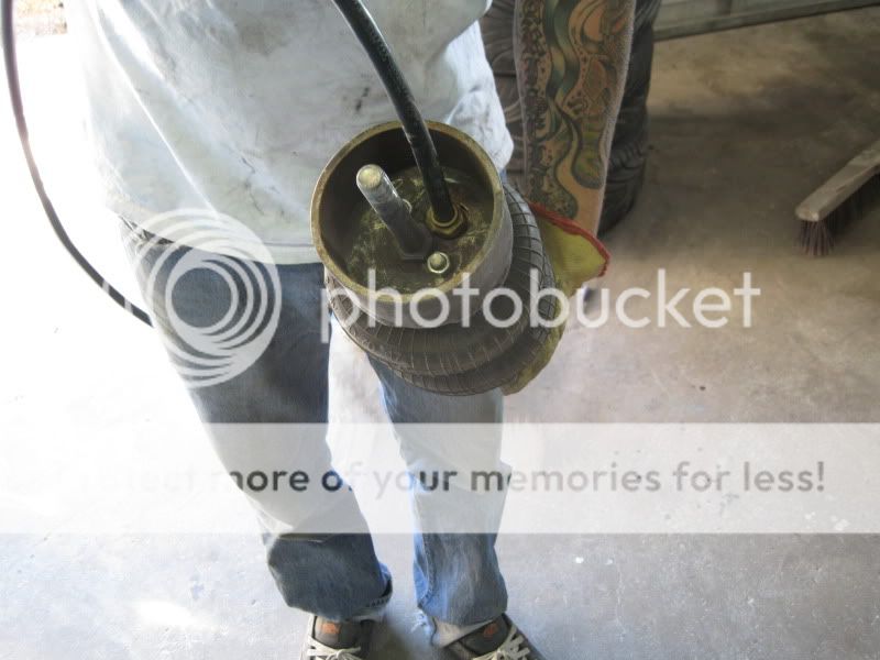

    as you could see from the pictures posted the front was pretty amateur looking and functioned even worse than it looked. So Pat over at BSG just cut it all off.
    He added a much more significant point of recess for the bag to breathe in and also added a good deal of support to the frame and mustang two upper arm mounts. In lieu of a recycled bolt in bag cup he added a bag mount to the frame itself and , gasp, welded it in.
    and some pictures of it laid out. Aside from looking cleaner and being safer, I would have to say my favorite feature it is not rubbing the bag on anything.
