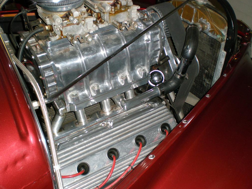

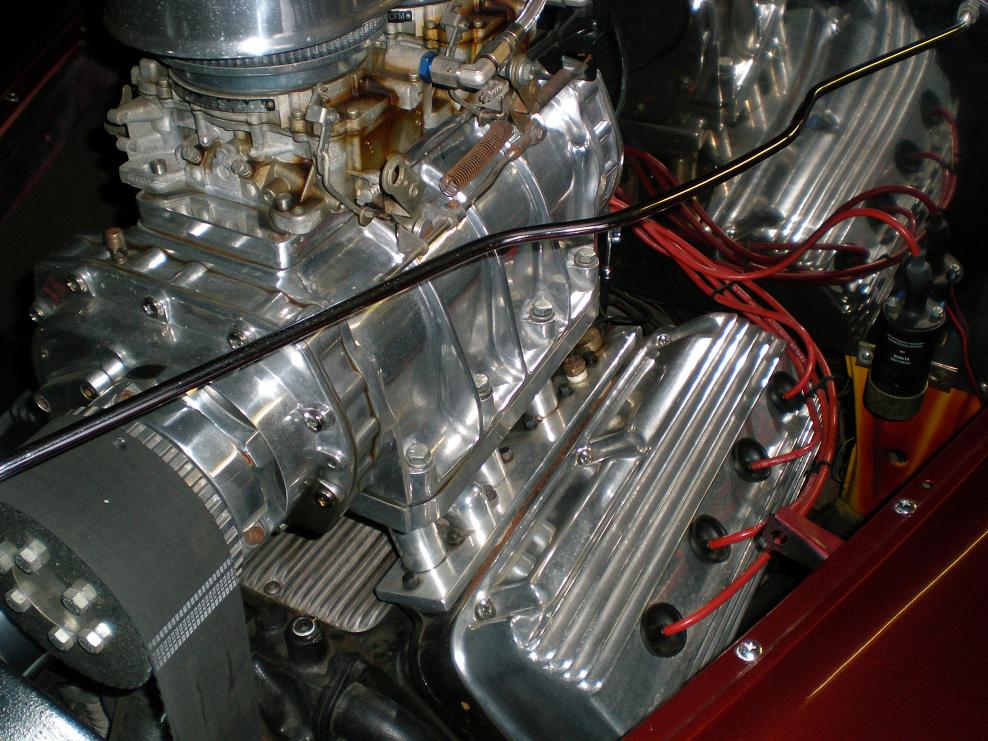

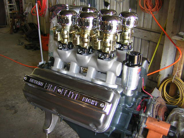

    Here's mine. Sorry no blower!:cool:

    Mr Ford thats one nice Fireflite !! Thats an Eelco 6x2 and a Joe hunt elec conv mag "look" dissy yah?

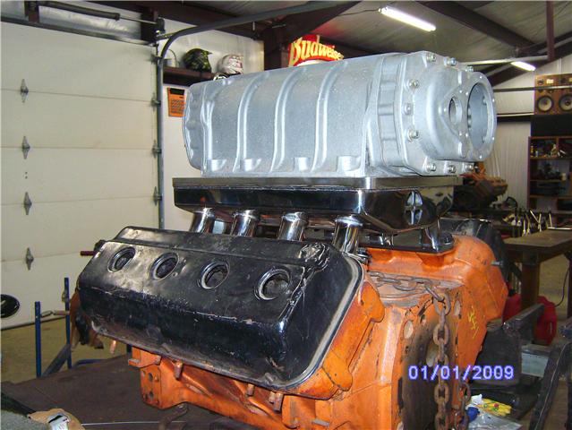

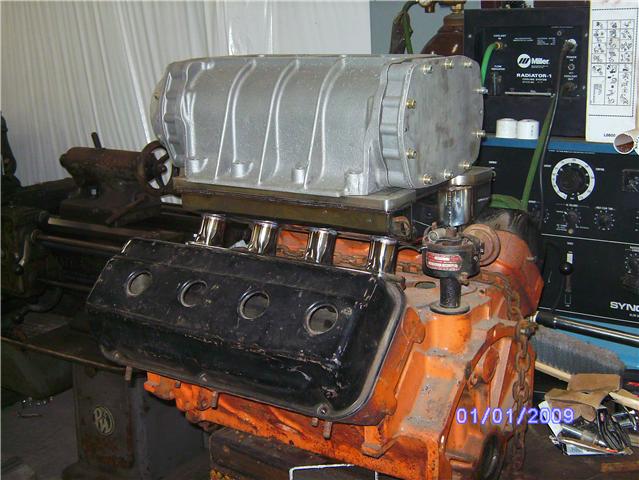

    i build fabricated blower intakes for tall and short deck desoto hemis or any engine for that [email protected]

    back view...
