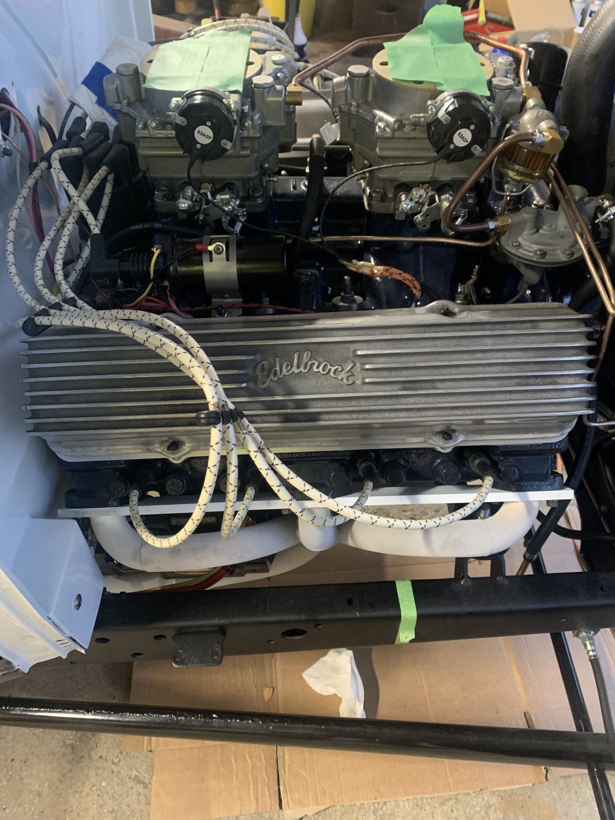

    Does anyone know if there’s a difference among harmonic balancers? I have my 54 with a 54 balancer but I am using a 58 timing cover for the rubber seal and the rivet on the backside just kisses the timing cover. I had a little machined off the rivets so I’m hoping it gives me enough clearance but if not

    I had that same problem and the engine shop had to make a spacer. It was just barely touching. I’ve got a 331 block with a 390 crank and not sure which balancer I used.

    I ended up having my machinist take a little off of the rivets and that was enough for clearance

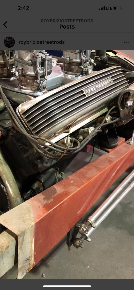

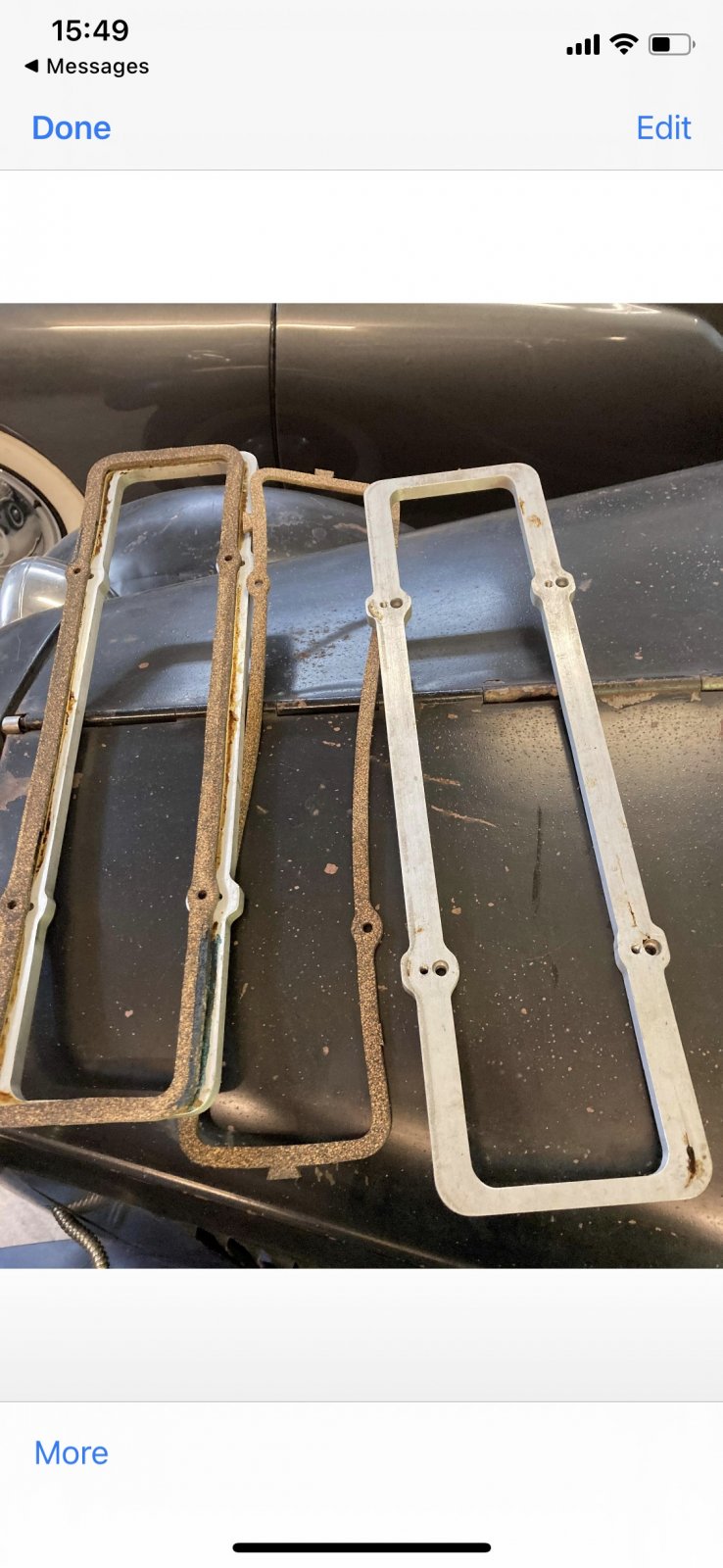

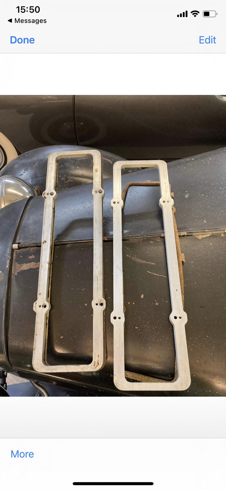

    I am looking for a set of spacers like this to move the valve cover closer to the intake and clear my adjustable rockers. They would most likely be homeade. If anyone knows of someone who has a set or if anyone would be interested in trying to get a group buy together. The pictures motor is from the kookie car

    I actually spoke to him today and he’s going to prototype a set that moves them up closer to the intake so us guys with adjustable rockers can run whatever valve covers we want. On my engine personally and I’m sure many more moving them out has not helped, it just changed where they hit on the valve cover so i will be the test dummy for the new set

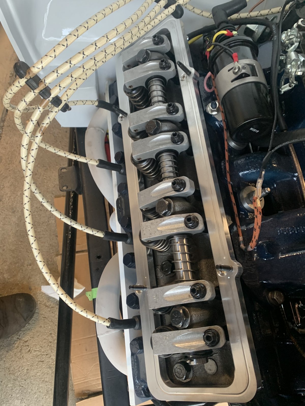

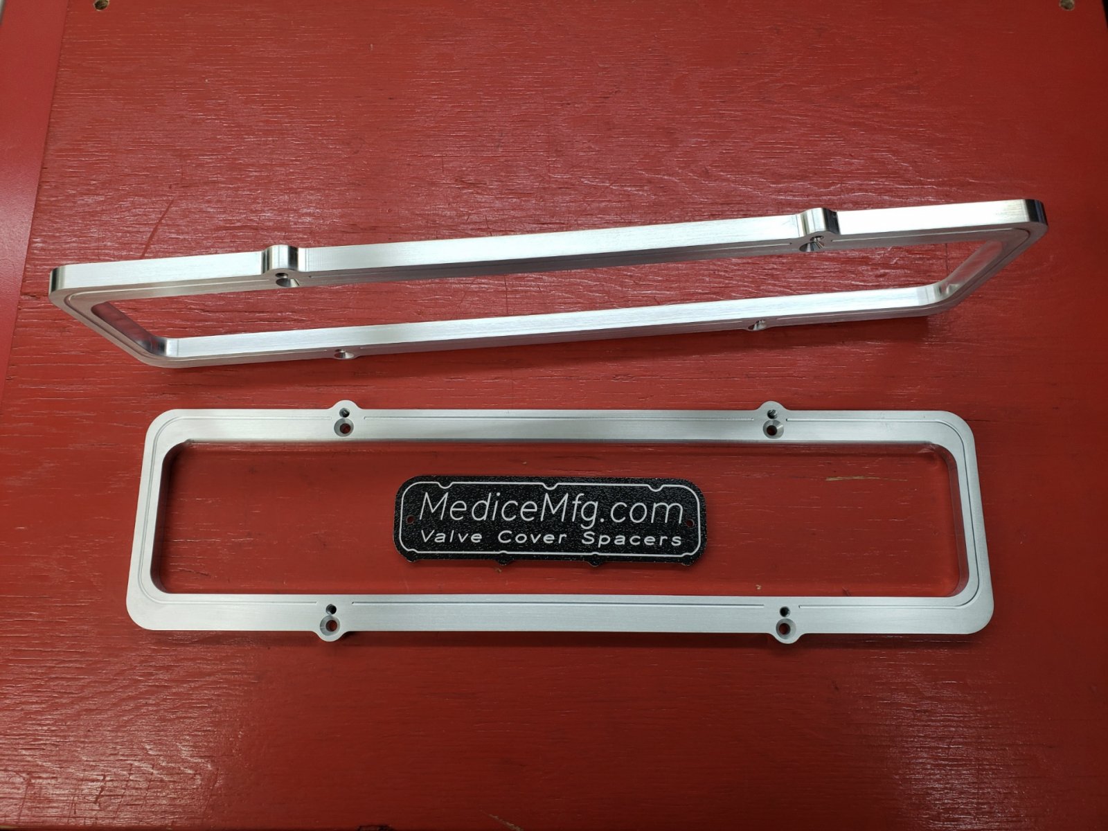

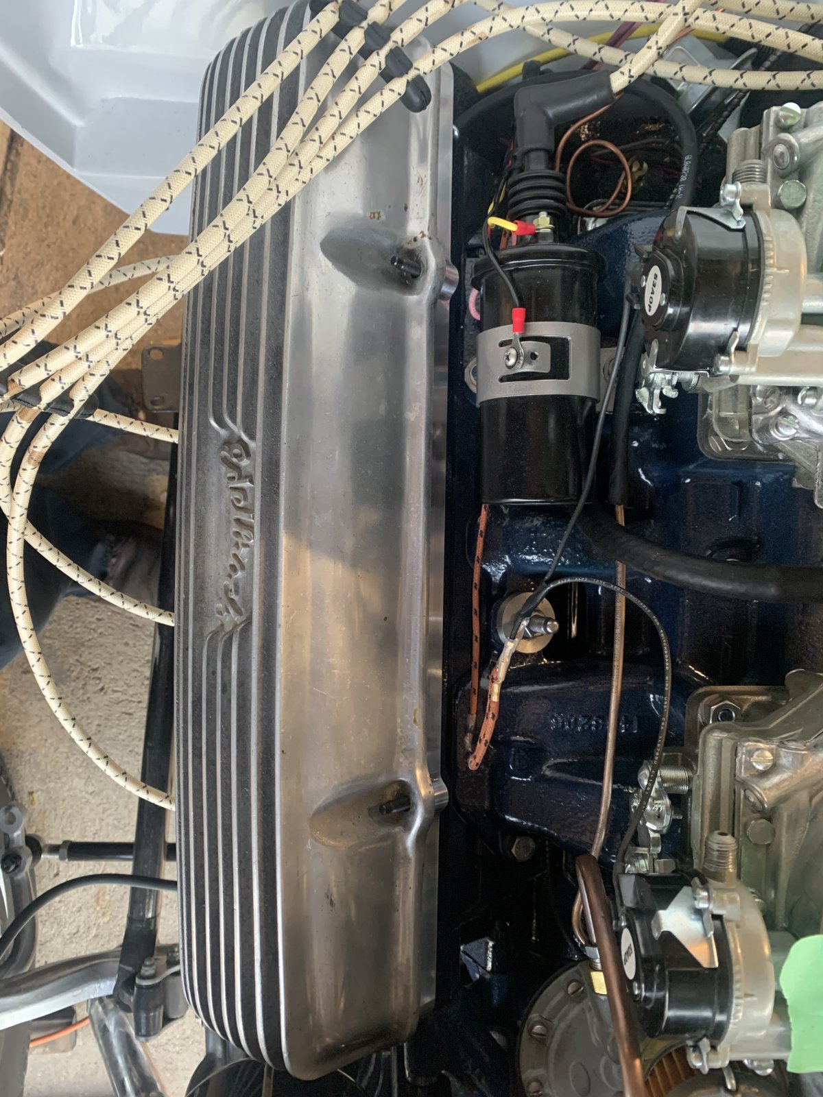

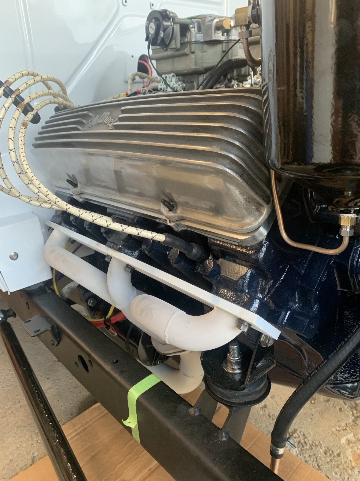

    I have great news and a huge appreciation post that probably should be it’s own thread. I have worked with Dan from medice mfg on making a spacer for us caddy guys to adequately clear adjustable rockers. These spacers slide the covers closer to the intake instead of out like traditional spacers which wouldn’t work for us caddy guys. I received them today and I am super happy/excited to get back into my build and dial in the motor now without the rockers hitting the covers. Dan is a one man band who makes these spacers in his backyard machine shop in Pennsylvania. I was tired of getting the run around from the internet world on figuring this out and he was the first guy who was willing to work with me until we got it right and completely perfect. I now don’t have to try and locate a set of dimpled covers and can run whatever valve covers I want. Hopefully within the next week or so I’ll have a solid running video of my car to post for you all the enjoy. Dans website is https://medicemfg.com/ and like I said he is very responsive through the phone and now has the program available to make these for whoever whenever with a wonderful turn around. Please excuse my dirty engine bay, before the spacers we had the covers on and off a million times trying to figure out a solution so she’s in need of a good clean up. If anyone would like any other pictures I can send whatever. These are just mocked up I haven’t glued them down yet. But I have plenty of clearance now

    Glad it worked out. I have watched his stuff on eBay and planned on buying a set. Now that I know they will clear, it’s a done deal.

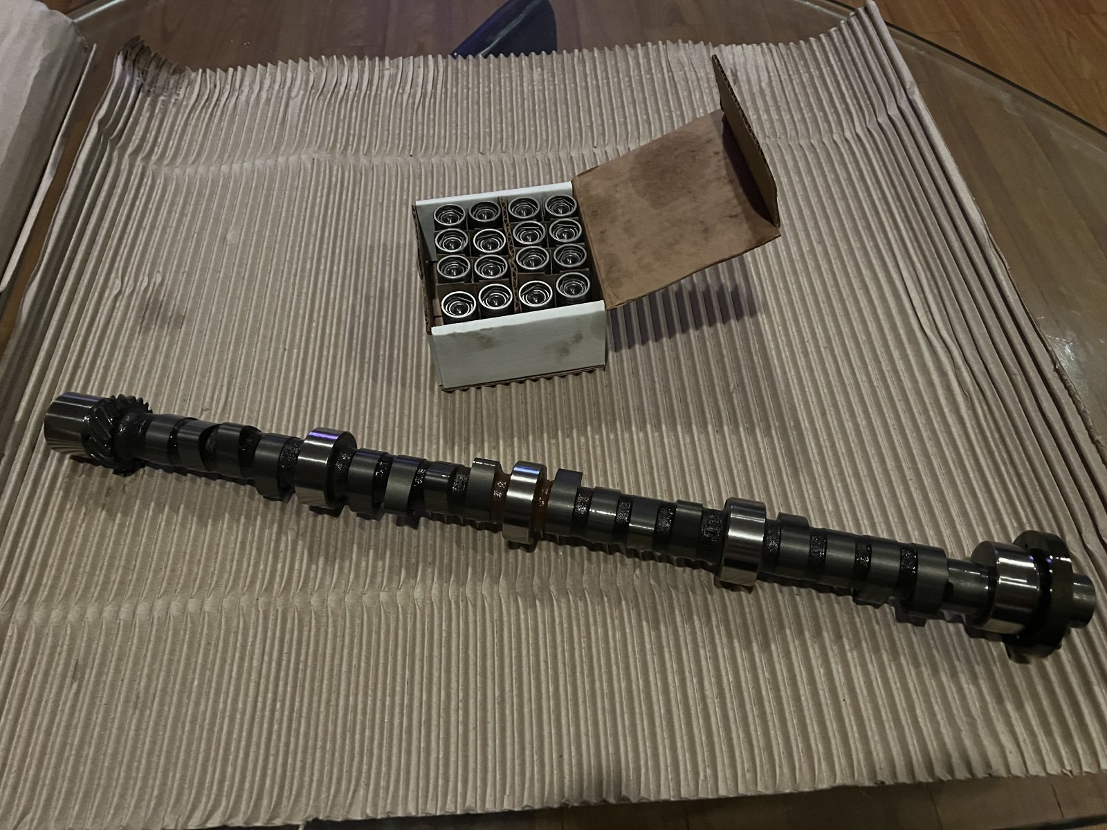

    Got some goodies in the mail today. Gets the juices flowing. Still waiting on pistons though.

    Originally, I had planned to go with the Isky 270HL because it was readily available.
    However, when I went to order it, everyone was out of stock.
    So I ended up going with the Schneider 140H.

    Keep in mind that Cadillac uses a 1.6:1 rocker, so your numbers will increase a tad. Your lift will be more like .480".

    Yes, I am aware, but thanks for mentioning it just in case. I found it strange that they based it on a 1:5 ratio.
    I spoke with my machinist before I ordered it, and I dropped the cam off to him on Tuesday, so he can do his thing.
