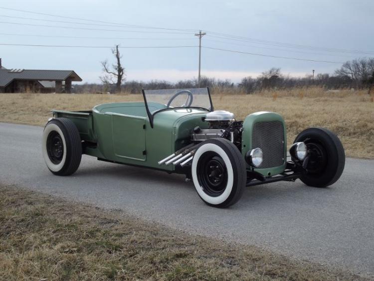

    Okay, mines coming along nicely but not done yet. Chassis is currently blown apart, final welding finished, prepping for paint underway. BUT, since you asked I'll post another. Took this shot a few months ago.

    daddio211
    Thanks Anderson!!! Your car is too bitchin' brother!

  16. It often depends alot on camera angle and position that gives a slightly distorted look. If your too close it doesn't matter how low the shell is it still looks wrong but move away and change camera angle and it can look perfect. Unfortunately you cant always do that with your eyes:confused:o_O

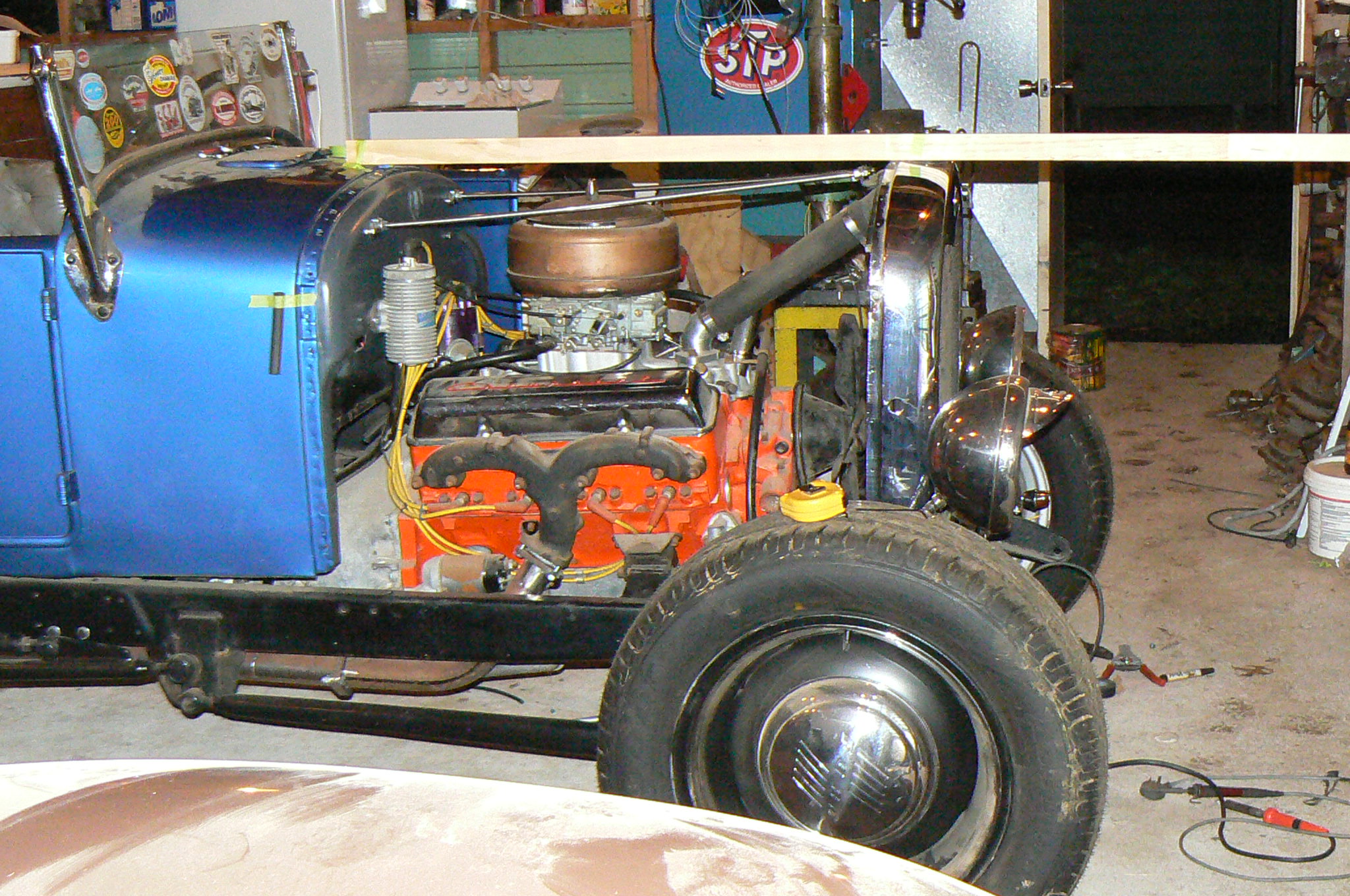

    shell 2.jpg I think it can be done where it looks good. I have cut 1 1/2" out of the height of mine to make it the proper height and I think it will look good. shell 1.jpg

    I love your pickup brother, but in my mind that grill needs to lose a few inches and the headlights need to come down correspondingly. That's just me, don't change it for me. The overall "flow" would improve significantly in my eye. You may get away with an easier mod though by mounting the front of your radiator support rods lower on the radiator. They have so much "uphill" look to them that it confuses the eye and makes the radiator look taller than it is. At least in this photo. I'd never noticed it before.

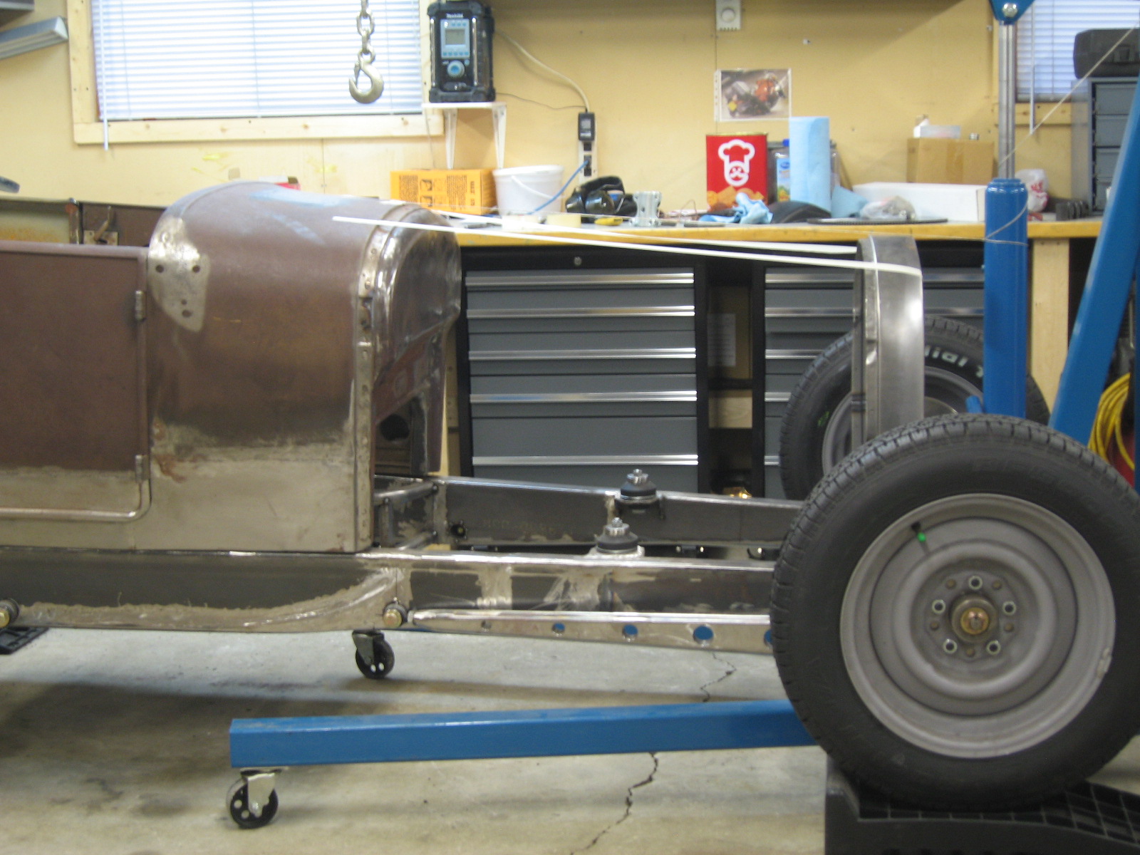

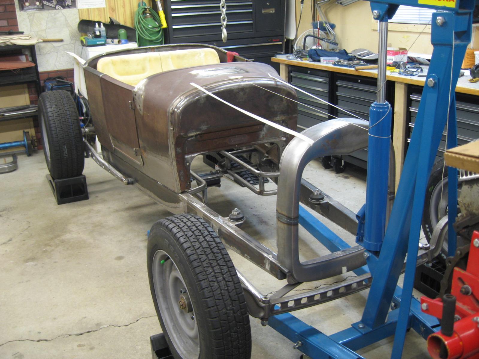

  23. I agree with the shell looking high but its only about 3/4 ''. I have to get the bottom tank turned around so I can have the lower radiator hose in the correct place for the SB Chev so I'm going to see if it can be lowered on the mounts. Yes those stay rods do make it look worse than it is and will do something about it later, but that pic doe's make it look way high. Its not a big worry to me as many cars from the fifties were like that and I feel that time has refined our eyes some-what. :D cheers, JW

    I chopped my shell and radiator 2-1/2"
    I used the tape and eyeball method too

  25. Got to thinking on how much I needed to drop the shell. I placed a straight edge on it , use a spirit level and measured down to the chassis, I was surprised to find it was only 1/4''. I can fix that !!
    I believe shinny things tend to look bigger;) JW

    I'm thinking you should reconsider that. If you look at my pictures you will see that I took into consideration the slight downward slope of the T cowl and made it so that the shell was low enough that a hood ( if I used one) would flow in a smooth line from the cowl to the grille shell following that slope of the cowl.
    It looks to me like 1/4" will still leave yours too tall.
  27. I will bring it down more if I can which I believe I can. Cheers Eric And Larry. JW :)

    Having that board there for perspecitive makes a huge difference, I think the hood rods are throwing it off more than anything. I think if the rods were parallel to the frame or angled down just a bit, the grille wouldn't have to come down much and you'd have the look nailed.
    I like your RPU already, a couple tweaks like this would really make it a knockout.
