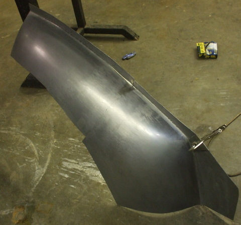

    Here is some junk I have been working on. The quarter panel on my 1964 Cutlass is pretty crusty around the wheel lip. You can see it in the photo. I want to replace it! Everyone will not have some of the tools I used. I am lucky to be taking a panel fabrication class.
    I cut out the part I need to reproduce making sure I am into solid metal so the replacement welds in nice and strong.
    Since it was a pretty complex shape I cut a piece of aluminum and bent it over the part to get the curve and angles right. I used this to verify that my new piece matched.
    Using the template I made I used the shops plasma cutter. It is able to follow the outline of a cutout from paper so I just used the template and made the paper pattern the plasma then follows it and cuts out a identical parts I needed. I welded the parts onto some steel posts so it can be used as dies in this machine. I did a lot of fine tuning and grinding and welding to get the dies to produce a finer part.
    I loaded the dies in the Pullmax and attempted to form the flatter area of the patch. I had to do it freehand but it was really close. After spending some time trying to form it. I realized it could have been done on a radius brake. I felt pretty dumb. But continued working with it anyways. IT ended up being pretty much identical to the original part.
    I moved onto the much harder curved section. Using the original I drew a curve I would need to follow onto a piece of metal. Then back to the Pullmax. By following the line it formed the curve I needed. It still needed a bit of fine tuning since it tapers as it nears the end of the curve. Laying the new part over the old verified just how close I was able to copy the old part.
    Here it is almost finished forming the parts. Now just need to make the last piece and weld it all together. Then I will be able to tip the bottom to a 90. I may have to wait on welding until I learn to TIG weld. Then it will need some trimming and it will be ready to weld into the car.

    I am just starting to use a pulmax.Me and a friend made some dies similar to yours and made some new truck bed sides with them.On our test panel we noticed that the dies were warping the panel.On further inspection of the panel you could see little shrinking tucks on the panel.So we did some more grinding on the dies to take care of the problem.On the real panel there was no warping but it did take 4 passes.

    Next time you see the little tucks form take the panel to the shrinker between passes. It will speed it up and you will make fewer passes.

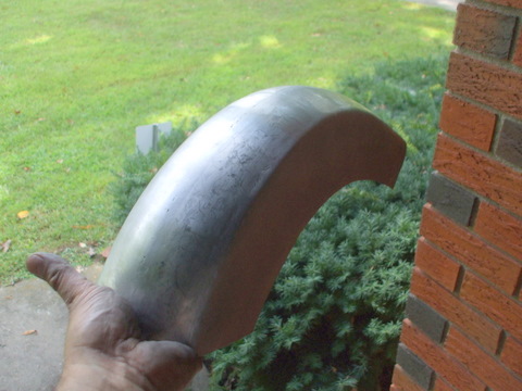

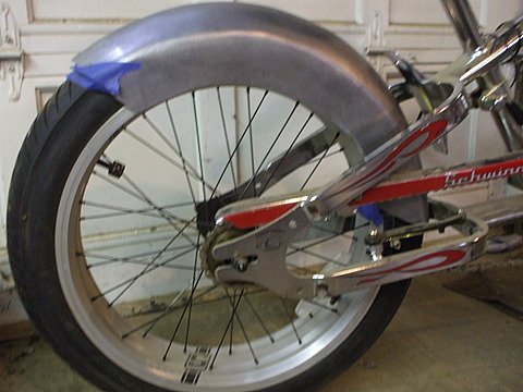

    I'm starting to get into using the pulmax.I shaped the back panel for my fender well with some thumb nail dies and it only took around 5 minutes and it's already almost fitting the pattern.
    Jeff you know I was against using power tools for metal shaping but now with some understanding of how the metal moves and reacts.It is speeding up the progress.
    I still am a true believer that you should learn how to do it by hand first and learn how the metal reacts.
    On my fender well I had it fitting the pattern but the panel wasn't in arrangement.I made the mistake of tipping the flange before I put it into arrangement.It took me most of the day to get it back into arrangement by stretching the flange and and making some contour gauges.The rest was just tugging and pulling.It was like wrestling a bear,but I got it.
