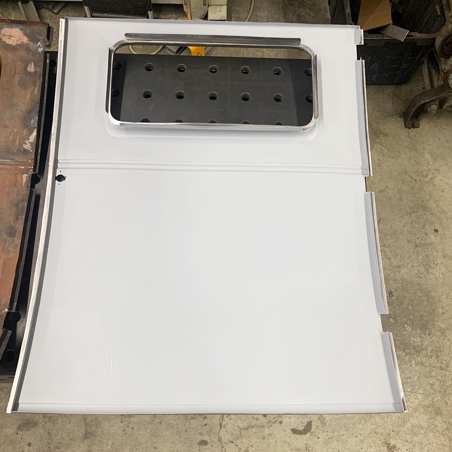

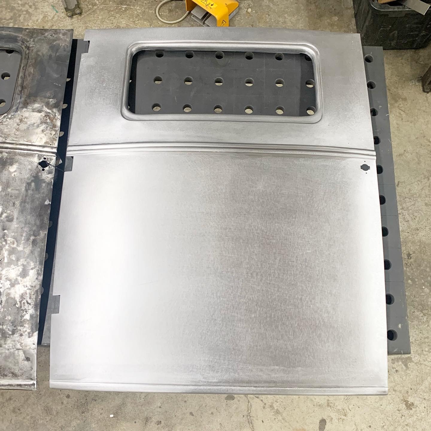

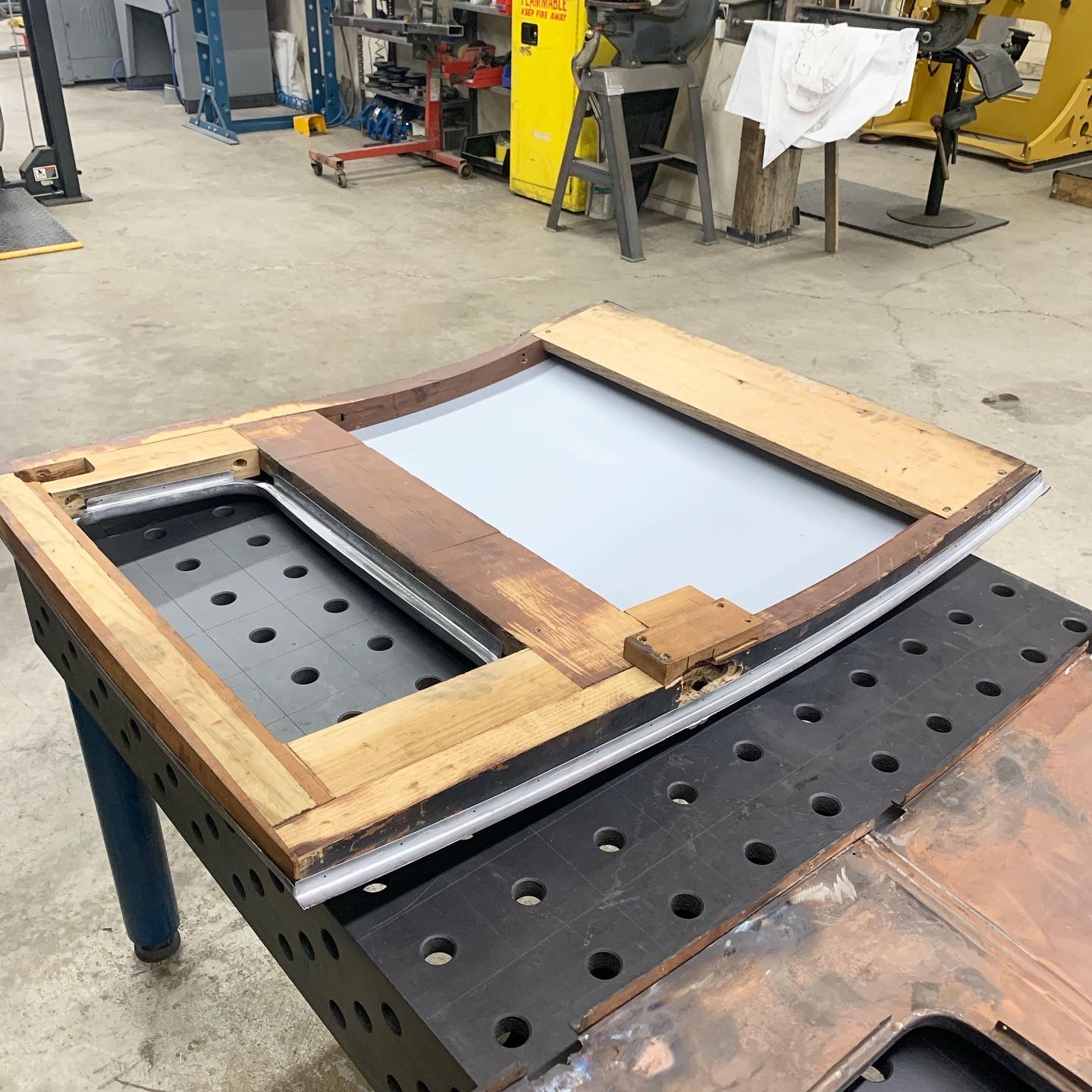

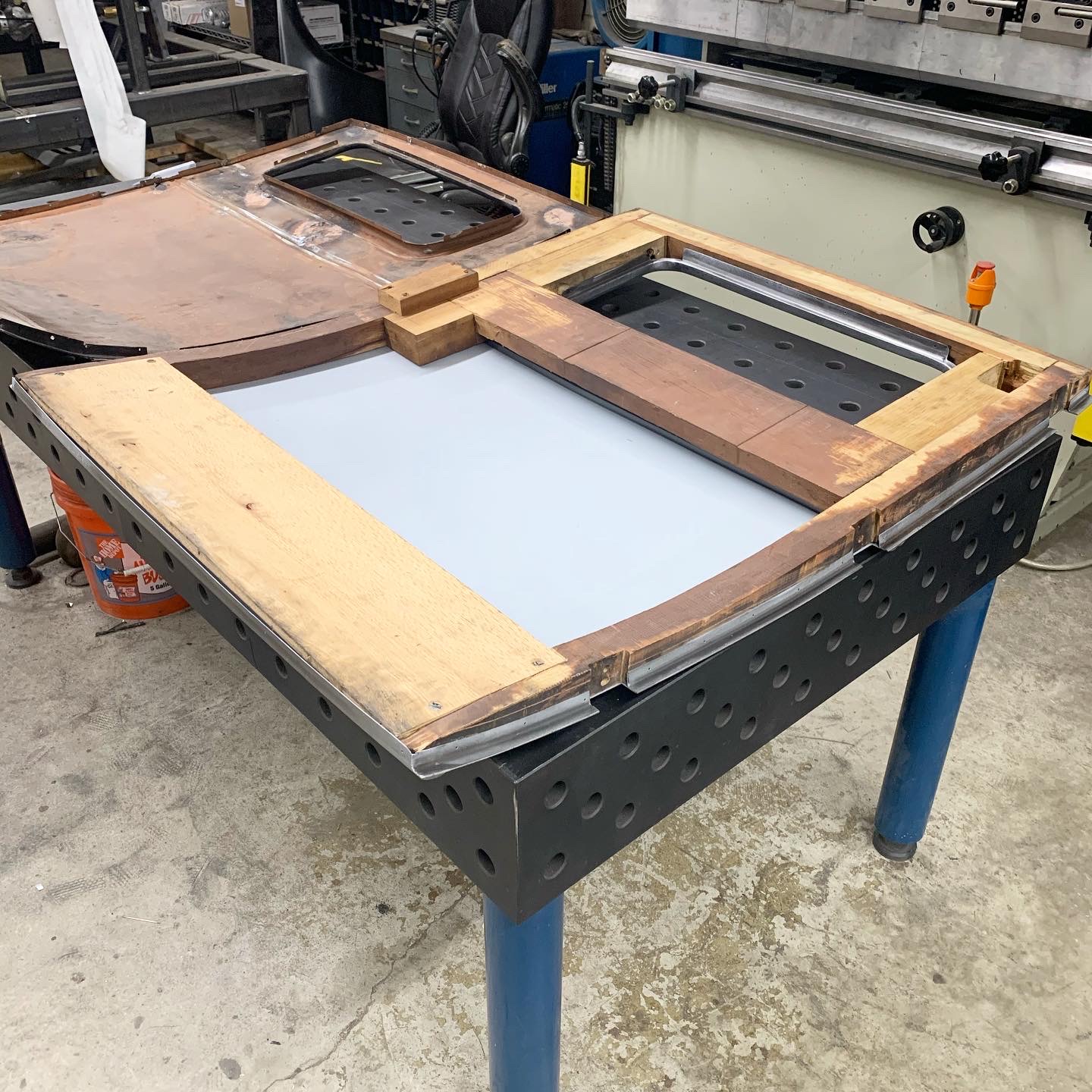

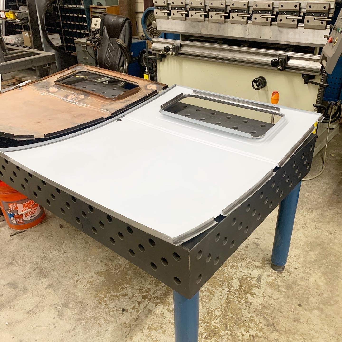

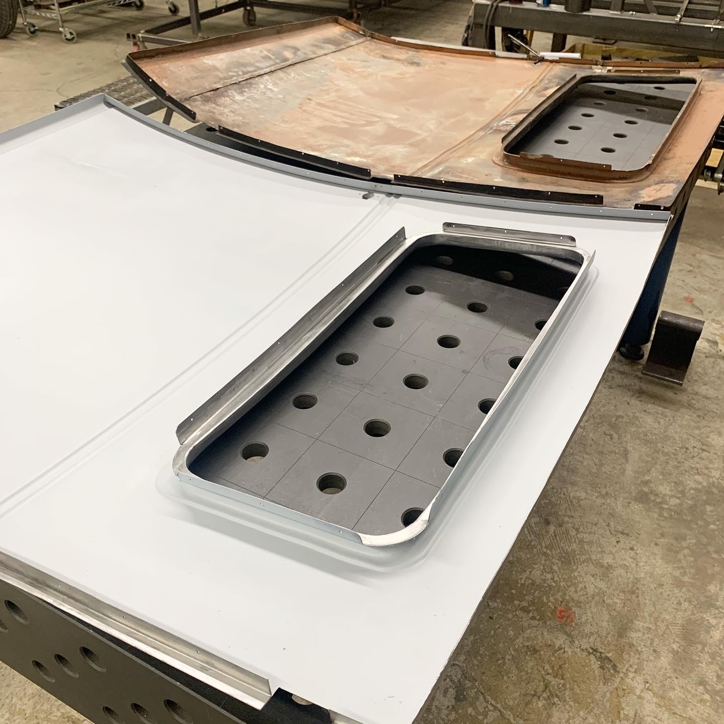

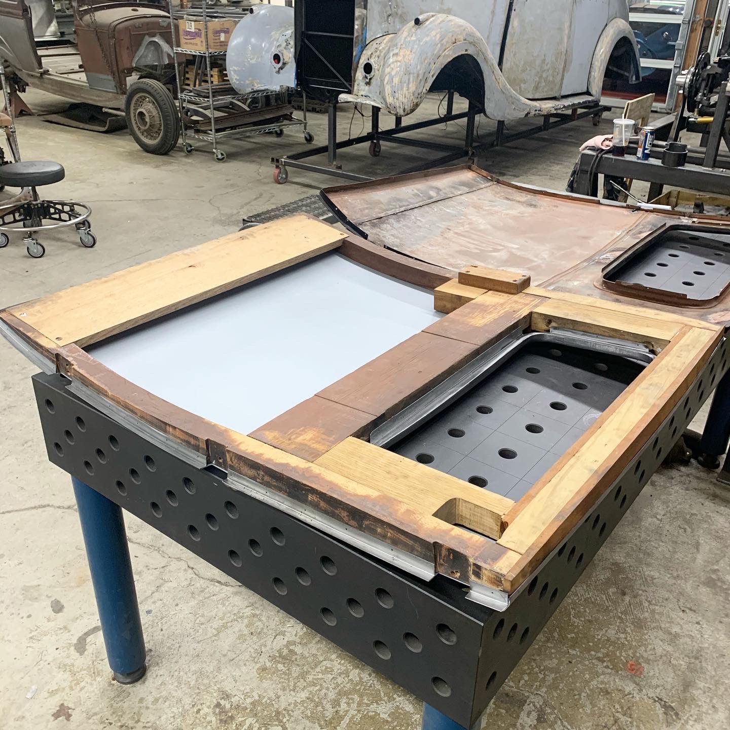

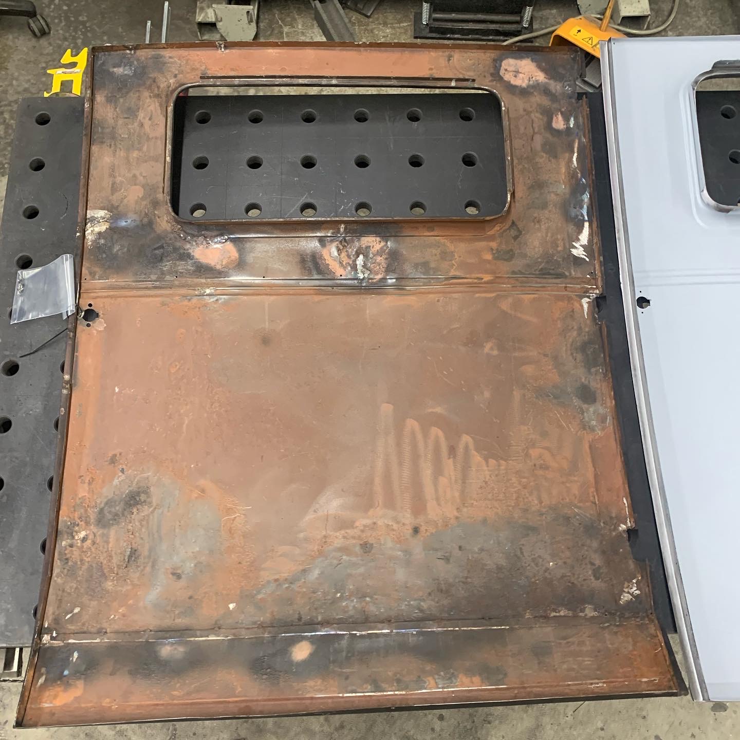

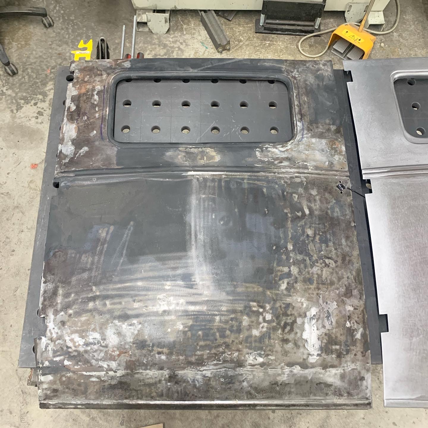

    Just finished making this 30/31 Model A sedan delivery door skin for another local shop doing a resto FB0183A3-C588-45FE-AFEF-4A826AE97C45.jpeg 326BF2AD-A4E1-46E8-978D-2504DD29954A.jpeg A8CB3005-BE7A-4764-9546-CDBAF65A19A4.jpeg F8AC865B-5194-487B-851B-AD357E8427BA.jpeg F422CA8E-061C-4434-829F-44F940AA3000.jpeg 41CEA1EF-1A3C-4563-A6DD-52B2A1DB6156.jpeg 2AE8E915-4DCC-4ED1-9D28-CB62192825E1.jpeg E5DFB532-1D29-4F91-A962-00C8B2554121.jpeg 616ED25E-BF28-4F51-8A63-1AD3BCFF0166.jpeg
