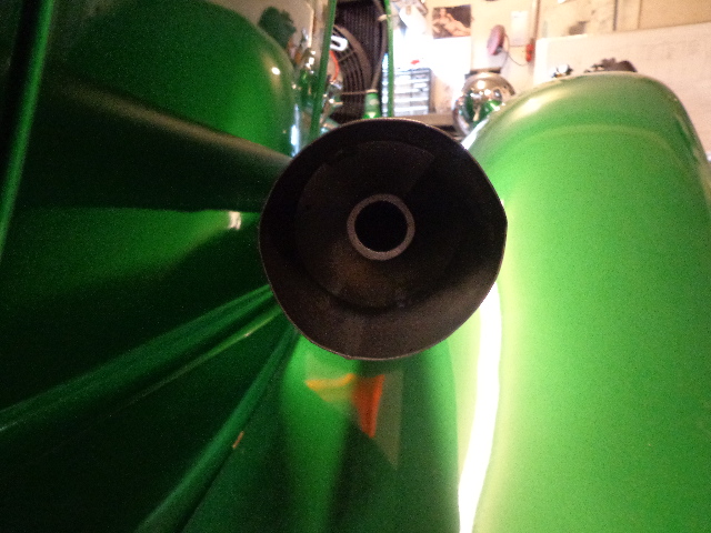

  2. [​IMG]
    A couple of self tappers and youre done.

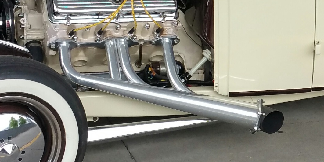

  18. I'm running Lakes with turn outs from gear drive as well, incredible workmanship.
    It sounded great...... but was to loud (big block Olds) so I pulled the baffles and wrapped them with ceramic insulation. Same kind as used in pottery kilns. Incredible difference. Still loud enough but took away the bite. No problems driving it all day.
