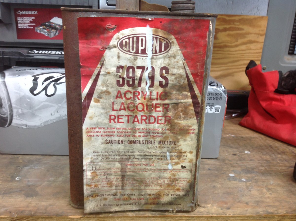

  21. Bringing this back up for a question, Paint Guru. Can I add something to the common lacquer thinner obtained at places like Lowes or Home Depot to slow it down or make it a quality thinner for automotive lacquer paint? If so, what would you add to a gallon and how much?

    What happened to good old retarder?

  24. 1-SHOT
    Joined: Sep 23, 2014
    Posts: 2,873
    1-SHOT
    from Denton
    image.jpeg Read the label if you can read Then Thank A Teacher
  25. Looks like it came out of a museum. I would prefer to find something available. Can you still buy that stuff?
    Oh yeah, notice I am from Alabama, so no, I can't read. The teachers here don't teach that.
    falcongeorge likes this.

    I have some old stuff that I never thru out. You never used a lot of retarder, but you kept it on hand for really hot days or high humidity to stop blushing. Just never got rid of it. Paint Guru gave you a option of using Ethyl Benzene.
