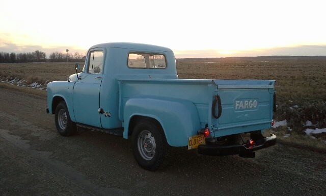

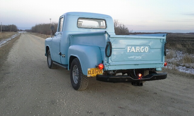

    Painted my Avatar truck and a 47 Chrysler and a few other cars, trailers etc the last 5 years.
    Falcon George will laugh at this one, the truck, Home Hardware Rust Coat enamel, custom tinted, cut with xylene, and about 10% Evercoat DOI acrylic enamel hardener. I shot on 3 coats back to back, very short flash as the shop was quite warm and the air was moving well. This paint is a modified alkyd (synthetic enamel) with a hardener, dries and cures at a much faster rate, pot life is good and long so no need to rush.
    Conventional gravity gun with a 1.5 tip, and about 45-50 psi.
    The 47 Chrysler I used International Paint Alkyd Enamel, with Medium speed acrylic enamel reducer, and DOI hardener. Both paint jobs came off okay for a real greenhorn, and have survived quite well, very hard once this paint is good and cured.
    On another board, in the autobody section, I damn near got lynched for my methods, they ran me off that's for sure, as I threatened their way of doing things.
