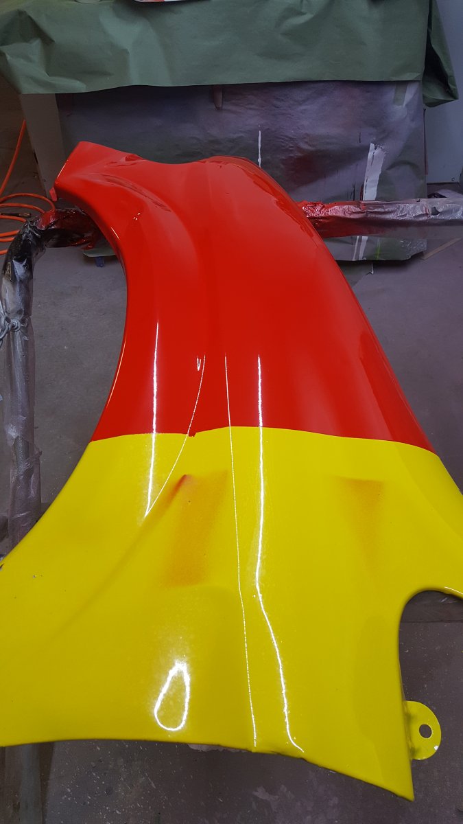

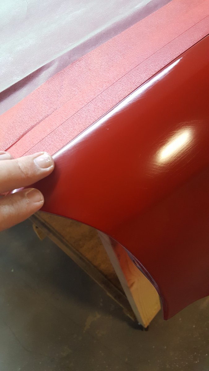

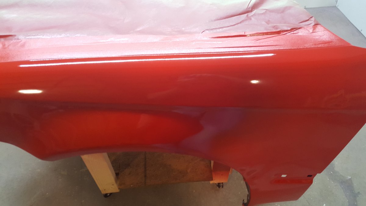

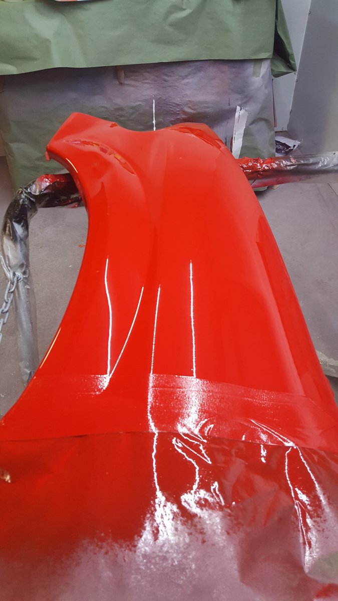

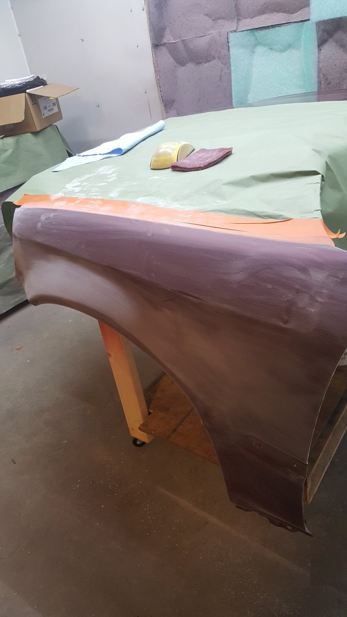

    Ok Finally got somewhere with our lacquer binders. Its been a while, but we have been testing, spraying etc. I did a sprayout today and got very postive results. Note** this is a VOC compliant lacquer, can be used in ALL 50 states.
    20170130_141914.jpg Started with a fender from the last clinic, we just scuffed with 800 on top, and on the bottom we scuffed with 400, just to see if scuff marks soak through using 400 grit.

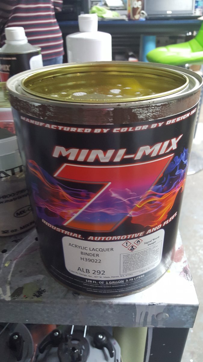

    20170130_131931.jpg The Lacquer binder. Its not yellow, its a lined can just fyi.
    The binder mixes 1:1 with toner. Then I reduced with a urethane reducer instead of a lacquer thinner (some lacquer has a small trace of alcohol, this will blister or haze lacquer).
    Sprayed 1st coat of lacquer with the timer on, in 2 mins the paint was completely flashed, and ready for the next coat.
    This was the first coat at the 2 minute mark. I could not believe how quick it flashed.
    After the flash, went with 2nd coat. With the 2nd coat, I had full hide. Now I was going over a red fender, so I took that into consideration. The 2nd coat took 5 mins to flash.
    It looks just a tad dull, but still impressive I thought.

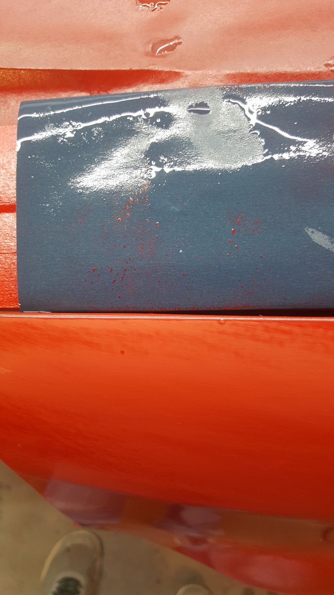

    I put 4 coats total, allowing a 5 min flash between the 2, 3rd and 4th coat. I then let it sit for 30 mins. I tried to wet sand to see if it would be dry enough...
    You can see it gummed the paper up just a little, but not what I thought it would be. After that, I just used our "house brand" aggressive compound with a blue shop towel, followed by our swirl remover compound with a different blue shop towel. The 1200 grit scratches came out with no effort.
    I didn't spend any time buffing. just fyi.

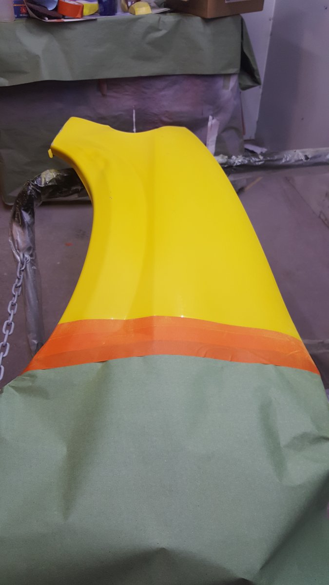

    So next, I rolled that front clip out of the way grabbed a junk fender that had some polyurethane that we sprayed a year ago and scuffed it.....
    20170130_153637.jpg Here I taped up a portion of it.
    1st coat over the yellow....
    10 coats later........
    The reason for 10 coats, I am putting this in direct sunlight and letting it set for a month. If this lacquer is going to crack, this will make it crack. Every coat applied was very heavy coats. I dont think it will crack, due to the type acrylic we use in the lacquer.

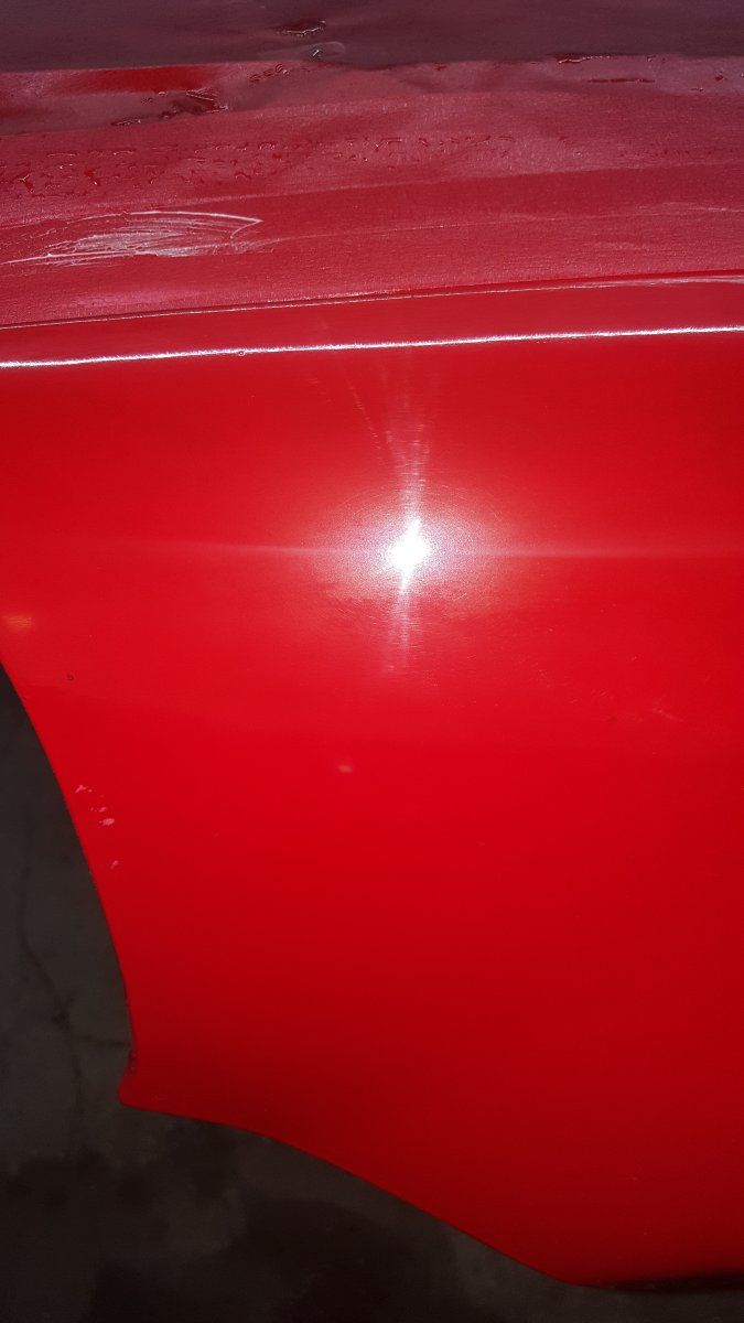

    Just a quick update. This is the fender I put 10 coats on, no buffing right out of the gun.... Day 3 1485960872075.jpg

    2 weeks have gone by, no issues with the lacquer. It has shrunk a little and I am seeing small sand scratches from underneath, not a big issue, a sealer or a finer final sanding would prevent that. I am going to buff after the 30 day mark. I am very impressed with it. Talking with our chemist, a activator can be added to the lacquer at a ratio of 10:1, this will give better exterior durability and color holdout. I am not sure how quick the cure time or buffability would change the lacquer.
    If I have time today, I am going to spray the black lacquer and buff.
