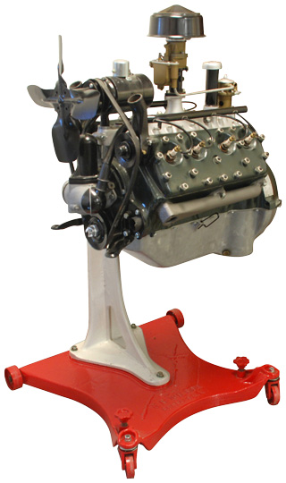

    I wonder, if someone that has a KR Wilson engine stand with the base No 744 for Ford flathead engines could take several measurements of it, for me. I have the stand, without the base and they seem to be hard to find as the hens teeth.

    I'd like to see a picture of one if somebody can post it. I would expect it to be a substantial piece.

    Here is one from Bob Drakes site.

  6. I'm in the same fix. Here are a couple I have for reference. Somewhere I have the length x width dimensions. If I can find them, I'll add them

    I'd probably build a base with U shaped framework with 4 wheels and put a piece of plate across it to bolt the stand to.

  9. Still looking! It could be scaled up from the base dimensions if I can't produce.

    Hi Tom: I have a couple of the cast iron KRW engine stand bases. They are great, heavy and expensive. A few years back we bought a large piece of steel and cut with a track torch eight 30" x 30" squares. We used 5/8" steel plate, steel wheels with roller bearings and drill rod for axles welded a couple inches back from the corners. No casters to keep it simple, and it is very easy to turn because of the steel wheels even with an engine on the stand. I will try to load a picture soon. Gary in MN.

    JalopyBanger, since you have the upright part of the stand for reference, it seems to me you could get very close to the base dimensions from the photos posted. By measuring your post, the spacing of the mounting holes and the length and width of it's foot, perhaps you could measure the the photo's spacing of these key points and extrapolate the actual dimensions of the base.
