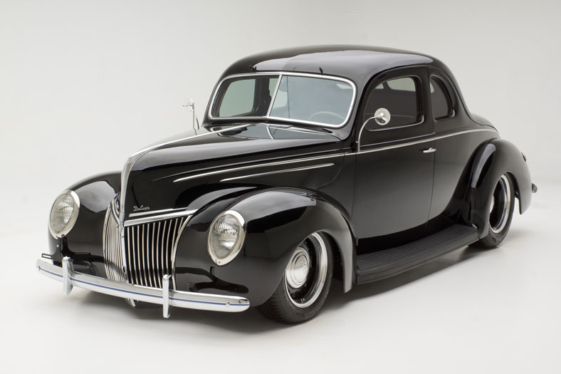

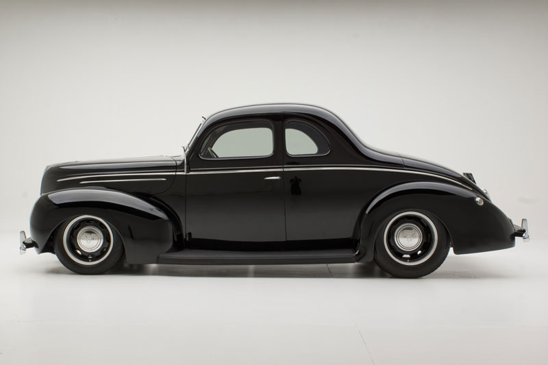

    front-view-studio.jpg side-view2-studio.jpg I stole these from the 39/40 thread. Love the altitude and and the attitude of this one. Very cool!
    Something to aim for eh?
  3. Slake43
    Joined: Dec 18, 2013
    Posts: 53
    Slake43
    from Melton
    Very nice stance , to Emulate that would be sweet !
  4. Love it.
    Just about perfect.:D
  5. Yes that side view is absolutely perfect . Have you mentioned what power plant you are going to use in this built ?

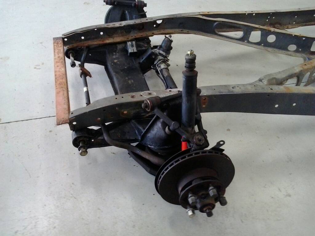

    1390781001248.jpg Old front axle rolled out, steering box and mount removed, ready for the Jag ifs to go in. Will be picking it up tomorrow.

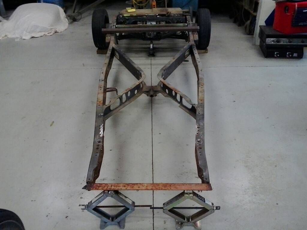

    1390867946246.jpg 1390867972524.jpg 1390868017691.jpg 1390868038710.jpg Went out this morning and picked up the front end. The guy had cleaned it all for me and had it ready to go. I took it straight home and slotted it into place. Looks like it was born to fit. Some trimming of excess fat to come.
  21. Very nice and should be a nice riding car, hope the seller has deducted the price of the wheel alignment ? LOL.

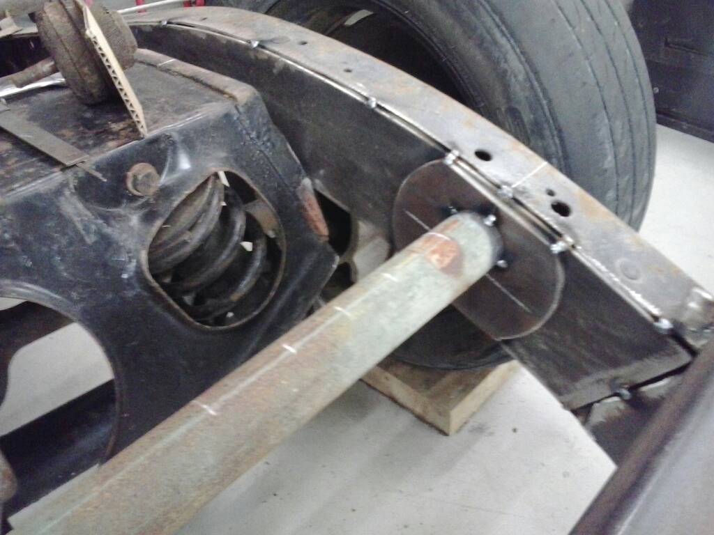

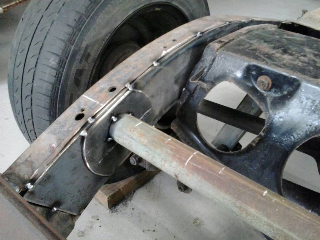

    I marked up all of the extraneous superfluous brackets to be trimmed, then grabbed some threaded bar from town to ease off the tension on the springs. The second picture of the spring is when the tension finally was fully released, so 6" lengths of threaded bar was just right.
    The front end was from a V12 XJS so the springs are a little overrated to say the least. I will keep my eyes peeled for some XJ6 ones to take their place. Until then a strut set at ride height will do.
    I trimmed off the brackets after dinner tonight and will tidy it all up with the grinder in the morning and post a couple more shots of it looking pretty! I am planning to get it fitted and more trimming done before going back to the paid employment on Wednesday.

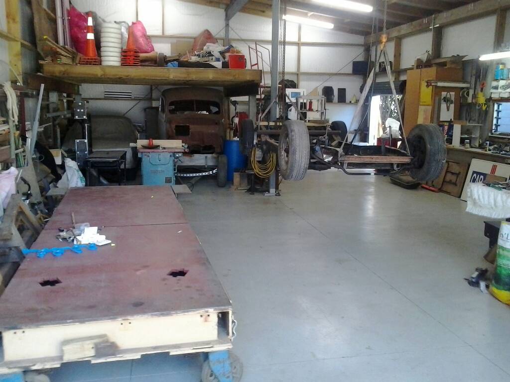

    1393201366596.jpg 1393201390218.jpg I reset the shop today. I wanted to put the chassis on the bench to remedy some issues. I first had to clear off the bench of all the club detritus. Yesterday I grabbed some plywood to put some floor onto the mezanine, so now the club stuff is up out of the way for now. My sparky turned up to fix the chain hoist so I could lift the chassis on to the bench.
