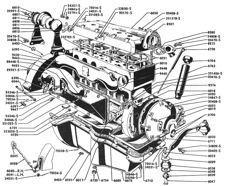

    Interesting Thread and the fact that you can bolt a 1939 Ford transmission to the "B" engine really helps...note vibration dampener that bolts to firewall... 4cyid0001.jpg
    3W JOHN and HOTRODPRIMER like this.
  5. No...you can't. But you can put the 39 guts and tower in a B case.
  6. Model A's were 40 HP, B's are 50. A's were a splash oil system. B's have pressurized mains and dipper rods. A's had mechanical advance distributors, B's had centrifugal. Some B's had a counter balanced crank shaft. B's have a fuel pump, and fuel pump lobe on the cam. The heads, block, crank, rods, ect are different. Honestly, nearly every part is different, although you can bolt a B into an A with the correct parts. I put a B inti my 30 coupe, using a Clings adapter and 39 trans. Worked great.
