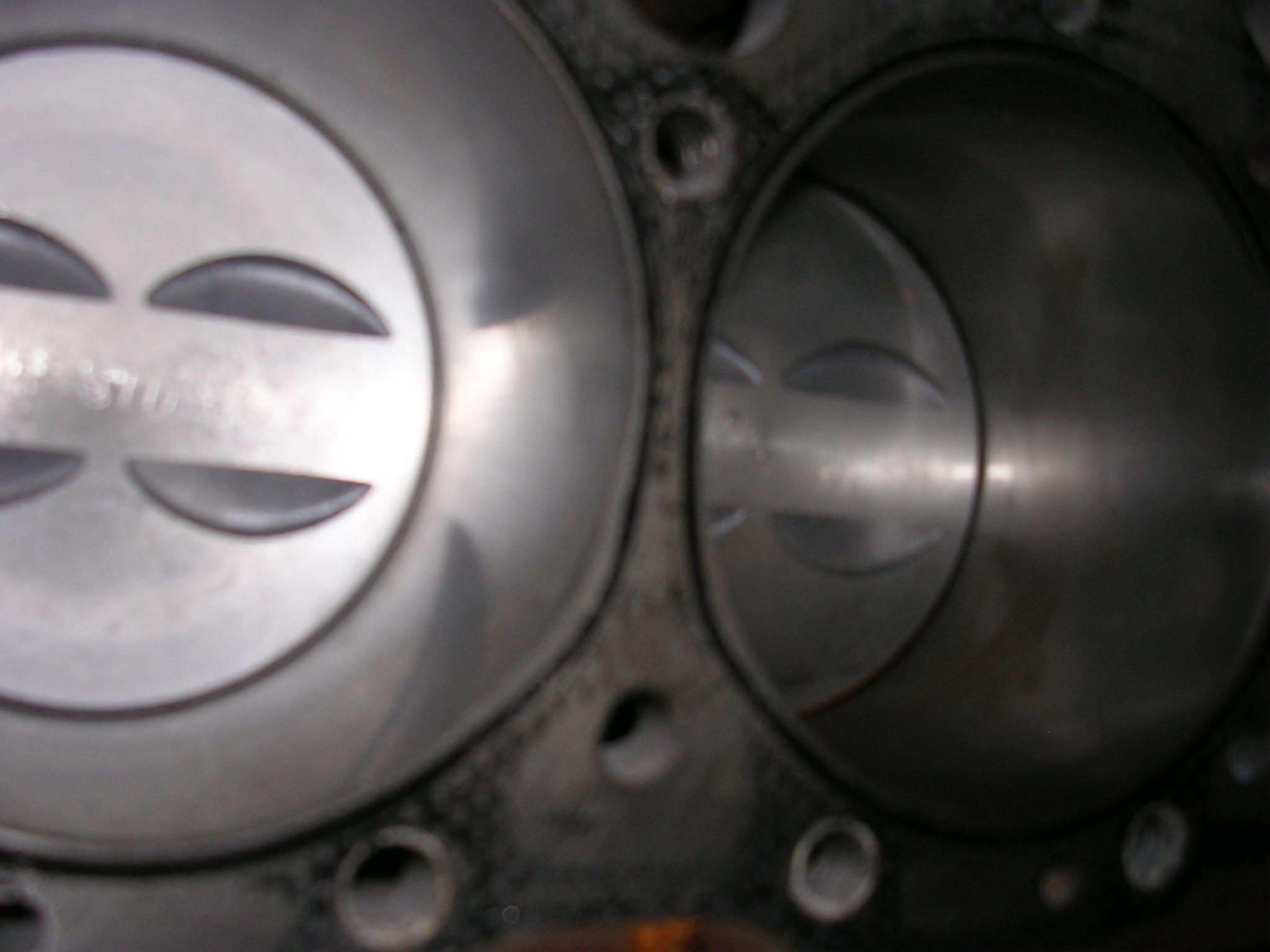

    i just picked up this 327 short block for 300 bucks,i have been loooking for a running 283 or 327 for awhile but havent had too much luck and this came along so i jumped on it,the guy said it was rebuilt by ed hales shop in san diego,put into a 64 impala but pulled to repalce with a hopped up motor,,he sold the heads of it recently and used the pan/carb/manifold on another engine and sold me the short block,its standard still,not to sure of mileage but was told it was in the impala for 2 years,im no "engine guy",,i know the basics but in not fully educated on motors enough to know if scored or not,what heads would you use on it being that its stock? camel humps or power packs or?,carb/manifold?,thoughts? opininons? advise?,,all welcome,,,thanks:)

    Looks like a forged crank....that's a good thing!

  23. the balancer could have been changed , so you really can't go by that. if it was a corvette motor i have no idea,i don't know if it makes a difference , and i don't care
    what i do know it has new flat top standard bore pistons , a forged crankshaft and by what i have read here it's put together by a top notch guy...so i say you did good
