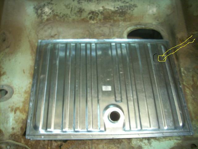

  11. A few more updates. Gas tank is modified and trans cooler installed to button up a few more things
