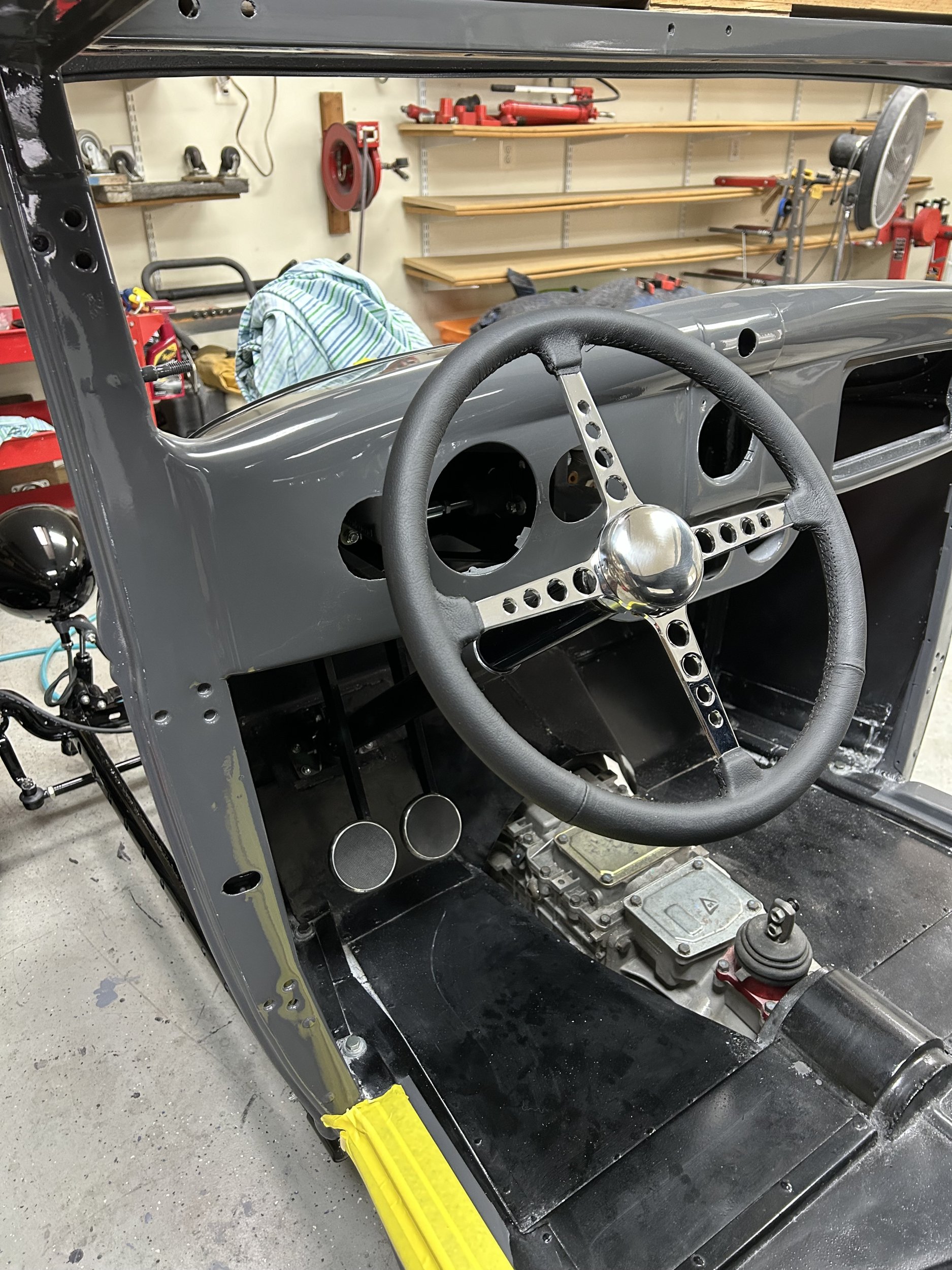

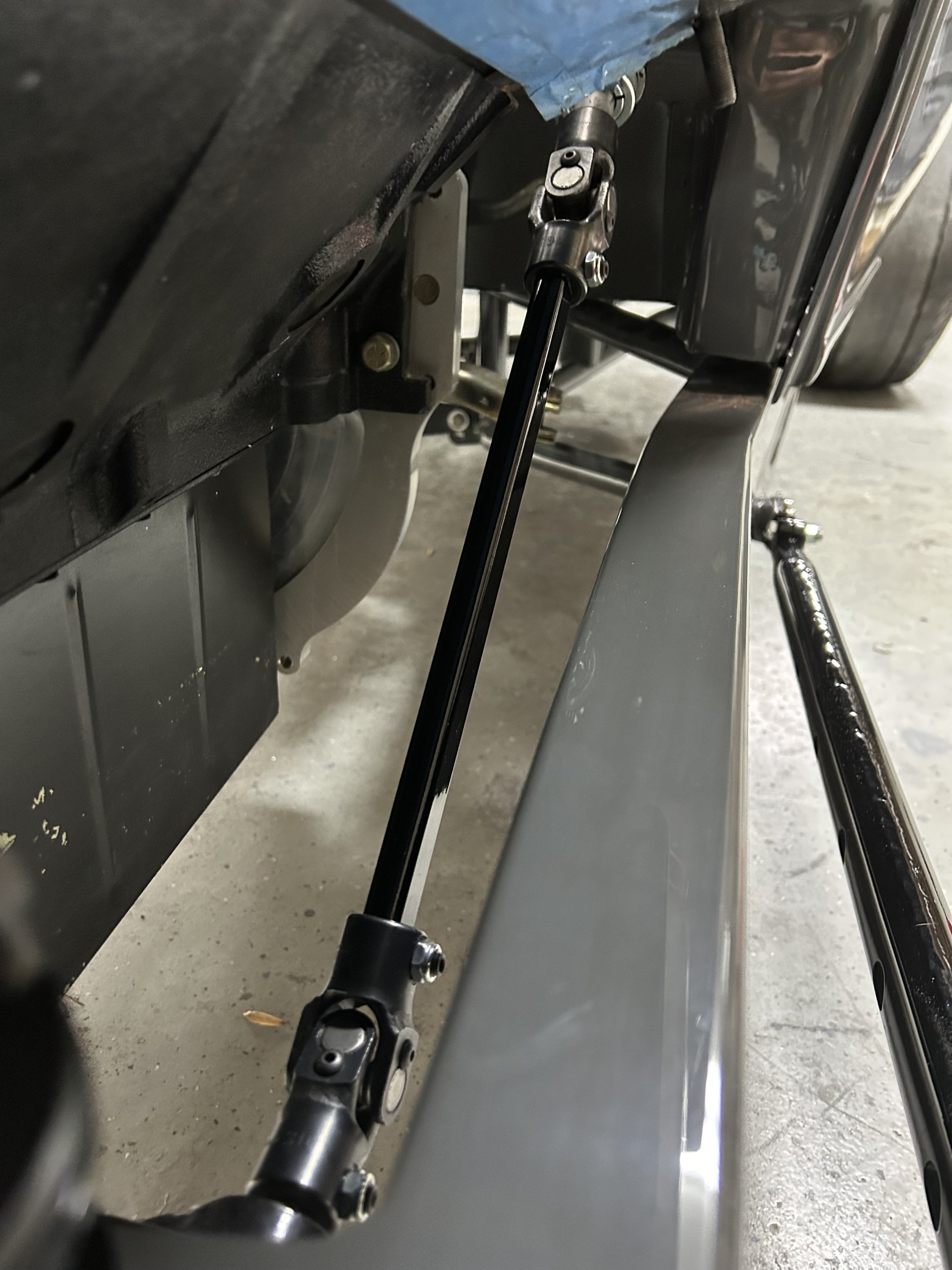

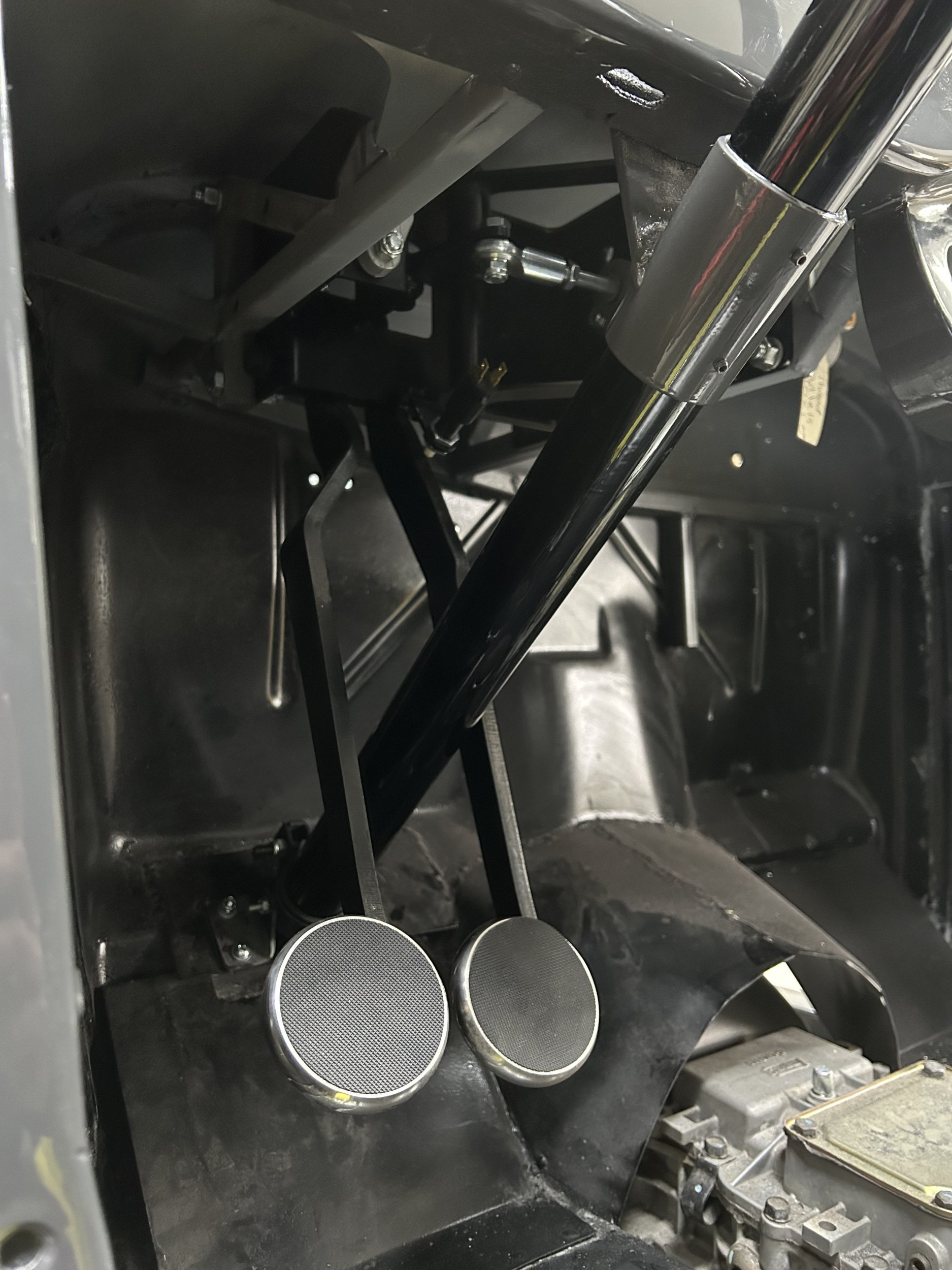

  2. Getting the Hemi Coupe updates caught up. Steering column, steering shaft and pedal assembly installed. Brake lines and hoses finished up.

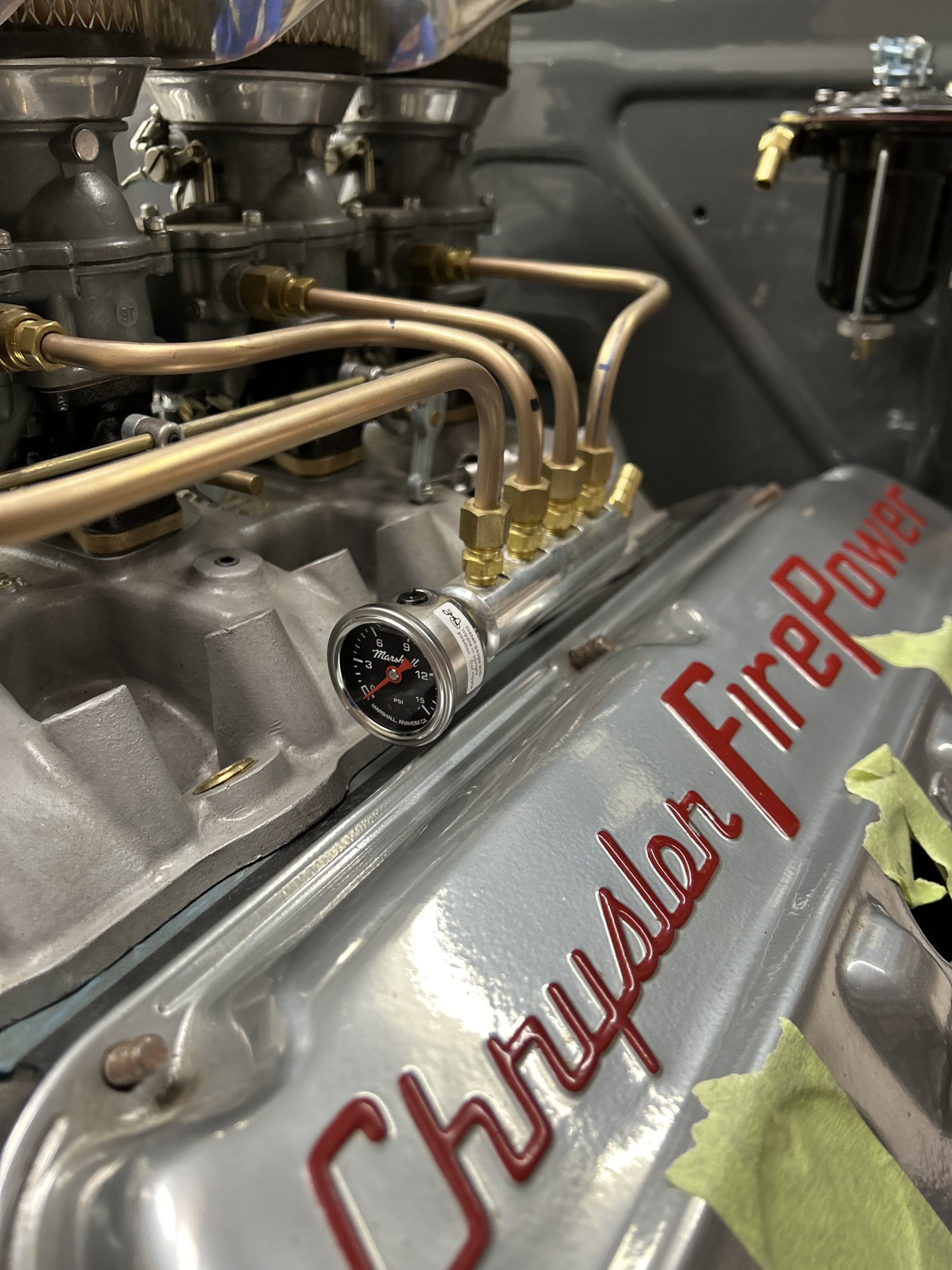

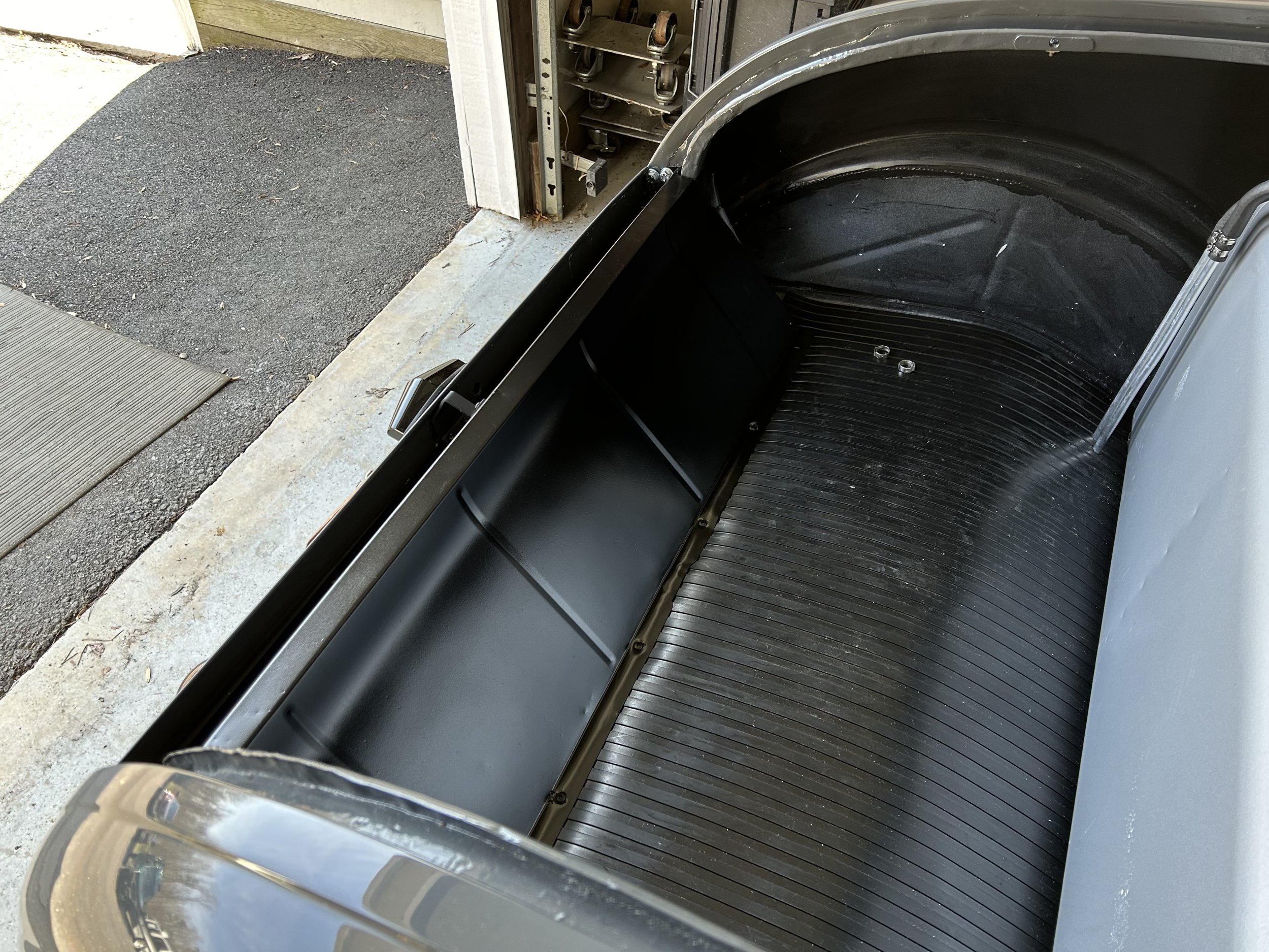

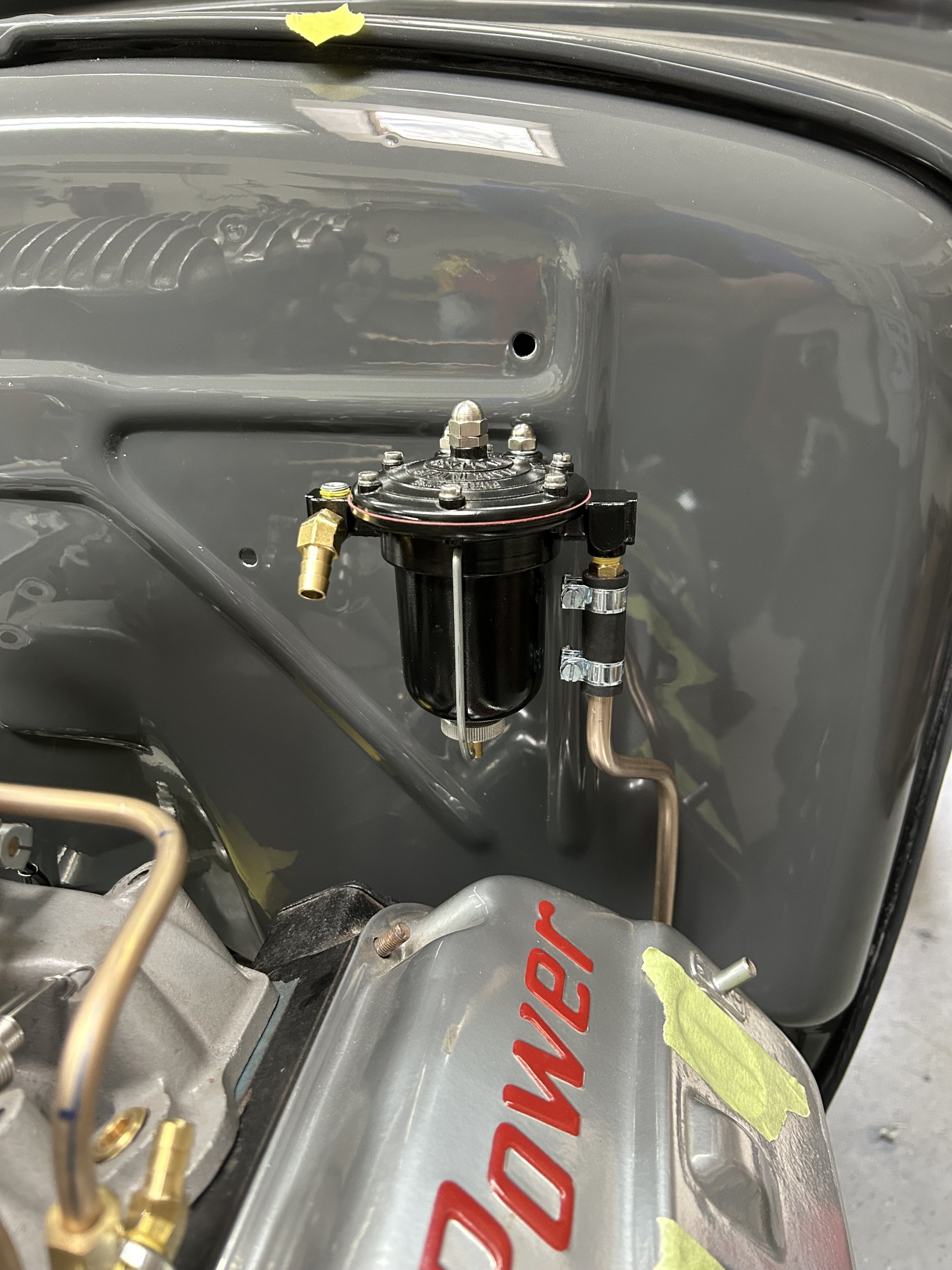

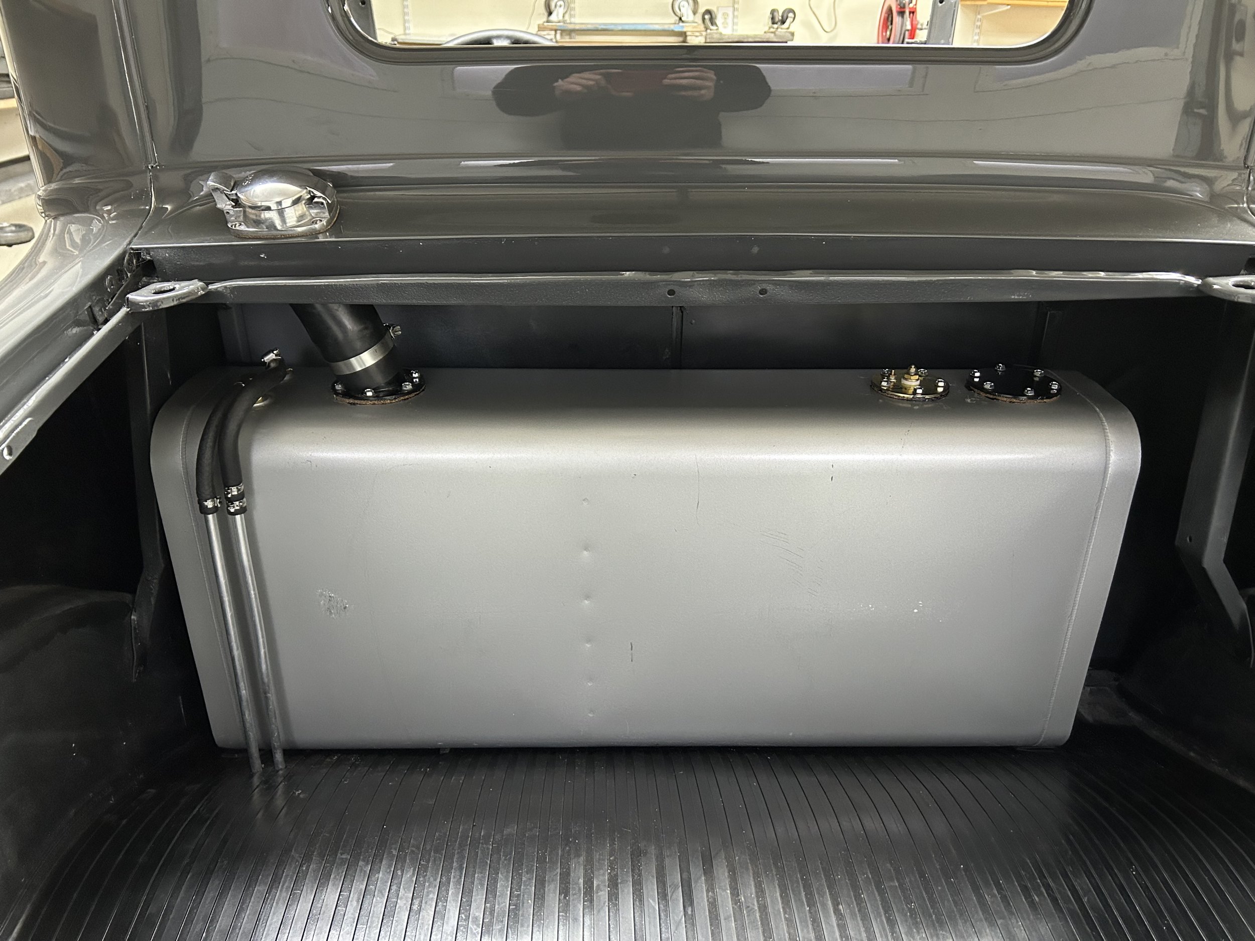

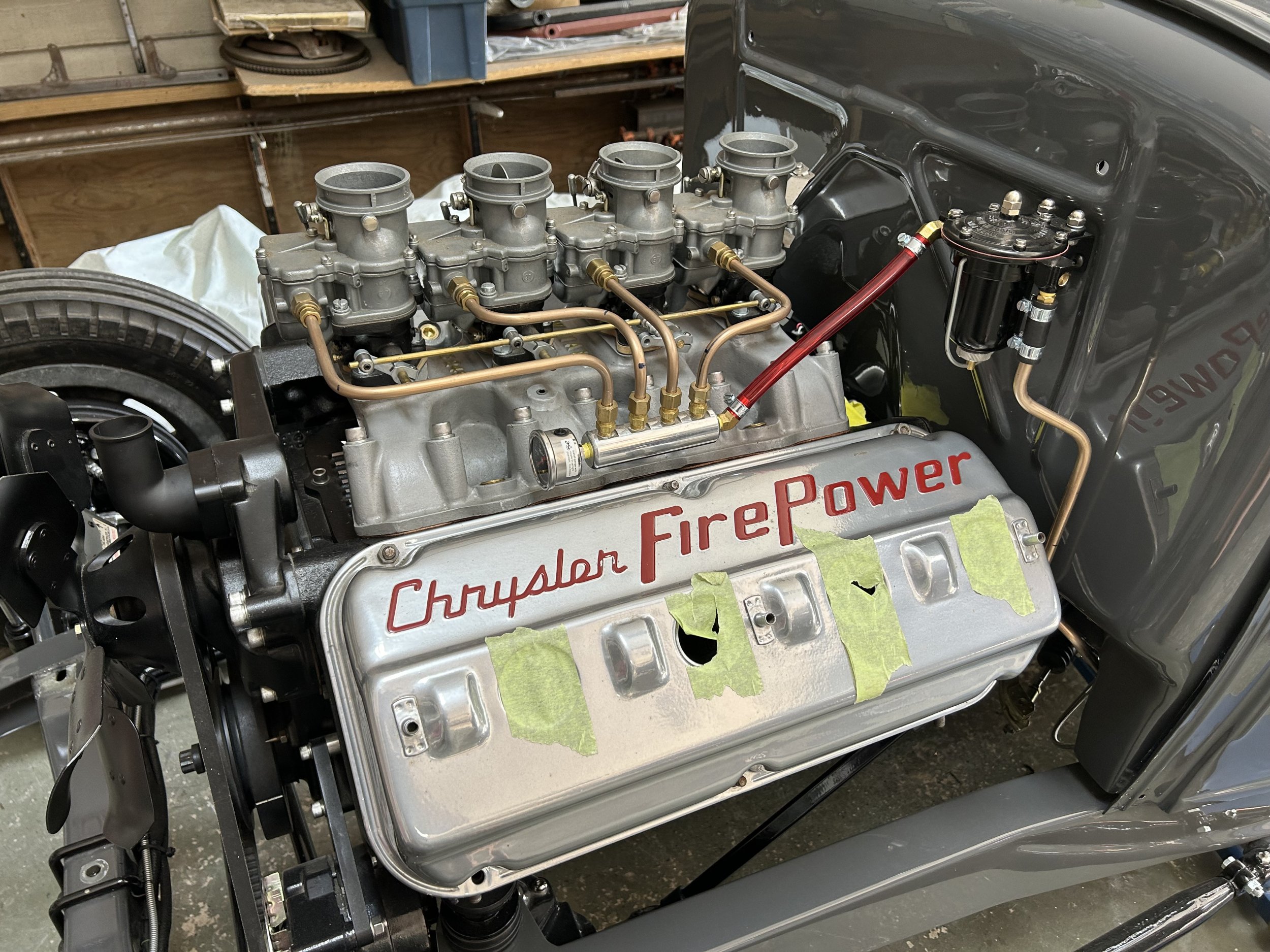

  4. Fuel tank, fuel lines, fuel pressure regulator, intake and trunk area finished up on the Hemi Coupe.
  5. Tim
    Joined: Mar 2, 2001
    Posts: 19,637
    Tim
    from KCMO
    That regulator/filter is rad! What is it?
    Stogy and ClutchDumpinDan like this.

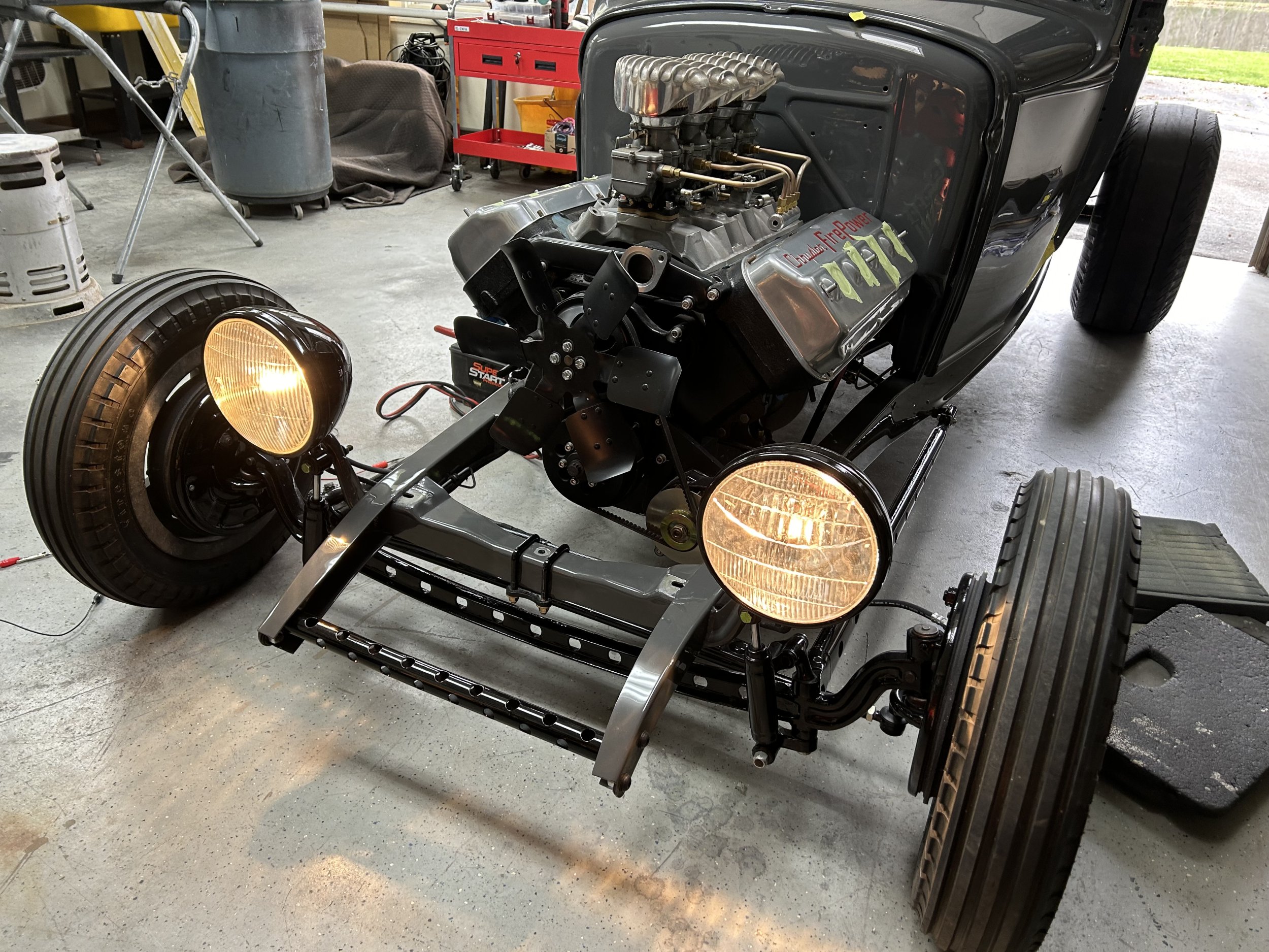

  6. AmishMike
    Joined: Mar 27, 2014
    Posts: 1,332
    AmishMike

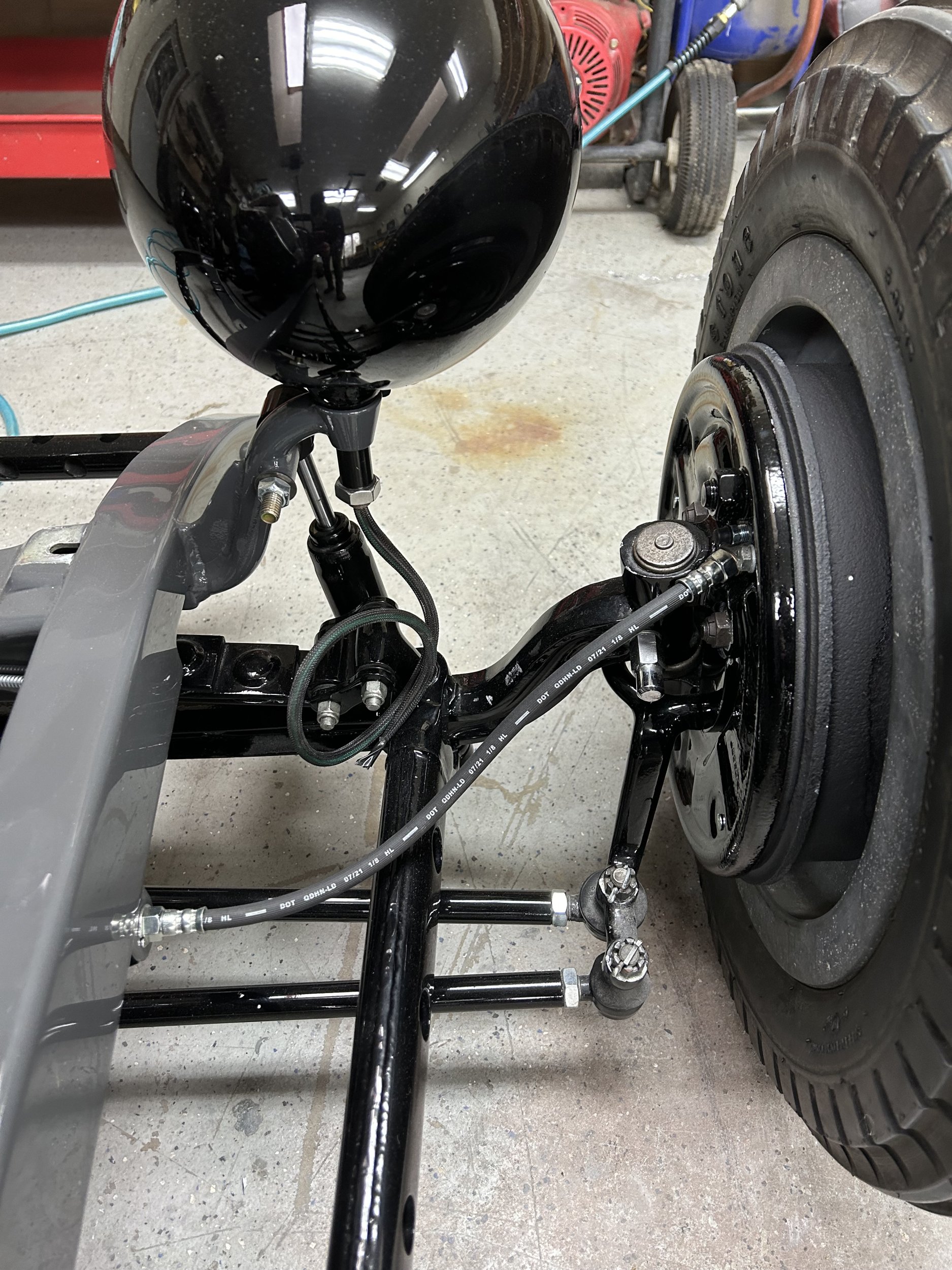

    Great car. But - picture of front wheel & suspension, rubber brake line looks a little short for a hard left turn. Maybe?

  7. Made by Filter King. They have glass bowl ones as well.
    Stogy, Just Gary, Tim and 1 other person like this.
  8. It sure does! Bad angle on the photo. It has a pretty decent zig/zag kinda dip in it. Goes full lock just fine :D

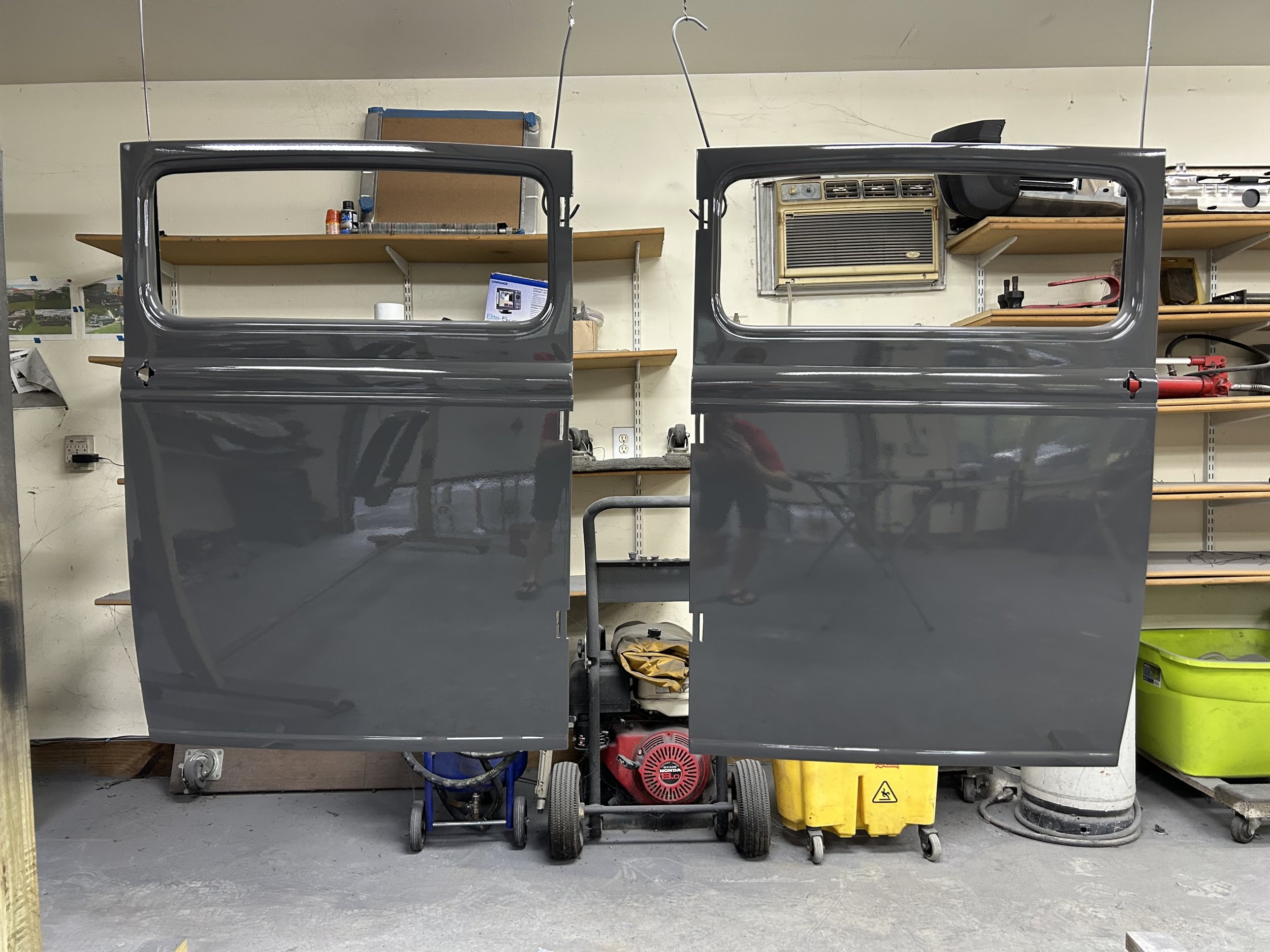

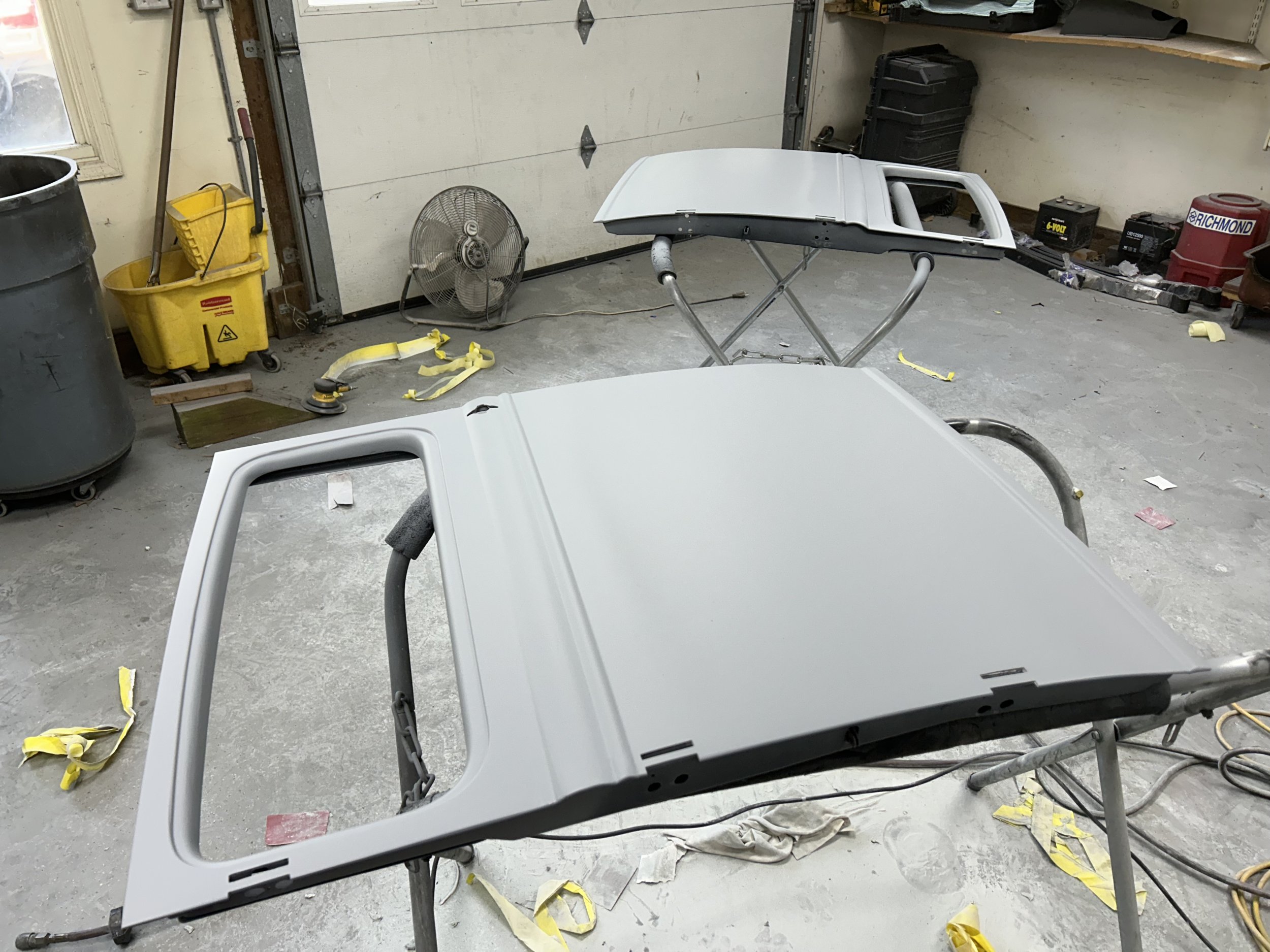

  9. Final body parts painted. Cut, buffed and ready for install.

  11. Wrapping up some final details. Dashboard waterfall polished & installed, side view mirrors installed, little retainer made for the throttle return spring, throttle pedal mount fabricated & installed, throttle pedal modified for better ratio & fitment and column mount tach installed.
    It’s getting close to done!

    Dan, where did you get the throttle pedal from?

  22. It's a cheap-o. Probably Speedway or Amazon. Good to cut up and make fit where you need. Along with the extra length, I put a pretty good offset in it to get it in the right spot and aligned with other pedals. Cheaper/quicker than building one from scratch.
    akoutlaw, lothiandon1940 and Stogy like this.

    Very cool project Dan! Nice work! Hey, are the pedals from R Jays? Looks like the clutch is 180 degree and the brake is 90? Were they two separate assemblies?
    Dino 64 and ClutchDumpinDan like this.
  24. Thanks Kevin! Pedal assembly is one unit. Correct, clutch M/C is 180º and M/C is at 90º
    Been awhile since purchase, but I think it came from Kugel. Lot of people making them now luckily and they aren't insane expensive anymore (or I'm not so cheap?)
