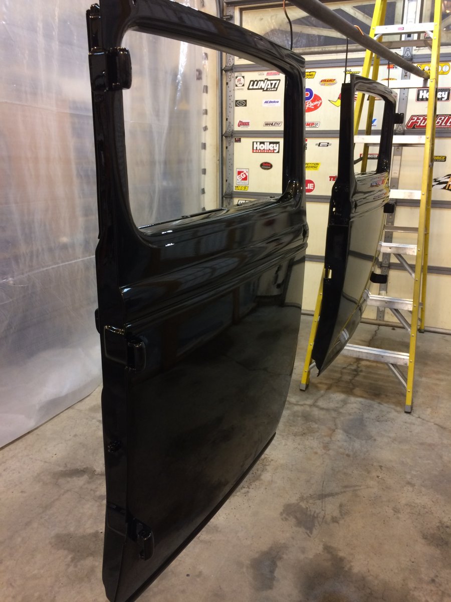

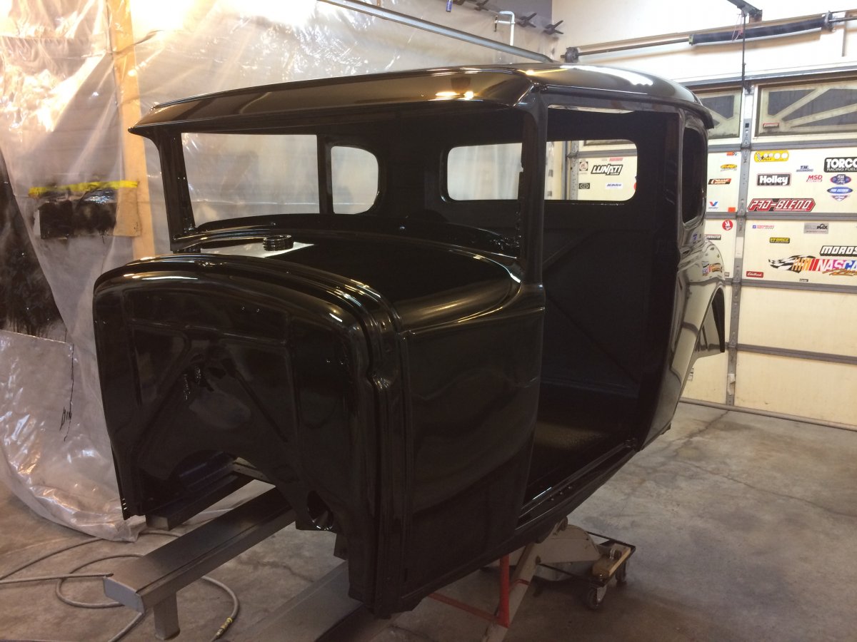

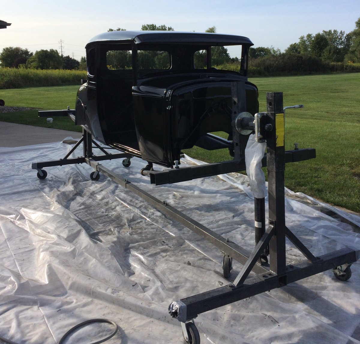

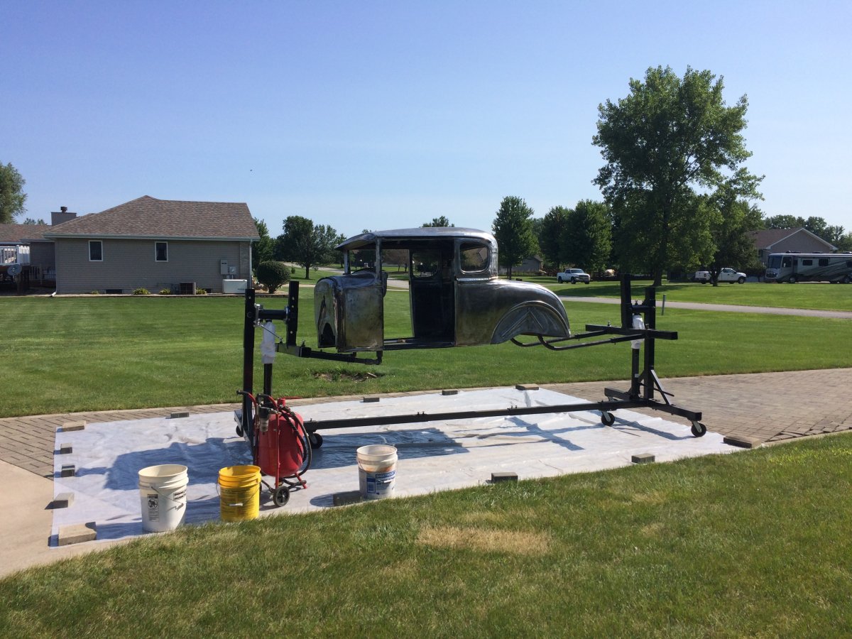

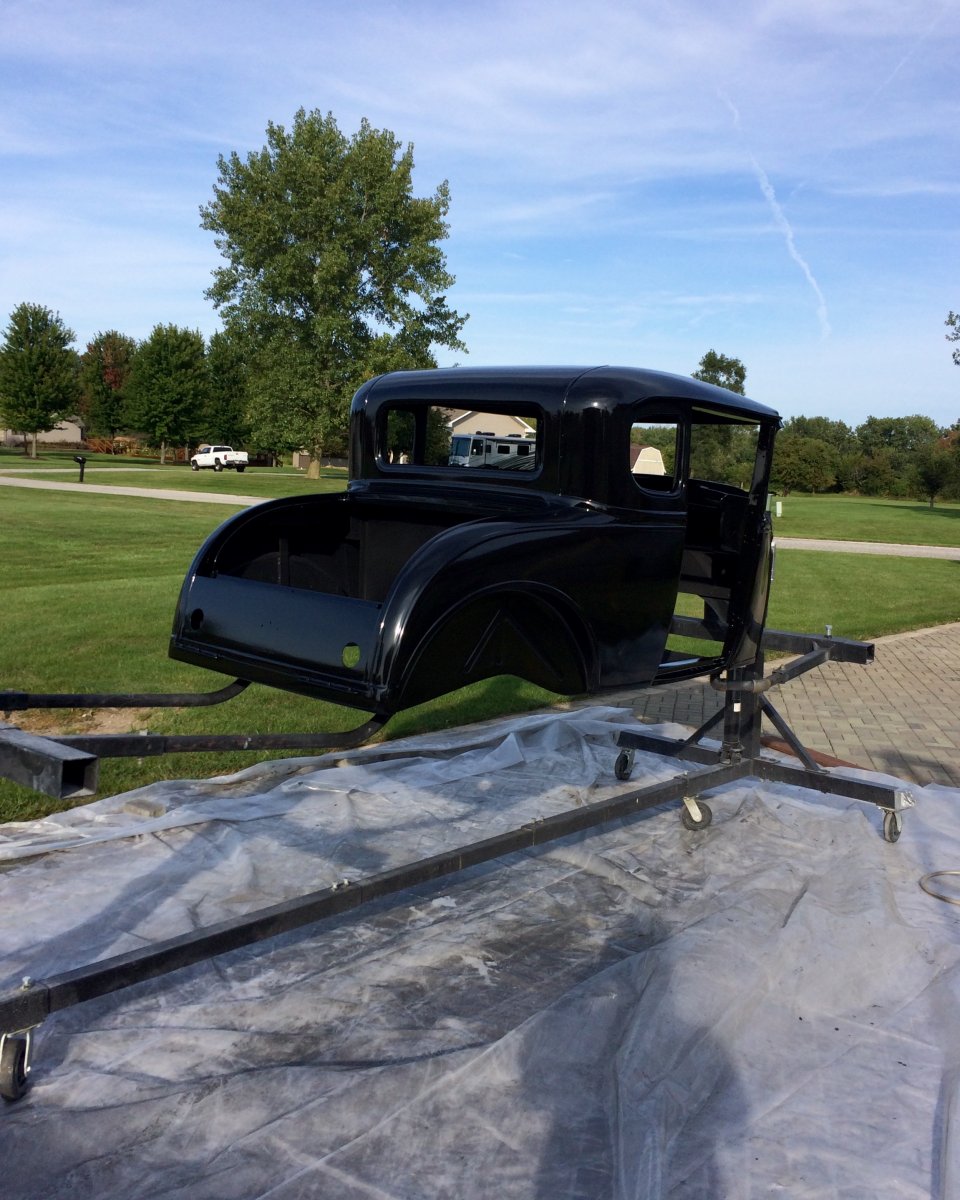

    No that is actually epoxy primer from SPI (southern polyurethane inc). There epoxy goes on with somewhat of a gloss to it
    I painted the SPI single stage urathane black in my garage
