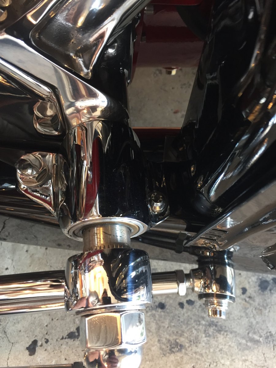

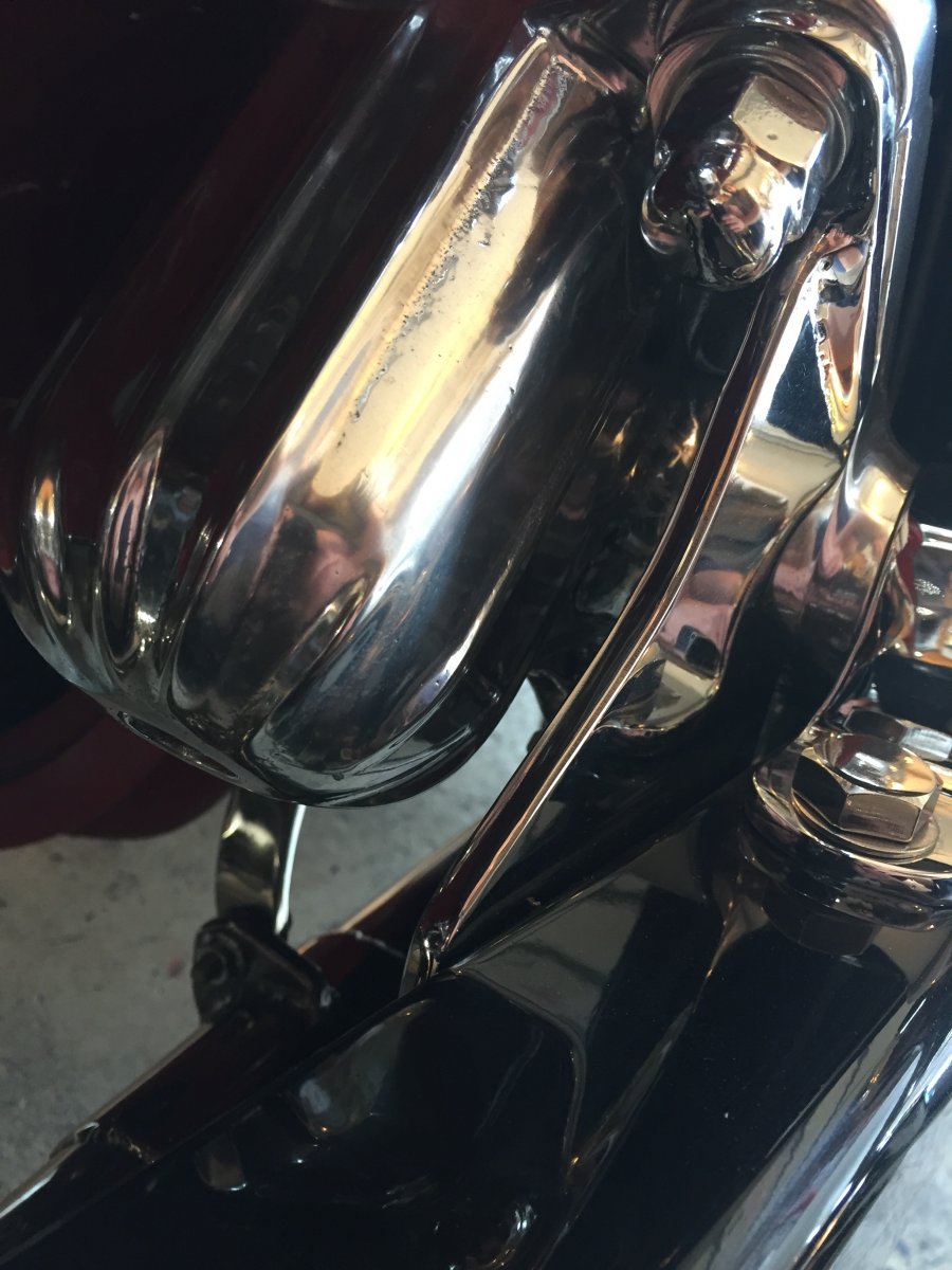

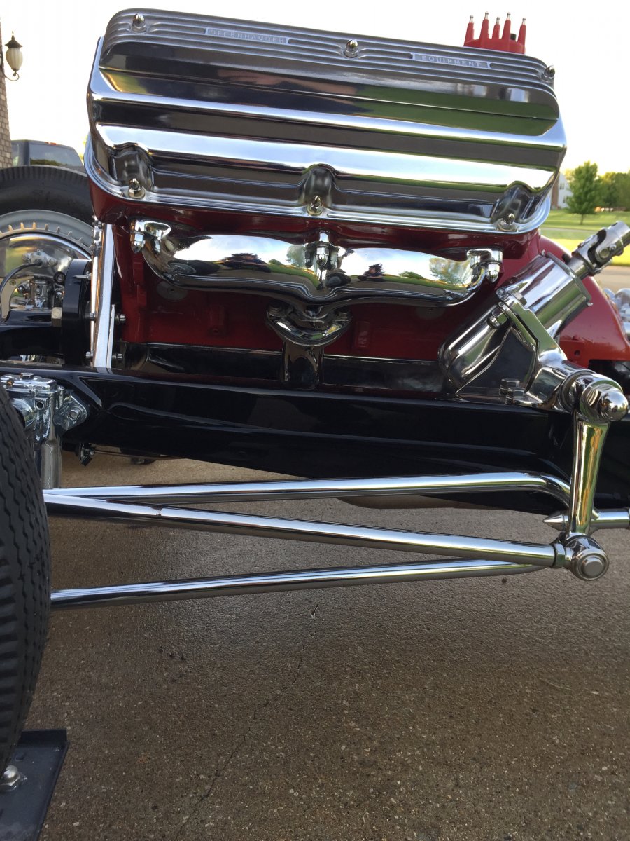

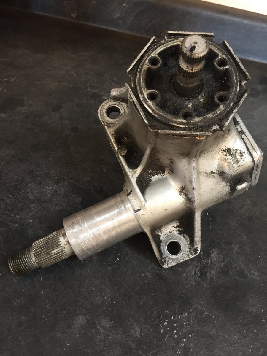

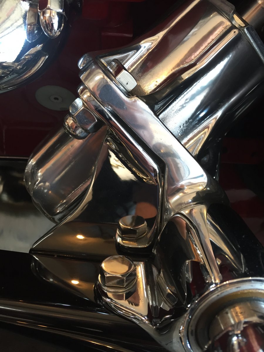

    Thanks Lynn! It is the typical mid 60 to seventies manual steering box mopar used on allot of cars but I did machine the end of down to slide into a bracket I made and had chromed that sits on top of the frame. I had to cut one of the mount hole areas off to do this. I then also had to build a bracket that mounts to the inside of the frame and pics up the other factory mounts on the steering box. mopar steering box.jpg [​IMG]

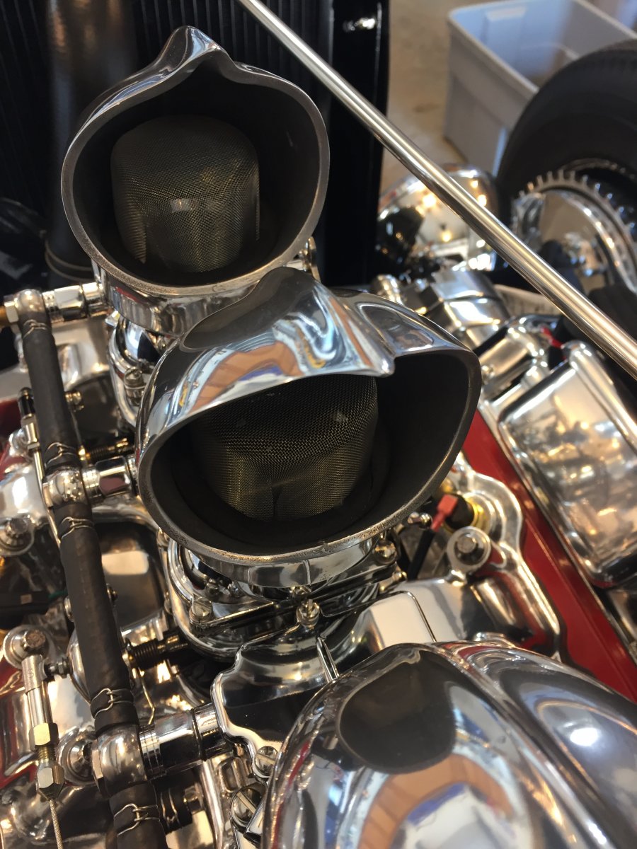

    And the air cleaners??????????????????????? Marine?

    No they are open scoops with mesh filters, a guy on ebay was selling them from Australia not sure if he still does or not?

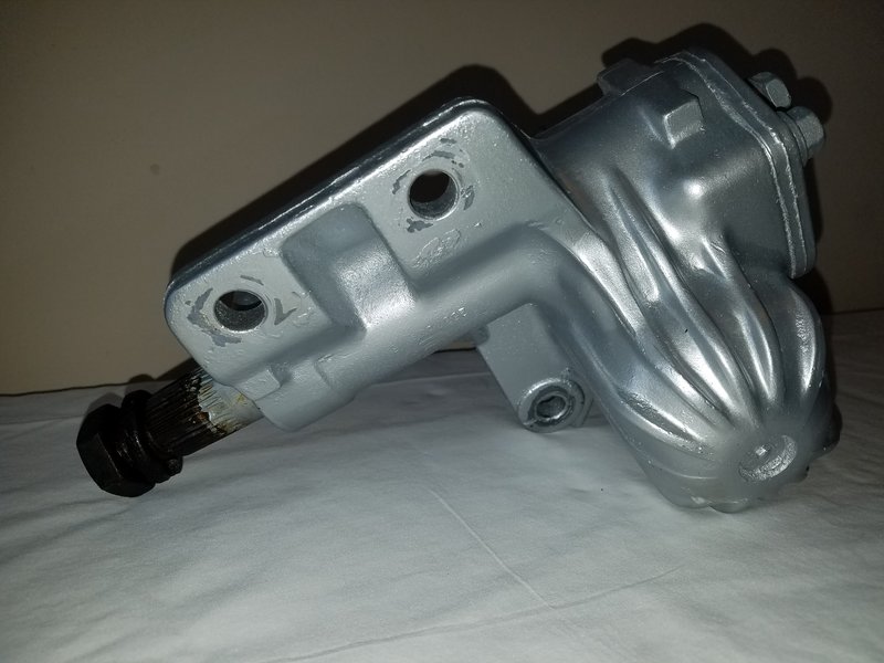

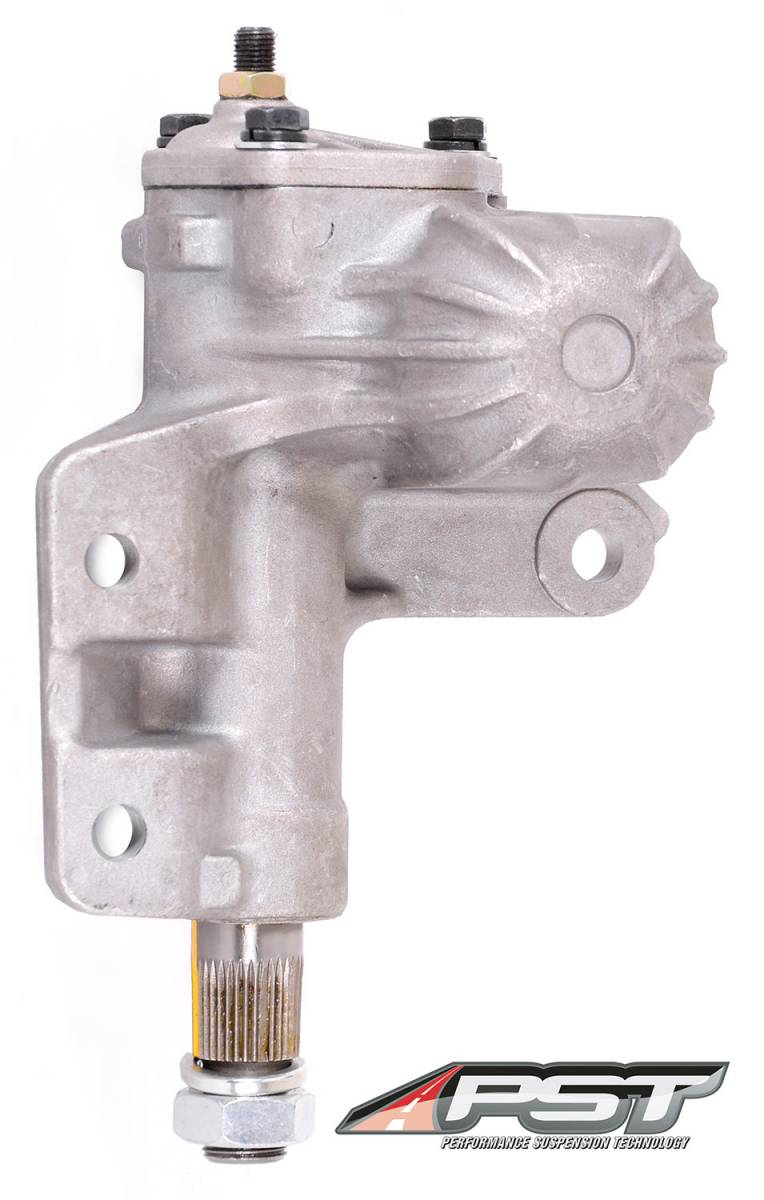

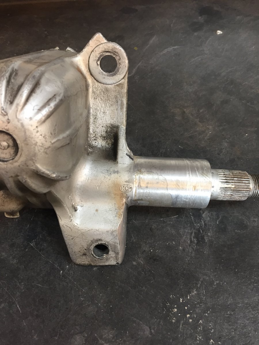

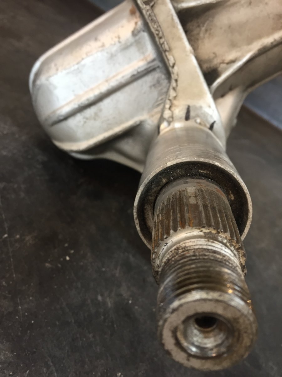

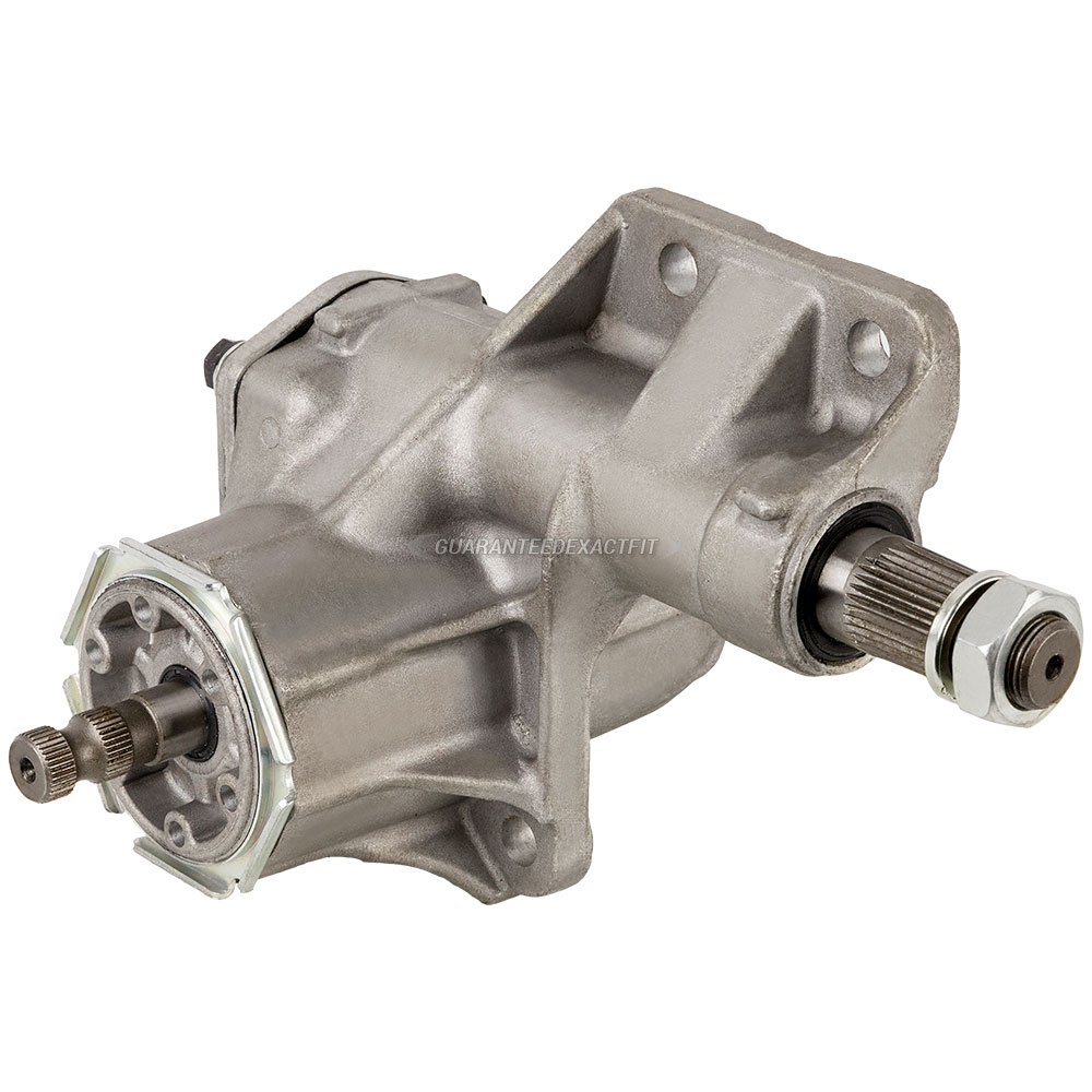

    5863FCC6-B2D3-4FCB-9EBA-6323A4163336.jpeg 686D85AA-DE82-4F77-8165-3F7D6410D34B.jpeg 45B01C19-2CA1-49F6-BEC0-496D80D6DB98.jpeg 2A94B14A-C532-4880-B784-7EC6B9C0CFA8.jpeg 0A1170B8-AB52-479C-B9D7-012CA5EF5748.jpeg 5C361FF4-E0D4-4891-A1D8-CC8E94D2111C.jpeg F6FE20EA-F422-470C-AE82-819342A6B594.jpeg B9B674A2-69B2-4D1C-A503-2BC74CE286C1.jpeg Had some asking about mopar box and what I did to make it work. Basically the hard part for many may be machining the housing. There are 3 factory mounting holes but you must remove the mounting hole closest to the end of the output shaft, i sawed off most of it then I used my milling machine with the output shaft chucked up in my rotary table to machine the case so it was round. Not the best way to make a perfectly round shaft but it worked well enough for a good fit in my custom top of the frame mount. The inside of the frame mount picks up the 2 steering box mounting points.
