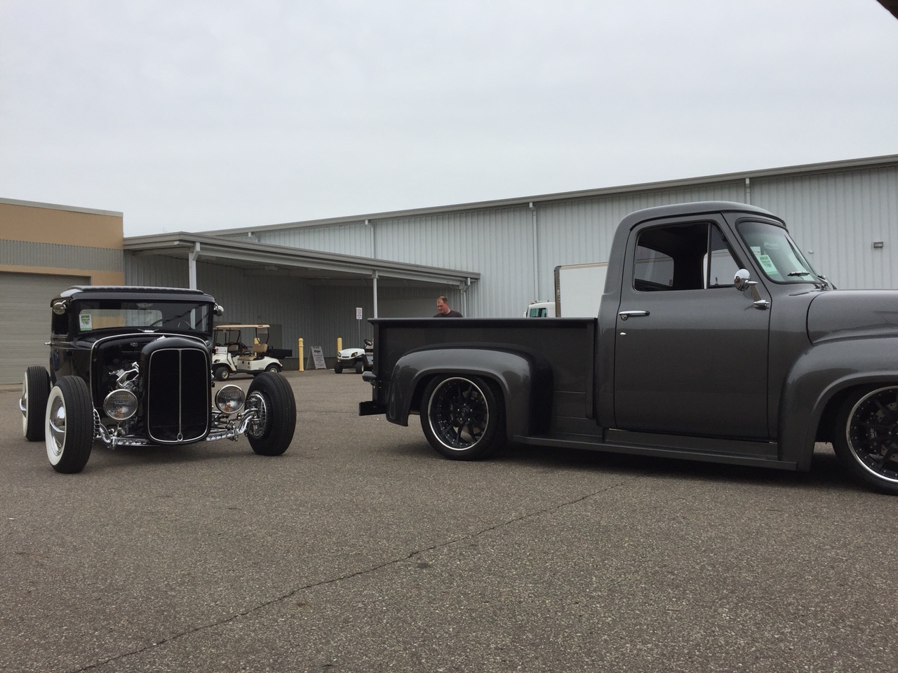

    Believe I saw this car at nats north in kzoo mi. Very nice paint kick ass overall even drooled a bit well done my man was next to a top shelf f-100 pickup

    Yes we were! Thanks. The f100 is my friends and yes it’s a awesome truck[​IMG]

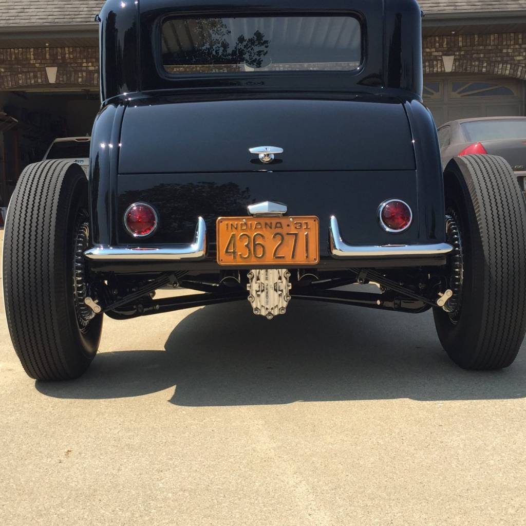

    That is beautiful. I love the idea of the truck rear window .

    Bumperettes? What are they? Very clean,well proportioned, classy looking killer!

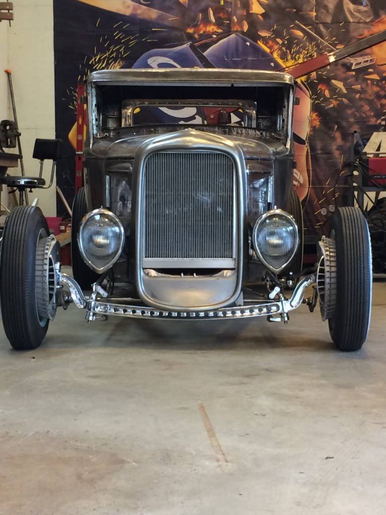

    & what are these headlights. Great work, one of my favorite Model A's on HAMB. tapatalk_1537236685243.jpeg tapatalk_1537236210981.jpeg

    The headlights are grafted together 37 ford and 36 Packard

    Yes we’re were there on Saturday only on the front side of the building

    Thanks, funny thing is I used it because I destroyed the model A rear window chopping it up for a custom chromed window frame. So after struggling to find another model a window I ran across the 37 ford pickup window and actually like the lower body lines better than the stock A. It matches the side windows perfectly. Funny how things sometimes work out

  27. Wow!I love all the out of the box things on this car,right down to the thought put into the exhaust tips.Am I right that you flattened the firewall also?
    Congrats on doing things differently.

    Thanks and good eye, most guys don't catch that I took the kick out of the firewall, the fire wall was also pie cut on the 2 out sides to spread it wider to drop over the edge of the frame to work with the 1" channel.
    I cut the exhaust tips for a couple of reasons first it allows better view of the quick change and second it makes the 2.5 exhaust look smaller which would have been more the norm in the 50's
