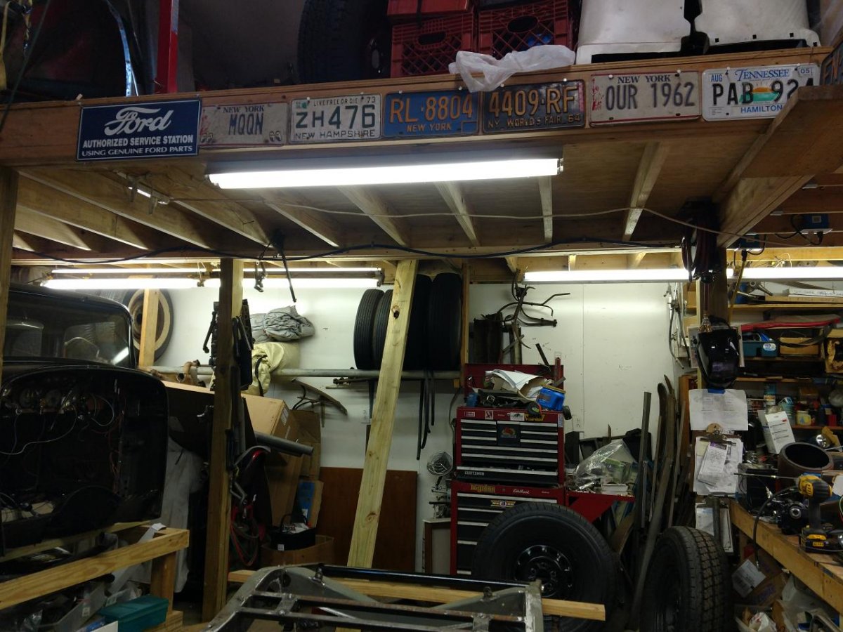

  2. Today I started on a rotisserie idea I have. In the back of the garage is a mezzanine that I can use for a vertical support for the back end of the frame ....
    I will anchor the 2x6 to the underside of the mezzanine and wedge it to the floor. I am using two heads from engine stands - one will be mounted in the wood, the other to it's own engine stand. I cut two plates and from some scrap and drilled and bolted them to the engine stand heads giving me a welding surface. I will weld some 1x2 tubing to it for the crosspieces ...
    The first head will be used in the wood - the multiple holes will hold the frame steady there, the second in it's own stand. Presently the idea is to level the engine stand so everything rotates nicely.
    With this done I removed the FE from under the car ...
    ... and began to move the rear forward. I installed shorter tires and got it about 1/2 way out when I realized it would be easier to remove the tires and use a dolly instead as it was too tall as it was with my limited resources ....
    Once I have the suspension out from under the frame I can use my engine hoist to pick up the frame for ease of mounting it in the rotisserie. Damned if I know if this is going to work - I think as long as the two ends are level, it should rotate freely. It's an idea I just had to try .... what the hell, right?!
  3. Day 2 on the frame rotisserie - got my 2x6 into position ....
    It's just wedged in there for the time being. I also got the rear out from under the frame - nothing fell and nothing broke too!
    I then spread the front two frame horns to git my front spreader bar using a pump Jack - worked out pretty good. I wanted the front and rear frame horns to be in their right location and width in case I build another 32 or someone would like to borrow my setup.
    The front brackets were just scrap pieces I had lying around. I cut the rears, measured and drilled the holes, and got them in place
    After a bit of cleanup I should be able to finish it tomorrow. Then we will see if it all works as planned ....

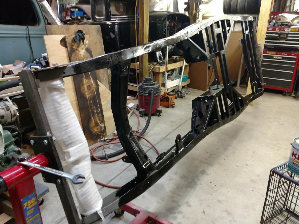

  4. Welded everything up today after making sure all was level. For want of a hole saw the size I need for the wood end, it would have been done ....
    rps20180325_163502-1.jpg rps20180325_163526-2.jpg rps20180325_163552-2.jpg rps20180325_163611-2.jpg
    That is just about the height it will be - about 35" off the floor. I will prop up the back end of the engine stand so the head is level and it will rotate smoothly. I should be working on the frame tomorrow .....

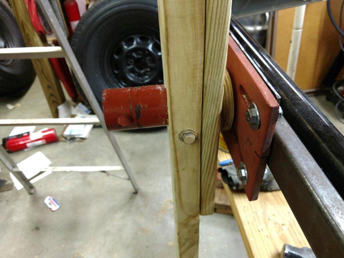

  7. It works! Got things mounted up on the back side. Needed something of a collar to keep the bolt heads away from the wood ....
    Drilled my hole ...
    ... and added a piece of 5 quarter decking to give it more depth. Had to sand out the hole a little bit so things weren't too tight, coated the inside of the hole and the shaft with white lithium grease and slipped it in ....
    I also drilled my horizontal hole and used a long bolt to grab the head holes and keep it somewhat steady ...
    After a quick pickup I tried it out ....
    Rotates nice with no effort but I will need a bigger pin than the bolt I am using. It's not as tight once in position because the bolt is too small and there's some play. After a cleanup I got to work and removed my pb handle, drilled the holes needed for my tranny mount, got to welding up and finish welding the bottom side, and ground those off. It's working great and I am happily back at work on the project .....

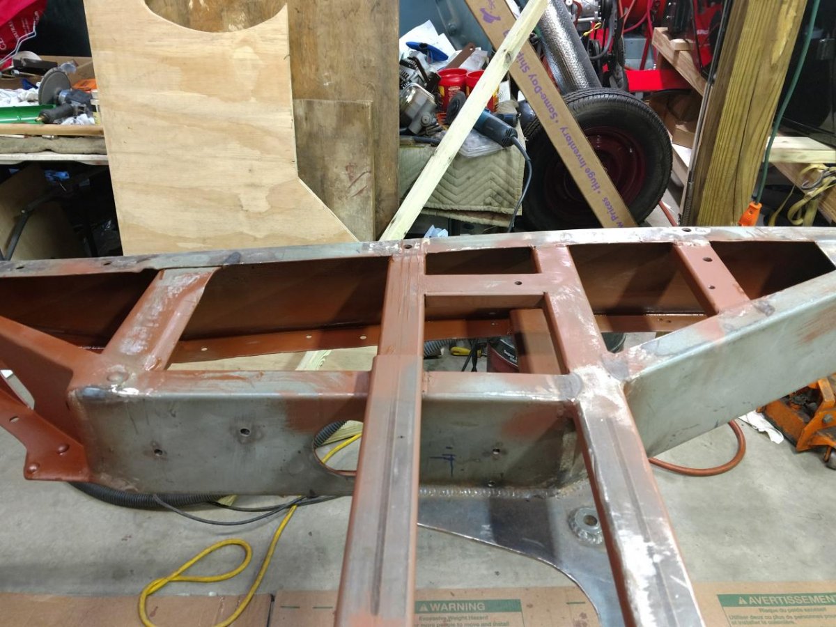

    At this point I have finished welding, been going over the frame taking off the rough edges, and have now started to fill the frames indentations due to the heating and welding of it getting it straight. I needed hardener for the Duraglas I am using, DA 40 grit sander disks to provide a profile for the KBS frame coating, and sine other items, all Carlisle finds. The plan for the frames finish is to make it look good but leaving all that makes this frame original: the slight putting, the remains of the many mods made to the frame, and basically keeping the " rough original nature" of the frame. If I had wanted "frame beautiful" I should have bought new rails and started that way. Since I wanted to stay with an original frane, I did not, so I am keeping it "as is" for the most part....
    I have been applying small amounts of filler at a time, using my cheese grater and 40 grit sandpaper to get things "smooth" since 40 grit is what I will use to create the profile.
    At this point I believe I have put the last coat if Duraglas on for this portion, pass front, of the frame.
    After a once over I will move to the driver side front.

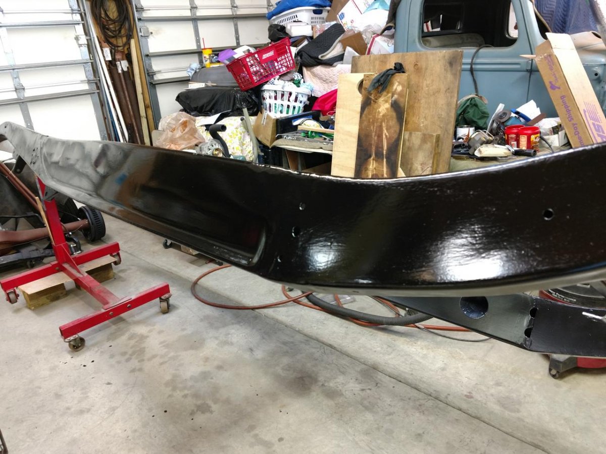

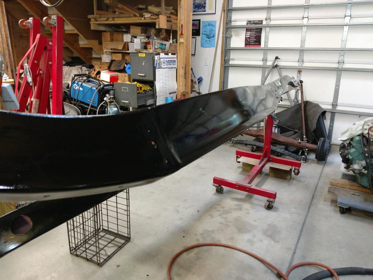

  18. Finished Duraglasing and got the frame painted. I started from the inside out, working on the areas I did not prime with Rust-Oleum ...
    I did a thin coat, watching for runs - this stuff loves to run so thin costs are a must. The frame rails came out pretty nice with just the first coat ...
    The KBS dried quickly and I applied a second thing coat which covered many more imperfections. Once the second coat was dry, I painted the primed ares with Rusto satin black ...
    Next up is to finish coat with Rusto in the primed areas and perhaps do a final coat of KBS on the sides of the frame rails and the entire front rails in front of the firewall after scuffing up of those areas.

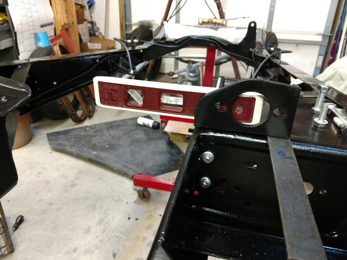

  21. Got the pedal setup in place and removed the t-out bearing carrier (looks like a 40 Ford unit but purchased it from Krylon who builds in the sleeve that slips right over the S10 tranny shaft) so I can shave off a 1/4".
    The blue tape is there to protect the frame and arm paint surface. Had a minor problem with the pedal setup. I purchased it off a HAMBr (el polaco I think?) and it's specifically for the 32. It's a two piece unit that sandwiches the K member leg between the pedal portion and the lower mc mount piece.
    Problem was that the mc mount plate was not level. I played with it a little bit, adding a 4th bolt to pull the one side down while shimming the other side ...
    You can't see the added bolt but the shim is there and marked for cutting tomorrow, and it is now level. I also need to get slightly longer grade 8 bolts to complete the sandwich 'en of the kids member leg between both parts. Once I finish this tomorrow I will mount the freshly painted mc. I am pumped being in the assembly stage .....

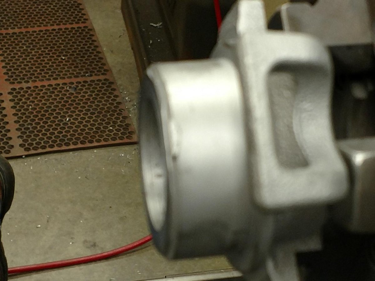

    I also needed to cut down the t-out bearing stock looking 40 Ford carrier to accommodate my t-out setup. I visited Havlir's House of Fab and he trimmed it down 1/4" for me in his lathe. First problem was where to grab it from. This carrier, sold by Krylon, has the sleeve already pressed into it if using a T5. Since the sleeve protruded about 3/32" on the back side, that was enough to grab it by....
    Dave carefully shaved off the .250 thou needed about 5 thou at a time ....
    Now is ready for reinstall ....
    Thanks, Dave - back in the garage tomorrow ....

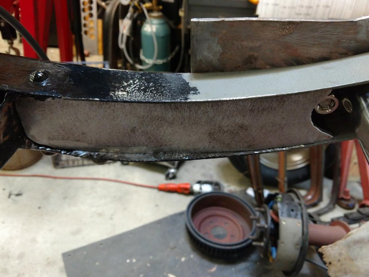

  26. Got the front frame horn boxing plates cut out and installed today.
    Had an issue with the rear backing plate bolts I resolved (never get the cheap ones - broke two, had to cut out another and that took 3 hours. Luckily I had four originals from a Bronco rear lying around) and I hope to assemble the tranny back together with the cut down carrier.
    The faint blue line is where the t-out bearing resided before when leaning up against the pressure plate when at rest. I will install it back on the motor tomorrow ....
