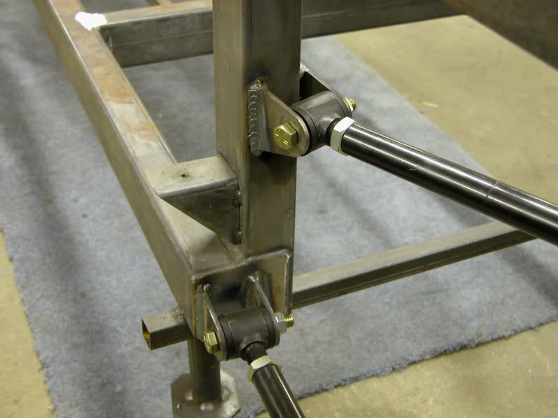

    Here are some pics of a 29 RPU that Im building. Built frame on my jig,its 2x3 .120 with a stock rear crossmember and B-ville front crossmember and horns. Its got a 260 with a c4 trans with trips.

    Wow that looks cool, I'm unsure about that rear kickup being strong/safe though??
    I'm don't really like the frame sticking out of the top of the bed, you could have just made the frame straight back and mounted the axle on top of the frame. just my .02.....

  6. Don't like to rag on another mans build---but---that rear kick-up is uglier than original sin!!! Why did you make it so high. It looks like you made it that high to suit a set of coil overs that you already had laying around the shop. Now the guy won't be able to use his bed for anything, and you've got that big assed original crossmember stuck up almost above the top of the bed???? You only need a maximum of 4" clearance between the top of the rear axle tube and the underside of the frame member under fully loaded condition (weight of body and engine in chassis).

  8. I have to agree with Brian, the fab work looks like it's good quality, but the rear kickup is un-necessarily tall. You could probably trade those coil-overs for a nice rear leaf.

    Great looking engineering, nice welding too. I'm planning to use that type of triangulated four bar on my next build, wasn't sure how 'angled' I'd have to go to keep things are in place. Looks like I don't need to go too radical though.
    I must echo the other guys, the rear crossmember looks a bit out of place. Lose a couple of inches on the height of the top frame and use flat box for the crossmember and shorter coilovers and it'll be an excellent build.

    UGLY??? Beauty is in the eye of the beholder...AKA the guy who pays the tab. I also know the customer, and he requested that the cross member be high enough to hang a stop light. WAIT and SEE. Give Dave time he can make anything look cool!
