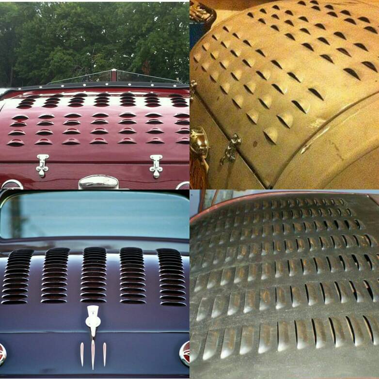

  2. I am liking the old school hand cut ones the best....Everyone has the press style and ya just don't see the hand cut ones that much so that sets it apart from all the others.....COOL BEANS right there.

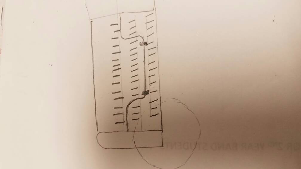

    I want to make a full bare aluminum hood for this one and I've been going back and forth with some ideas. I would like to try to do something a little out of the ordinary with this as everything has been done so many times before. Thinking I might do a 3-piece hood with a larger top section that extends down into smaller side pieces. When I louver everything I'll have the rows tie in one panel to the other. I did a quick sketch I'm no Picasso. Haha 1481127999318.jpg

    There have been many of these done, the problem is some look like the guy just didn't want to pay the "professional" price and the end result showed. I'm sure this is not the case here because I've seen your work.
    One problem I've seen is the way the line of the formed body contour is thrown off by the lower seperation point of the hood sides. This may not be an issue for you, but I just can't warm up to the look.
    This channeled car has what (I think) you are proposing. It was built about 1947 by Malcolm Schutt.
    AHotRod likes this.

    I agree DDDENNY. Disrupting the flow of the body reveal line into the hood is so so. I'm not 100% what I'm doing yet..but things have to flow and look right

    Going with hand cut louvers that I do. I was hesitant at first because this style is a lot more work intensive. I have plans for a full louvered hood as well and maybe my decklid. I'm going to have tons of time in these on the whole car but what the hell.
    The way I do these is I first establish a center line for each row. I usually like to do 7 rows on a trunk lid and figured 7 would look pretty good on this roof insert. After I have the seven rows layed out I then draw a 1.5inch spaced line on each side of my center line. This gives me a 3 inch wide space to drawl my cut line for each louver.
    Each louver has to be cut one at a time with a die grinder and cut off wheel. Then each cut is lowered into my fixture and then hit with a small sledge...one at a time. After, each one requires some tweaking to make sure they are hit through at the same height. It's a process!
    Tonight I just took my time and got the layout set up. This step alone took a couple hours. Tomorrow I'll start cutting the lines and then smacking them.
    It's a very long tedious process but in the end it looks pretty cool. 1481685885052.jpg 1481685890128.jpg 1481685894174.jpg
