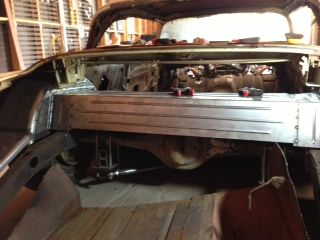

    What are you doing with a firewall? Are you gona remove all the vents out (new panel) or just patch all the holes?
  4. jakdupkustoms
    Joined: Jan 17, 2006
    Posts: 227
    jakdupkustoms
    Im gonna french some drain tubes inside the car and then put a new piece over the whole thing. Ill probably be doing that next week. Ill post pics up of what I do
    I did a three inch channel (body drop) thats why its all cut out right now.

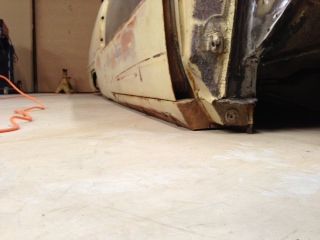

    Yes it is half doored. Didnt like the way the rockers rolled under couldnt tell it was laying. If im gonna do the work to cut the whole damn floor out I want it to look floored. Kinda want to do rocker like a 54 chev.

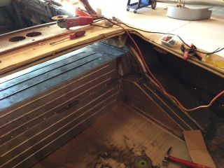

    Trunk almost finished.
    Not a whole hell of allot of room under there.

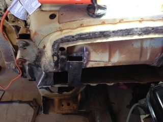

    1x2 drain frenched into pocket for drainage then I will sheet whole firewall.

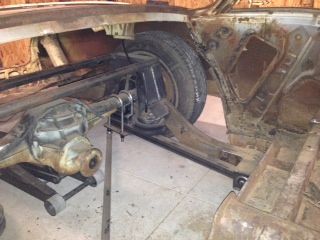

    what are u doing for steering? will the headers get in the? . Also if u get rid the the floor pan , i dont mind taking it for mine. :D

    If you cut your rocker off you lay your door on the ground its called Doored.
    Not necessarily a mini trucker term. I cant cut my rocker completely off hence the term half doored. I think we just made that up.
    Headers and steering no problem. Just raised the floor pan still using it.
