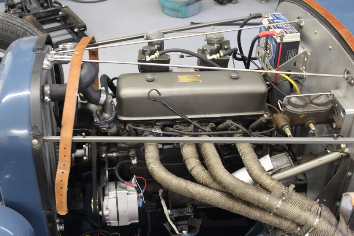

    Not sure we're talking about the same engine. "Iron Duke" has been used to describe both the '60s 4 cylinder used in Chevy IIs, etc., and the 151 used in the '70s -'90s in everything from Monzas to Fieros to S10s. I used the later engine, out of a '92 S10 in my lakes modified, with companion T5. Works great in this light car. I had the cam reground to make it a little more interesting, tigged a couple of flanges on the intake to mount twin Carter YFs, had my brother fab an exhaust, and topped it off with a sectioned Chev 235 valve cover to make it look like a Model B Ford overhead conversion. Photos attached.

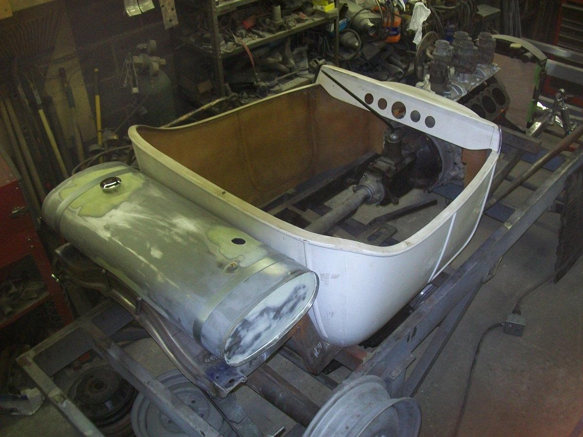

    I need to throw a build thread up here. There is some really neat stuff on this car. Definitely not your run of the mill T bucket. It's way further along than the pic. shows.

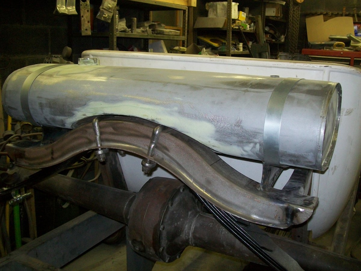

    Greetings fellow HAMBer!, what kind of fuel tank ( original application) are you using?...I'm wanting to build a modified and your tank ( Koz appears to be using the same one as well) is perfect!

    The tank on mine is a "Tanks Inc" 1934 Dodge Coupe or Sedan tank that I flipped over and relocated the filler an sender inlets to the top of the tank. I then made two new end caps to replace the ones from Tanks to eliminate the big x's in the ends. Just to make sure it didn't leak I sweated the original seam that is now under. I also added the notch to the rear to clear my crossmember. If I calculated correctly, (should have payed attention in math class instead of daydreaming about hot rods), I should still have about 14 gallons in there. In hindsight, for the effort I should have probably just rolled the shell as well. I will say that the Tanks product is of excellent quality and easy to make work on something like this. 003.JPG 003.JPG 005.JPG 003.JPG 005.JPG 003.JPG 005.JPG 005.JPG
