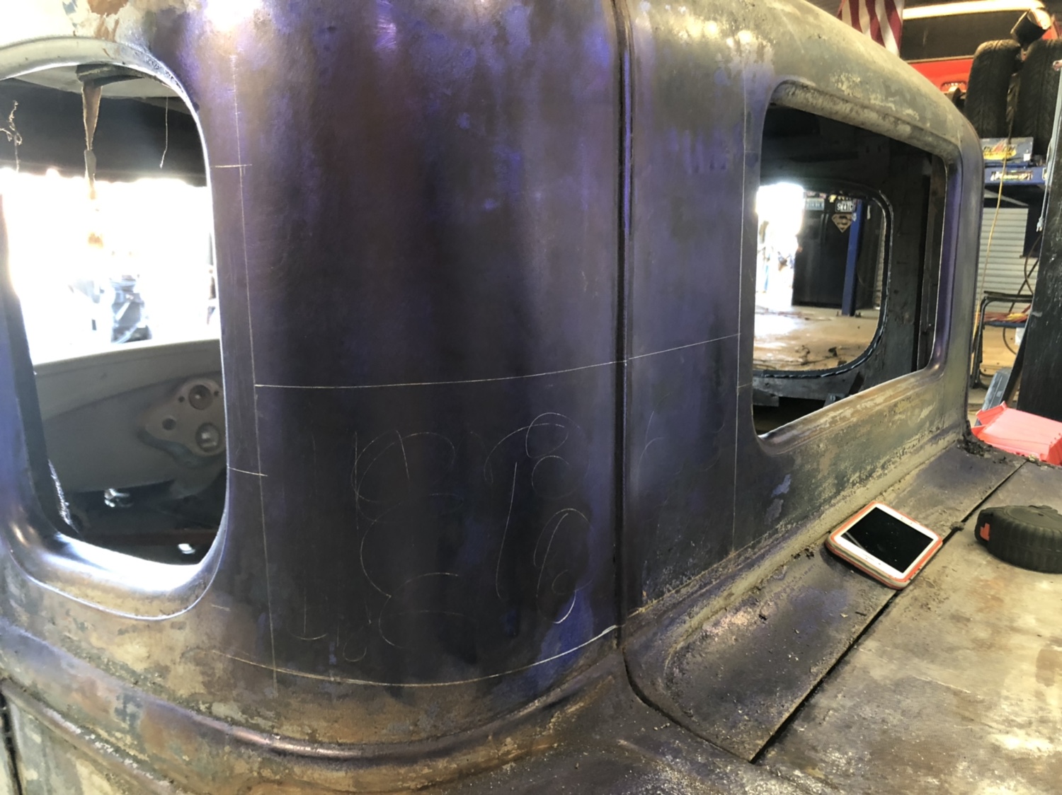

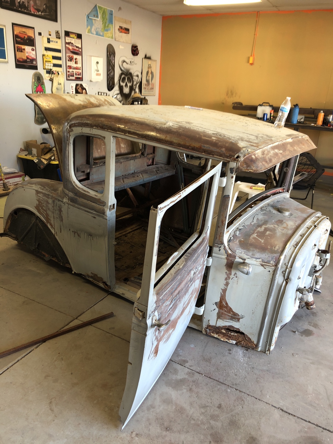

    I inherited this car a few years ago and I finally sold all my stupid cars so I would be forced to focus on this one. I don’t really know how posts go as I’m new to forums but here it goes. The car was almost complete other than a few pretty serious cancer spots but I immediately pulled the body off the frame and sold the fenders and and all. I acquired a speedway T-bucket frame that I was going to extend and make work but I decided to keep the frame itself for a future project and continue to use the hairpins and 9 inch but buy some deuce rails. Other than that I haven’t done a whole hell of a lot yet aside from a buddy and I welded in structure braces the other night and chopped it 6.5” I’ll be posting pictures as I go on from here. [​IMG][​IMG][​IMG][​IMG][​IMG]

    Looks like you have a plan and evolving from the ground up. Should be killer. Cool pic of mascot.

    I hope you aren't much more than 5ft tall! That's a wild chop

    1. Y-blocks
    Good chop for a drag race at the track only race car,not good for a street driver,hope you kept the chopped out parts. At the point you deside too sell it or fix it,they will be real handy. Your workmenship looks good.

    Gonna set the body on top of deuce rails and sink the floor down in between them for driver and passenger buckets. I’m only 5’9”

    Thank you! Cars staying with me forever and I’ll be doing some cowl modifications to give myself more windshield

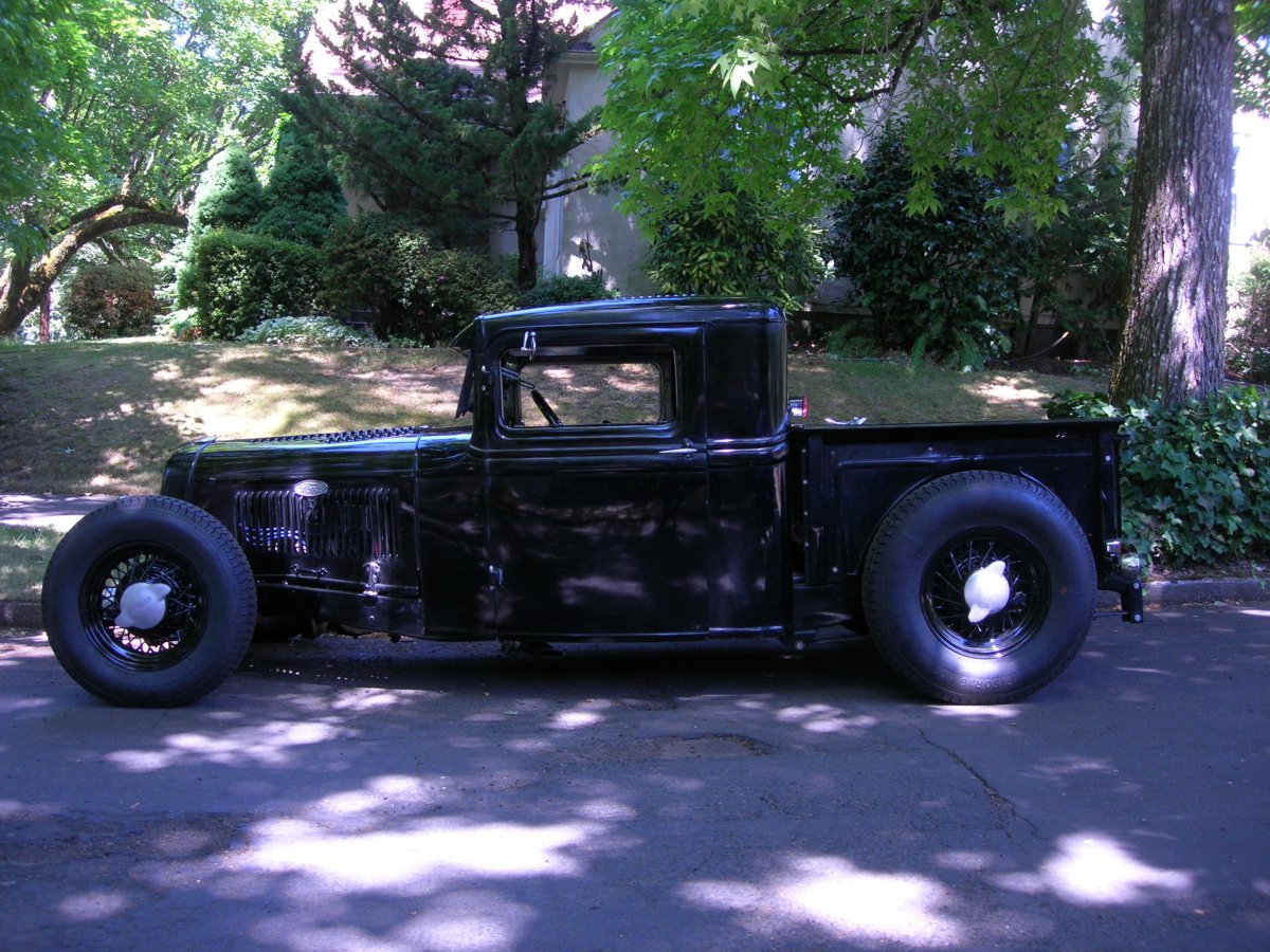

    You have a good eye for how much to chop a 31 coupe. Perfect! Please do not alter or modify the cowl or the visor. You would kill that classic chopped 31 look. I chopped my 34 Ford P/U six inches and I channeled the body six inches over the frame. I am 6' 4" tall and I only fit in the cab because I added five inches in behind the B pillar. If you mount your seat at a laid back angle you should be able to see out perfectly. In my cab I have about 4 or 5 inches of head room. Yes, my knees are bent quite a bit in order to drive in comfort. I have trained myself to depend on my cowl mounted prism to easily keep an eye on stop lights when I am sitting right in front of them. DSCN3747.JPG Never let a stop light slip out of your field of view before you notice it. My rod is very comfortable on long road trips. You will get some bump steer using cowl steering if your steering link is a different length than your split wishbone. Both must swing through identical arcs to avoid bump steer.
