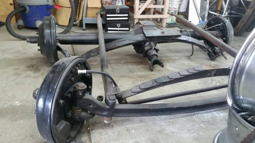

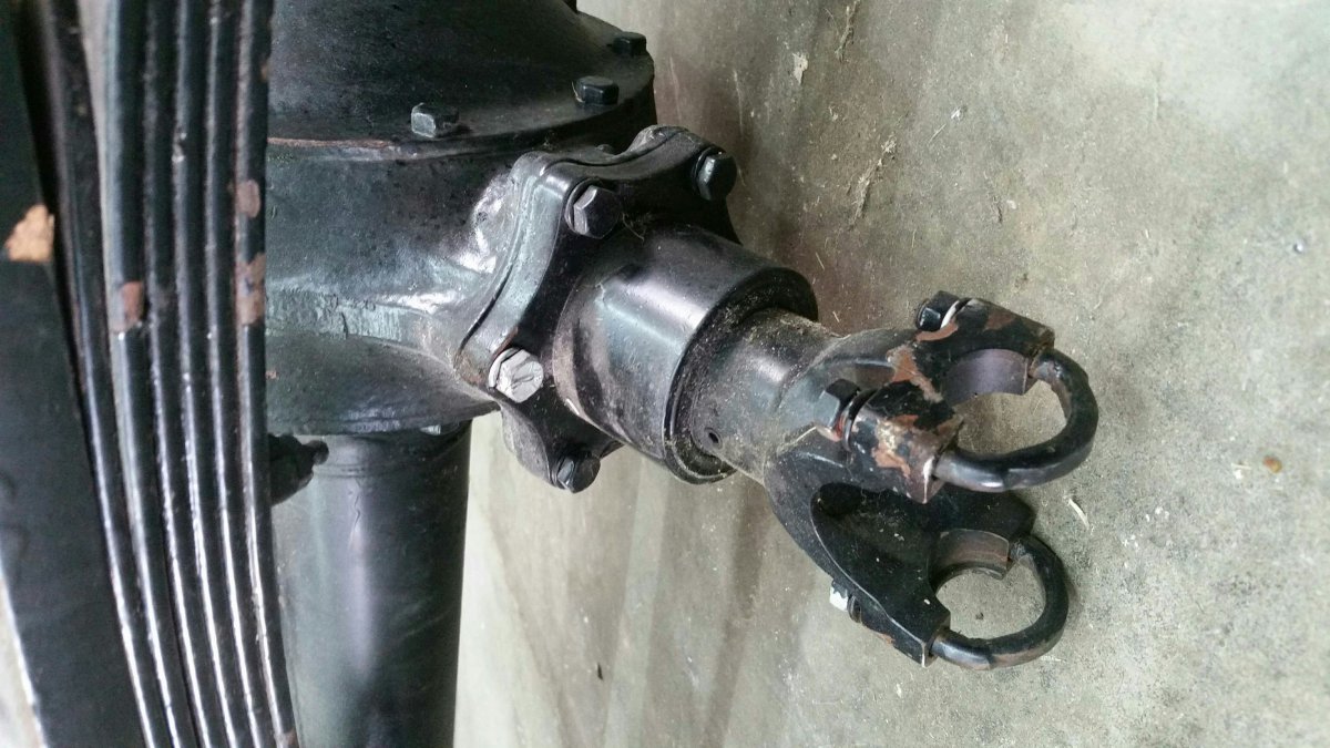

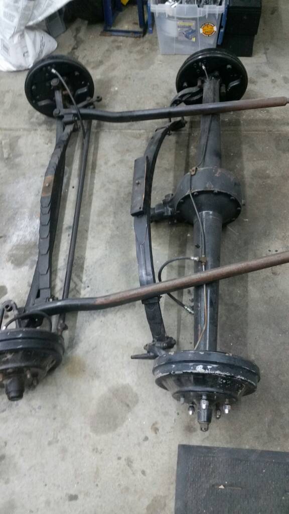

  2. It came with a 48 front axle, and the rear may have been converted to open shaft.
    Any way to confirm that?

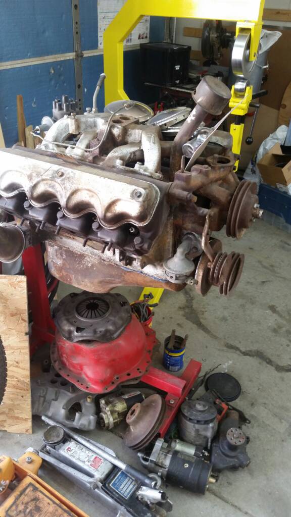

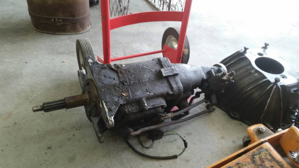

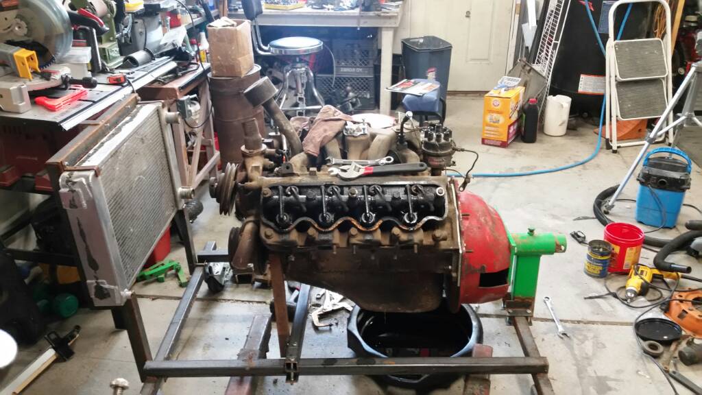

    I've got this 301 Poly I rescued, and an adapter scattershield I got from @RichFox which will be followed up with a M21 dad had in his 65 Chevelle 20180511_151350.jpg 20180508_215730.jpg 1526074895363.jpg 20180511_151519.jpg 20180511_151526.jpg 20170429_154612.jpg

    Full Kustom drunk mobile posting

    Just checking to see that you have the ring gear on the proper side after that 180% turn of things, and there may be a wheel cylinder left & right deal too. :) Bob

  14. Thanks for looking out for me @The37Kid, I'm a newb to pre-war parts and I appreciate it
    I'll tear it down someday and verify all that.

    That is an open drive conversion on a closed drive rear that's had its bells reversed. That stud on the one side is for the panhard bar.

    The brake backplates, wheel cylinder and brake shoe arrangement all look good to my eye.

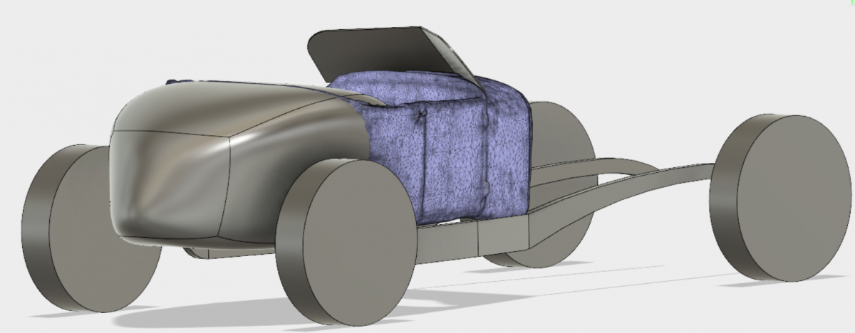

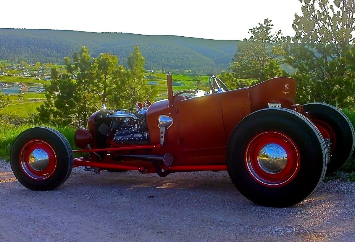

  22. FDF concept 1.png Just got back from taking my wife camping. I snuck the laptop with me and we had a few rainy days, so I continued designing.;) Just trying to get a feel for all my ideas piled together
  23. VonKool13
    Joined: Feb 16, 2008
    Posts: 1,039
    VonKool13
    That would be pretty tits with the boat tail!

    Both image renderings are very nice.In hot rod red would be the cats meow.
  28. I do like the more pokie shape you've modeled @madfish
    But that would be harder to form
