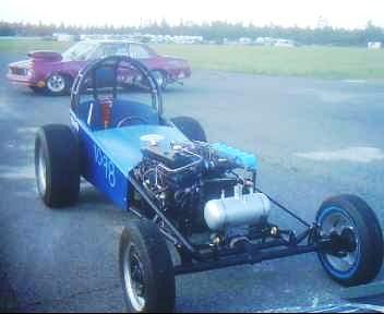

  8. 413 is a low RPM motor 6000 to 6100 will et best .
    length of runners from the intake valve to the plenum floor rule of thumb is 90 divided RPM in thousands (IE 6000 =6 , 5000 = 5 tec) .
    Ribs are actually to stop puddling . (so the puddles of accumulated fuel which happens now and then unfortunately don't run down the nearest port smothering that cylinder. )
    Best rule of thumb for runner size is it should be about the same size as the intake valve. I have build a few . Good results. I wouldnt hesitate to build another one. Biggest deal is dont get in a rush and remember the whole thing will shrink when it is all welded so allow a bit extra length to allow for that. Weld only a small amount at a time. Maybe tiny amount is a better way to say it. Dont get in a rush.
    Don
    Here is the last one I did on my Sr Dragster. There is another on my website on a BB Dodge
